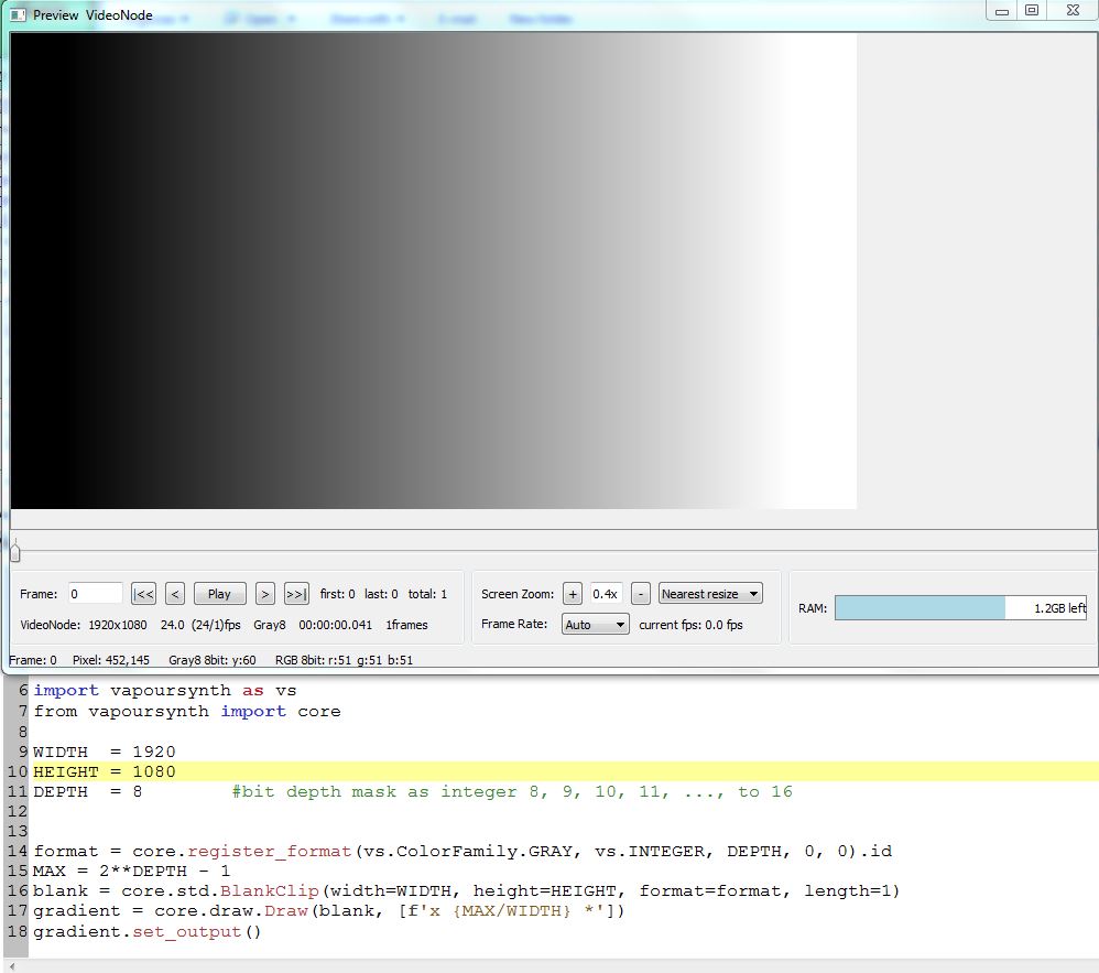

  18. I said I do not know any functions for gradients in Vapoursynth, but found something, relatively new: core.draw.Draw(), sort of same as mt_lutspa for Avisynth.
    It can create black&white gradients, any bitdepth 8bit to 16bit integer masks (not float), for example our simple gradient from black(left) to white(to right):
    import vapoursynth as vs
    from vapoursynth import core
    WIDTH  = 1920
    HEIGHT = 1080
    DEPTH  = 8        #bit depth mask as integer 8, 9, 10, 11, ..., to 16
    format = core.register_format(vs.ColorFamily.GRAY, vs.INTEGER, DEPTH, 0, 0).id
    MAX = 2**DEPTH - 1
    blank = core.std.BlankClip(width=WIDTH, height=HEIGHT, format=format, length=1)
    gradient = core.draw.Draw(blank, [f'x {MAX/WIDTH} *'])
    gradient.set_output()
  19. gradient from above script:
