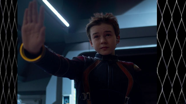

I had some time to kill so here's another version.
SideImages(Video, OutWidth, LeftImage, RightImage, Flip, Stretch=false, BlankFrame=false, Offset=1.0)
It's pretty much the same as before, except when BlankFrame=true and borders are being added, one additional frame is added to the end of the video. That frame is completely blank, without the images for borders.
Offset can be used to move the picture off centre. The default is 1.0 and the range is from zero to 2.0.
Offset values less than 1.0 decrease the size of the left border and increase the right border. Values greater than 1.0 decrease the size of the right border. The border should be totally on the left when Offset=2.0 and totally on the right when Offset=0. It's not really linear but it's at least a way to adjust the relative size of the borders.
The attached screenshot is Offset=0.75.
Flip works much the same way, flipping the left image to the right if no right image is specified, unless Offset=0, in which case if you only specify a left image it'll appear without being flipped on the right. You can still over-ride the defaults with Flip=true/false.
This version doesn't use the first frame of the video for the border image when no LeftImage is specified. That seemed pointless as you can always specify that for LeftImage yourself if you want to, so instead it adds plain black borders until border image(s) are specified.
Hopefully I didn't introduce any gremlins.

Here's a new function of you want to give it a test drive. It works much the same way as FrostyBorders. The argument names for the images are now Image1 and Image2.
If you need to crop, you'll either have to use the crop function first, or if you need to specify an InDAR and cropping will change it, crop and resize with CropResize first as before. If you don't need to crop, ImageBorders can be used on it's own.
ImageBorders(Video, OutWidth, OutHeight, Image1, Image2, Matrix1, Matrix2, \
InDAR, InSAR, Mod, Flip, Stretch, BlankFrame, Offset, Resizer, IResizer)
There's no longer any need to make sure the color formats or bit depths match, the only thing you need to check yourself is when images need to be converted to YV12 etc, their width and height are the correct mod (ie mod2), otherwise you'll get an error. I'll probably add a check for that later and automatically crop a pixel for mod2 if need be. I'm bored of looking at it at the moment.
Mod determines the width mod of the video when borders are added to the sides, or the video height when borders are added top and bottom. The default is Mod=4.
Matrix1/Matrix2 lets you specify the matrix when the border images need to be converted from/to RGB. The default is matrix="rec601", the same as for the Avisynth Convert functions.
If Matrix2 is unspecified, Matrix1 is used.
Resizer specifies the resizer for the video. The default is "Spline36".
IResizer can be used to specify a resizer for the border images, independent of the video resizing (assuming they need to be resized). If IResizer is unspecified it defaults to the same as Resizer.
See post #101 for an updated/fixed version.
BorderImage = ImageSource("Border.bmp")
Screenshot 1
ImageBorders(720,540, BorderImage, Offset=0.75)
Screenshot 2
ImageBorders(720,400, BorderImage, Offset=0.75)Last edited by hello_hello; 13th Mar 2020 at 13:57.
