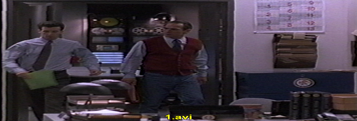

    Aramkolt's 4 files compared...
    Ignore frame sizing, colour space (VDub wouldn't let me convert to 709) and of course, no deinterlacing.

    Being in a rush so no time for a deeper analysis, maybe in the next days.
    Image should be checked at field level, being a patterned ntsc field architecture.
    No improvement in capture 2.avi compared to 1.avi at "line" correction.

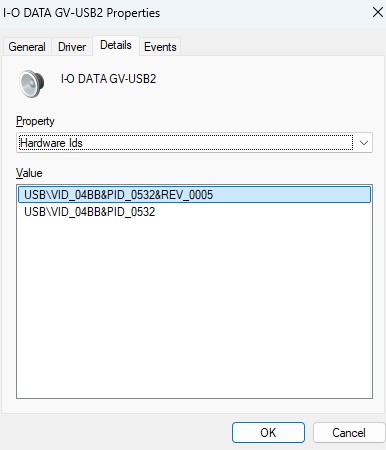

    Can you post the Hardware ID of the four units to see if there is any difference?
    The one I bought with Windows 10 on the box and a CD has this hardware ID:
    USB\VID_04BB&PID_0532&REV_0005
    For anyone else who wishes to share the Hardware ID info of their GVUSB2, here is how to find it:
    1. On Windows computer, open Device Manager
    2. Look in section Sound Video and Game Controllers
    3. Right-click I-O Data GVUSB2
    4. Click Properties
    5. Click Details tab
    6. In Property menu, select Hardware Ids
    [Attachment 92078 - Click to enlarge]

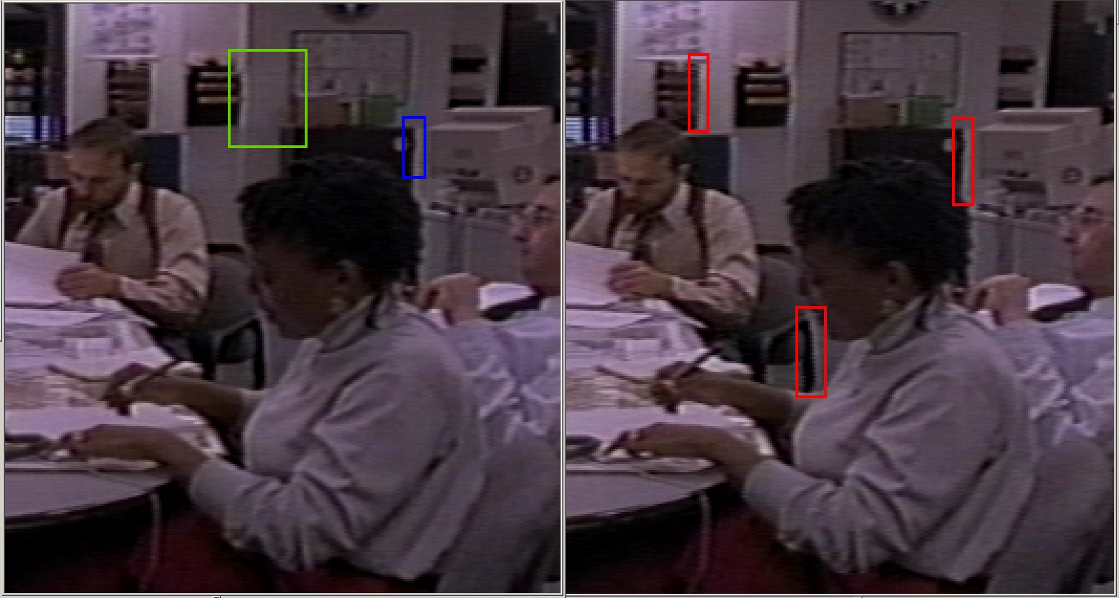

    Refer to screencap 1. Comments below image.
    Left is #3, right is #4 (and effectively 1,2 too)
    The red boxes showing where timing issues are. In motion, these are obvious. In stills. the giveaway is interlacing motion. The wall inbox, the shelf, and the chair arm are all moving, as if an amoeba has invaded your TV.
    The blue box shows how the unnatural bump is still present on a flat wood shelf. That's a static wiggle. It wasn't corrected with a TBC, just frozen for several frames, distorting geometry.
    The green box shows a smearing issue in the luma, extreme ghosting to the right.That's actually less defined in the #4 clip. The interlace wiggle in #4 is a comp showing that the #3 curve of the box is not natural.

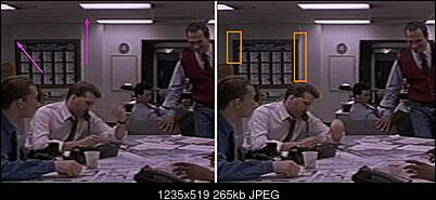

    Moving on to screencap 2:
    The pink arrows show "straighter" geometry, but it's still distorted. The left arrow has a a weird curve outwards from the wood corner, and the right has a weird zigzag jump where the wall seems to bow out above the display board. Again, this is not natural.
    The orange boxes show how the timing wiggle changes frame to frame. The left box shows a semi-normal corner, and the right shows how that zig-zaggy jump is actually a timing curve that shows the display aligned with the wall edge.

    1 3 and 4 are all identical. Wiggling lines are present in all three of them.
    The outlier is number 2.
    Edit - Was judging the edges, number 2 is suspiciously cropped enough to where I can't easily deduce if it still has wiggling or not.
    Did you mix up 2 and 3?
    I don't think I did. I tried to be very scientific and meticulous here.
    BTW, the key here is to ignore the overscan area noises. That can lead you astray. Focus on the in-image.

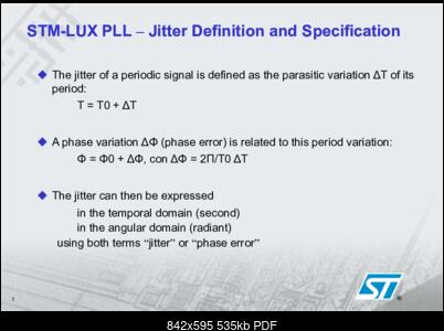

    I really do not understand where this PLL non sense has started. PLL provides a stable clock (generally starting from a low frequecy very accurate reference, i.e. a quartz). Its ky eparameter inside IC usage is the istantaneus jitter and the long term kitter, also know as phase noise. Nothing about that is related to a time base correction (except that this last needs a stable or regenerated clock).
    I personally designed several PLLs based on the classic charge pump-vco-phase shift-filter. Attached an example of mine (pdf attached): Click image for larger version
    No time to check but considering interlaced frames is wrong. The video is captured at field level and the timing errors (and any TB correction, not present here) are inside the field at first. The red boxes show nothing.
    Also remember that we are talking about analog capture so any outcome is different, even the halos.
    Correct. It is not natural because there in time base correction, wisible in the vertical straight lines.
    On a fixed image the orange boxes shows nothing, post an animated gid with 3/4 consecutives frames (or better, fields) to show the wiggle (although not really necessary as experiment).
    I'm sure somebody will come along and make excuses for the card. Perhaps saying the issues "aren't bad". Again, refer to the test tape comments. Mass-produced retail tapes are some of the worst sample tapes. Reproducing this test on most homemade tapes will show more weakness.
    And again, geometrical distortions become obvious at normal views sizes, not in tiny preview windows on a computer screen (or tablet, or phone).

    Especially if it only happens in newer revisions, then that'd lead to a huge gamble.
