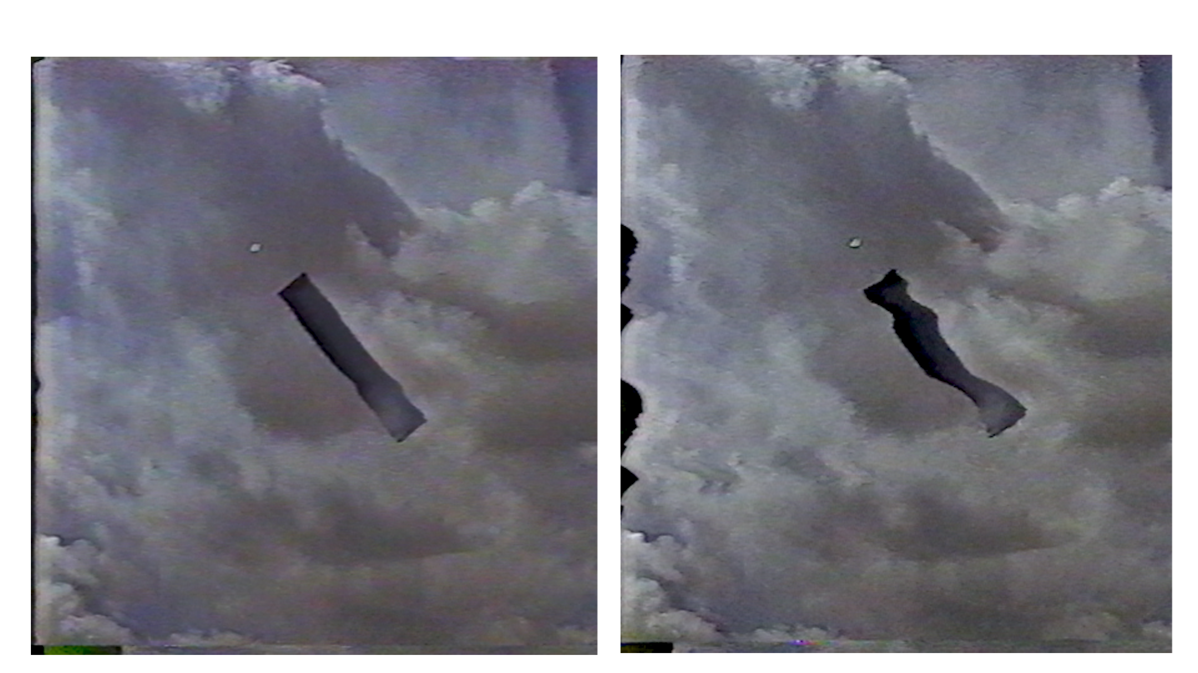

  1. I'm currently testing my I-O Data GV-USB2 (hardware ID USB\VID_04BB&PID_0532&REV_0005) to see how it handles flagging and horizontal jitter (waviness) compared to my ATI TV Wonder 600 USB. As part of this, I'm also running a comparison on dropped, duplicated, and inserted frames over a continuous 6-hour tape capture. I'm planning a comparison video between the two devices at @VideoCaptureGuide on YouTube.
    Waviness test
    For the waviness test, I’m using my most problematic tape: a 40-year-old VHS recorded in SLP mode. I digitized the tape using the following workflows:
    Workflow A: Panasonic PV-VS4821-K (S-VHS VCR) -> S-Video -> GV-USB2 -> USB -> Windows 7 with AmarecTV -> HuffYUV
    Workflow B: Panasonic PV-VS4821-K (S-VHS VCR) -> S-Video -> ATI 600 USB -> USB -> Windows 7 with AmarecTV -> HuffYUV
    The Panasonic VCR does not have a built-in line TBC, so both capture devices are facing a difficult challenge.
    Based on the attached sample clips, the GV-USB2 seems to be doing a noticeably better job maintaining geometry with this difficult tape than the ATI 600. While it is an improvement, the raw output is still unacceptable. Taming the timing errors in this capture will ultimately require adding a passthrough device like the Panasonic DMR-ES15.
    I have two questions for the VideoHelp community:
    1. Is there any software tool, Avisynth/VapourSynth plugin, or established metric that can quantitatively measure the level of waviness/jitter over the course of the video? I regularly use Python for log and video analysis, but I'm looking for a reliable way to measure horizontal line variance to be as scientific as possible in this comparison.
    2. Apart from handling timing errors and frame drops/inserts, what other specific metrics or visual comparisons would you recommend to properly evaluate these two devices against each other?
    [Attachment 91927 - Click to enlarge]
    Tearing (flagging) will vary widely based on the tape itself, and to the playback VCR. Each tape, each VCR, each capture card, will create a unique combination that gives different results.
    This test really doesn't say anything about the capture cards, and everything about the failures of pre-tape workflows. The condition of the tape, strength of even lack of TBCs, the quality of the VCR.
    Such a test is mostly misleading.
    All it concludes is that some form of TBC is required, to not have bad quality. Some will be less bad at times, but with another tape/VCR be worse. But it's like comparing cat poo to dog poop. Both are still poop.

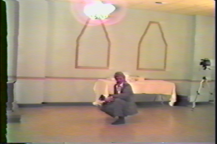

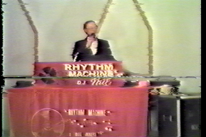

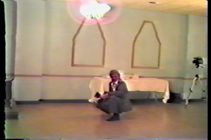

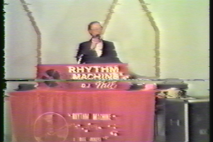

    Well in my own test using a Pinnacle 510 and IO-Data to compare if one handles time base wiggles more than the other, I can conclude that they are indentical.
    This was with the worst tape I have signal wise (perfectly fine condition wise, no mold, not sticky). The tape is a VHS copy of a camcorder shot wedding from 1987.
    This tape has terrible issues when played in my JVC units (VS30U or MV45U) with it's internal TBC enabled. So I'd either have to A. Capture it with an ES15 in it's place or B. Capture it with a Panasonic AG-1980, which does not have the same errors present here.
    I've done other camcorder shot tapes from the same time period, and probably filmed on the same camera. Those tapes, being first gen "straight from the camera" tapes, do not have such issues.
    [Attachment 91935 - Click to enlarge]
    [Attachment 91931 - Click to enlarge]
    [Attachment 91932 - Click to enlarge]
    [Attachment 91933 - Click to enlarge]
    Please ignore the difference in colors, that isn't my point here. The Pinnacle's colors are also not like that by default, I've manually adjusted the proc amp by +10 brightness and -18 contrast to prevent crushed blacks and clipped whites. Also ignore the Pinnacle was captured using composite, wanted to do a dual capture.
