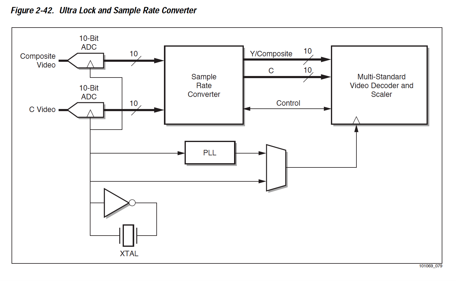

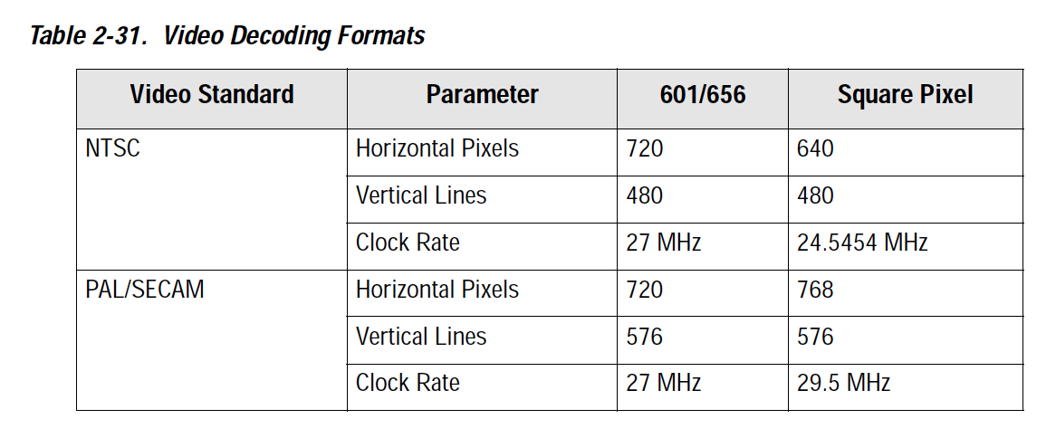

    It seems to me that the information provided in this excerpt from 2002 Conexant datasheet as well as the excerpt below throws the idea of "native" 720 samples per line out of the window.
    Video Sample Rate Converter - Flexible Video Timing Formats
    In the CX2388x, the Ultralock circuit has been enhanced by a Video Sample Rate Converter. This capability is required for applications such as video editing/authoring and time shifting that require decoded video to be sent out of the CX2388x for compression and simultaneous direct connection to a digital video encoder such as the Bt865A or Bt860/861.
    In combination with Ultralock implemented in the Video Decoder, the Sample Rate Converter allows a choice of video sampling rates and video decoding rates. This flexibility means that video can be captured at the highest possible sampling rate, using Ultralock, to acquire the maximum number of samples at the 10-bit Analog to Digital Converter(s).
    If decoded video is required on the CX23880’s output pixel port for connection of hardware MPEG compressors, TV encoders or hardware video deinterlacers, the Sample Rate Converter can be enabled to provide digital video with the following attributes:
    • A valid video data sample present with each output clock
    • Produces the same number of output clocks per line
    • Generates consistent sample point locations from line-to-line.
    These attributes are mandatory for interfacing to the aforementioned devices. Figure 2-42 provides a top level overview of the Sample Rate Converter and Video Decoder.
    From Figure 2-42 it can be seen that there is a clock domain for the analog to digital converters and another domain for the Multistandard Video Decoder and Scaler. Typically an 8x Fsc (video subcarrier frequency) crystal is used to provide a sampling clock for the video Analog to Digital Converters in order to obtain more samples per line than is required (see Ultralock Overview) for square pixel or 4:3 aspect ratio decoding.
    If no external video processing is required, the Sample Rate Converter can be bypassed and the video decoder clocked at the same frequency as the Analog to Digital Converters. The decoded video samples are DMAd to the PCI bus and the graphics overlay surface in the same fashion as the previous generation Fusion 878A decoder.
    If external video processing is required, then the Sample Rate Conversion register should be programmed for the desired frequency of video decode. This is typically 27MHz for ITU-R. BT656 decoding, although other formats such as square pixel NTSC (24.5454/12.2727 MHz) or PAL (29.5/14.75 MHz) may be supported. See Table 2-31.
    In order to use the Sample Rate Converter the ratio between the ADC sampling frequency (typically 8x Fsc) and the desired Video decoder core frequency (typically 24.54, 27.0 or 29.5MHz) must be derived, multiplied by 2¹⁷ and then converted to binary or hexadecimal.

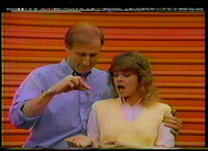

    Here is how a NTSC frame looks like on tape with the scan lines already being sampled at 720, This is not the entire width of the frame recorded on tape, horizontal chroma and luma timing signals are excluded, If you want to see the entire frame look at VHS-decode project samples:

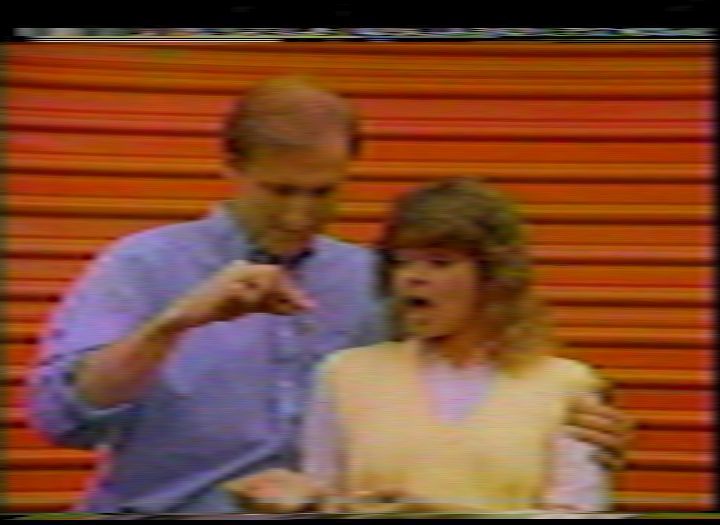

  8. One can approximately simulate, by horizontal down-upscaling, what would happen to this picture with prefiltering and sampling at a lower sampling rate (=fewer samples) than the standard 13.5 MHz: A loss of sharpness and loss of details. The effect would be more eye-catching the better the resolution of the original analog source (tape) is.
    Without prefiltering one would get ugly aliasing.
    Also to mention that cropping borders (or even cropping into the picture) reduces the frame size but does not allow to reduce the sampling frequency accordingly, because the spectral bandwidth of the cropped picture remains basically the same. Reducing the sampling rate would deteriorate the picture quality (sharpness, details, aliasing) of the remaining cropped picture similar as said before.

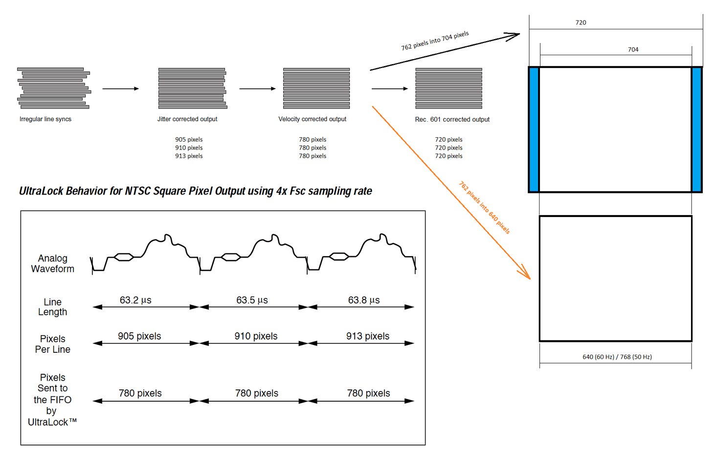

  13. @pandy, what is the point? Well, as I said, 720 samples per line are not "native" for the case of digitizing low-res analog video like VHS or Hi8. I don't know why I have latched on this word, I think I've seen it used, but maybe it is just a figment of my imagination. Rec. 601 was created to allow digitization of broadcast analog formats 625/50 and 525/60 and facilitiate the exchange between the two. VHS and Hi8 are not broadcast formats, so Rec. 601 has as much to do with these domestic video formats as ATSC or DVB-T with Netflix streaming formats.
    Another point was to make a counterpoint to the claim that most or all modern ADCs sample at one rate, and any resampling is done later programmatically either in the firmware of the ADC or by the capture program. This is a minor point simply to make a point.
    @Sharc, I see what you are saying. But I do not suggest sampling into 640 pixels right away, neither I suggest converting 720 pixels into 640 pixels. Please, see attached picture that I cobbled up from two sources and allowed myself to add to it.
    A certain ancient AD chip is shown using 4x Fsc to sample 3 successive lines of video and decode into square-pixel "NTSC" output. Because of time base errors, the lines have different duration and hence different length and different number of pixels (should be 909). So, the chip either removes extra pixels or adds interpolated pixels to obtain the same number of pixels per line, then resamples each line into 780 pixels.
    Then, if I understand it correctly, 780 pixels are resampled again into 720 pixels and sent to the capturing program, where the user is happy to capture them as, um, "native", non-resampled, crispity crisp, just what is recorded on tape... not.
    So, there are two resamplings before the "native" 720 pixels arrive to the capturing software. In this case, why being so hung up on this magic number? I am just saying that I don't see a huge difference between converting 762 pixels (out of 780) into 704 or into 640 pixels, this is what a good combination of ADC/software does - it strips the overscan and converts 4:3 frame into square pixels. It would be a third conversion either way. Will the effect on sharpness and detail be so bad?
