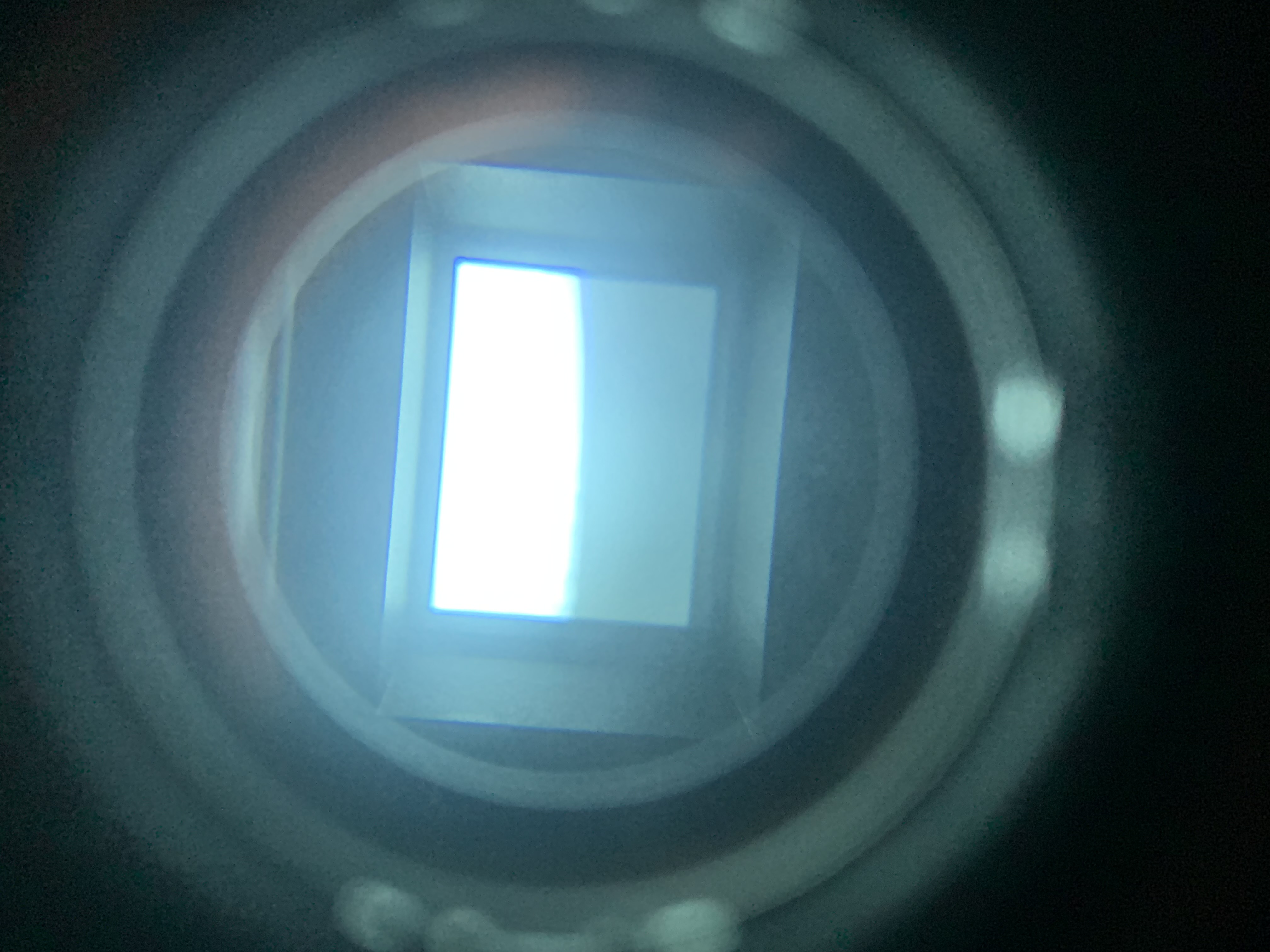

    [Attachment 91955 - Click to enlarge]
    Here is what my viewfinder looks like. Moving static on top and black on the bottom

    Could the tapes be Digital8?

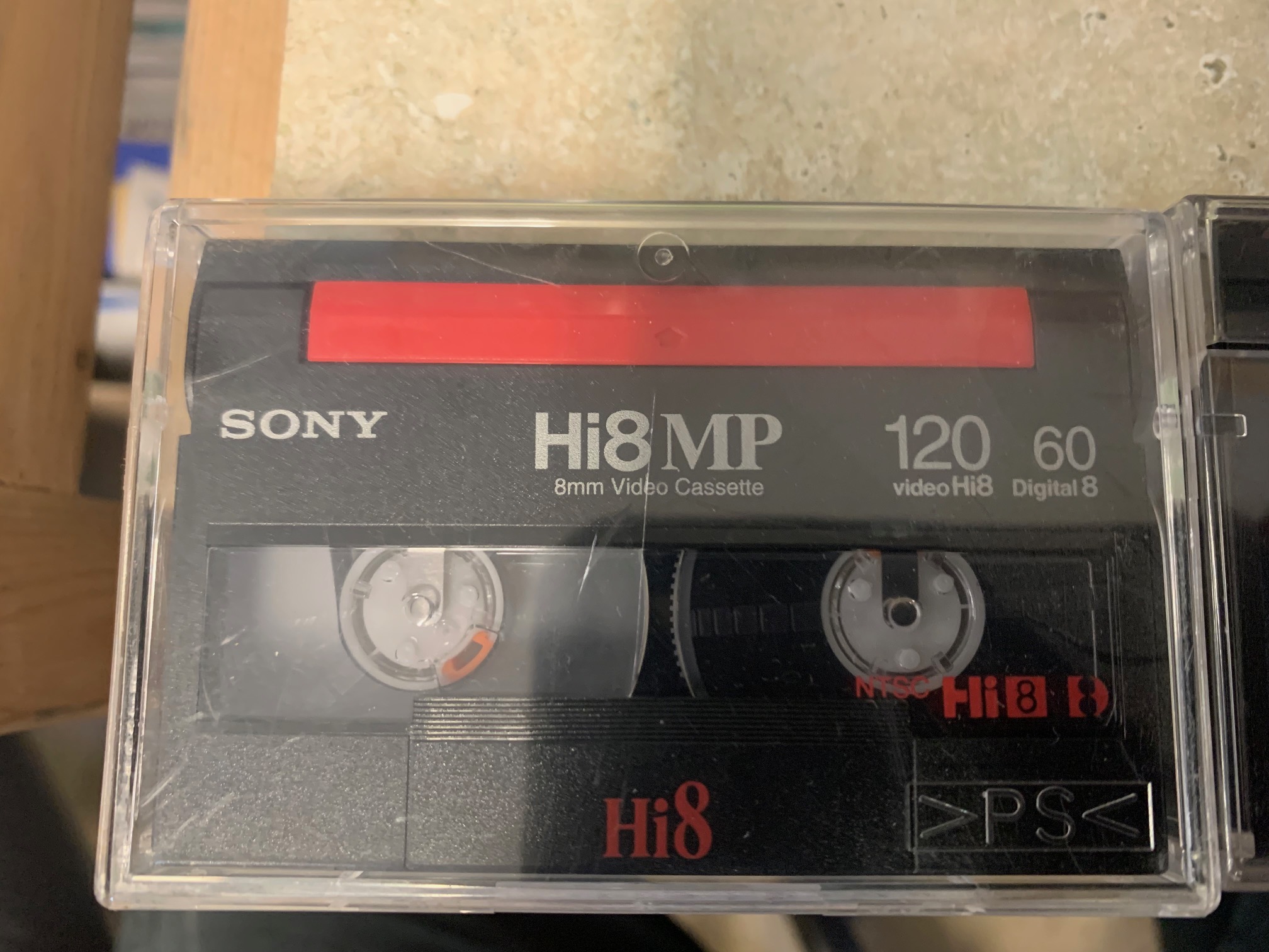

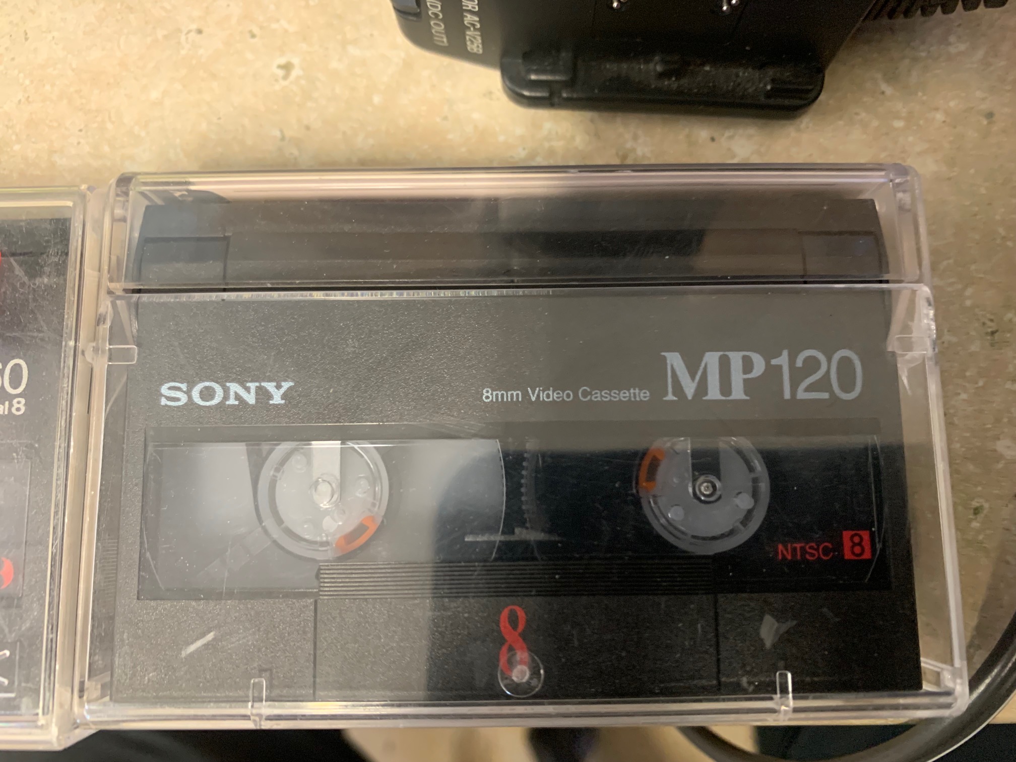

    [Attachment 91971 - Click to enlarge]
    [Attachment 91972 - Click to enlarge]
    Here are to images of the tapes. I see the one is a hi-8 which could cause issues. But the other one from what I can tell is a video 8, am I correct?
    That would be the most simple/logic explanation.
    You can record D8 on regular Video8 tape but it was not recommended.

    A digital signal can be recorded on Hi8 and regular 8. So the physical tape is not necessarily an
    indicator of the signal that was recorded. From duckduckgo:
    can a digital8 recording be made on a hi8 or regular 8 tape?
    Yes, a Digital8 recording can be made on a Hi8 or regular 8 tape, but it will yield less recording time compared to
    using a Digital8 tape. For example, a 120-minute Hi8 tape will provide only 60 minutes of Digital8 recording capacity.

    Thank you all so much for this information. I'm going to talk to the guy who gave me these tapes and see if they were recorded digital 8. I never knew that a person could use video 8, or hi 8 on a digital 8 setup. It appears I may need to purchase a digital 8 camcorder.
