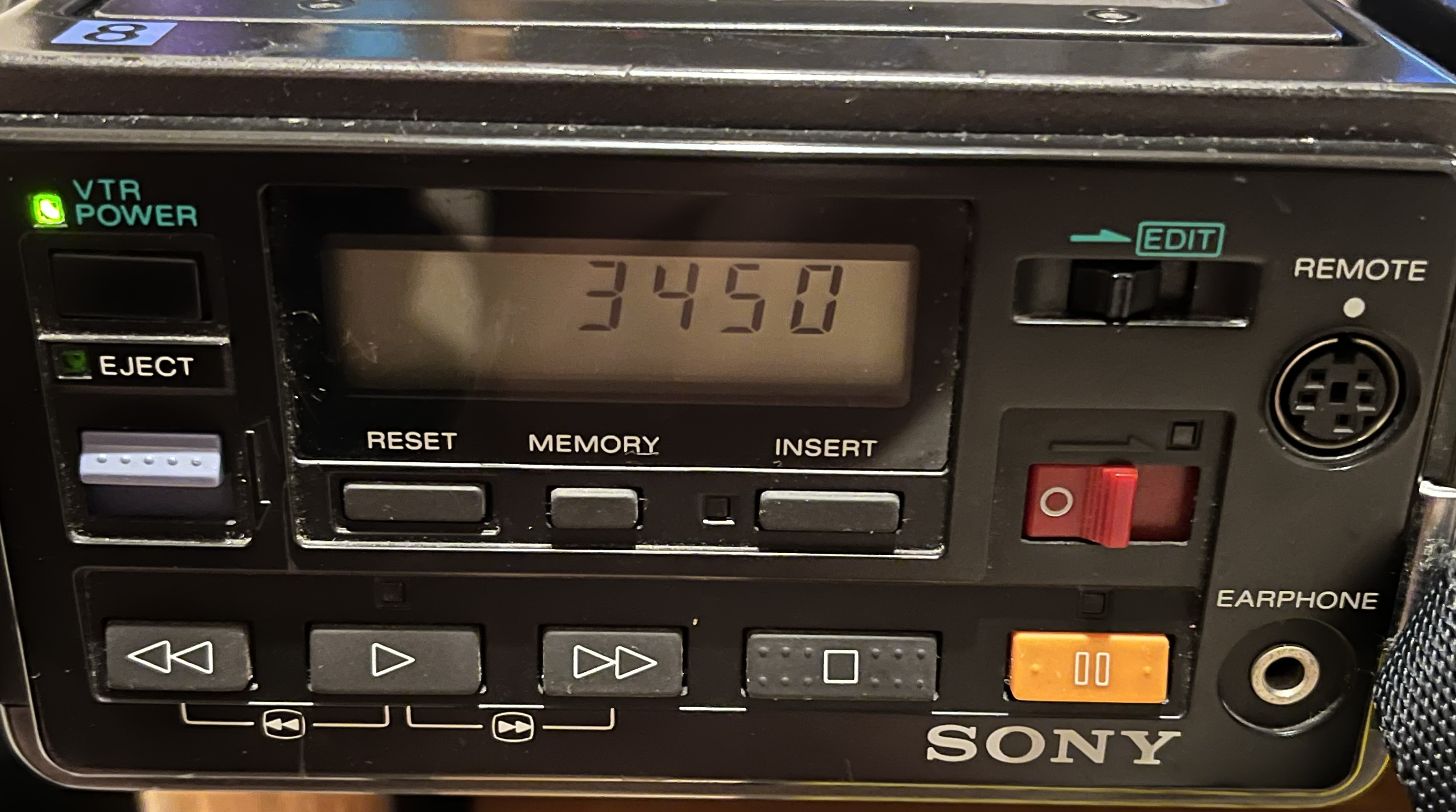

    Buttons on the back:
    [Attachment 77601 - Click to enlarge]

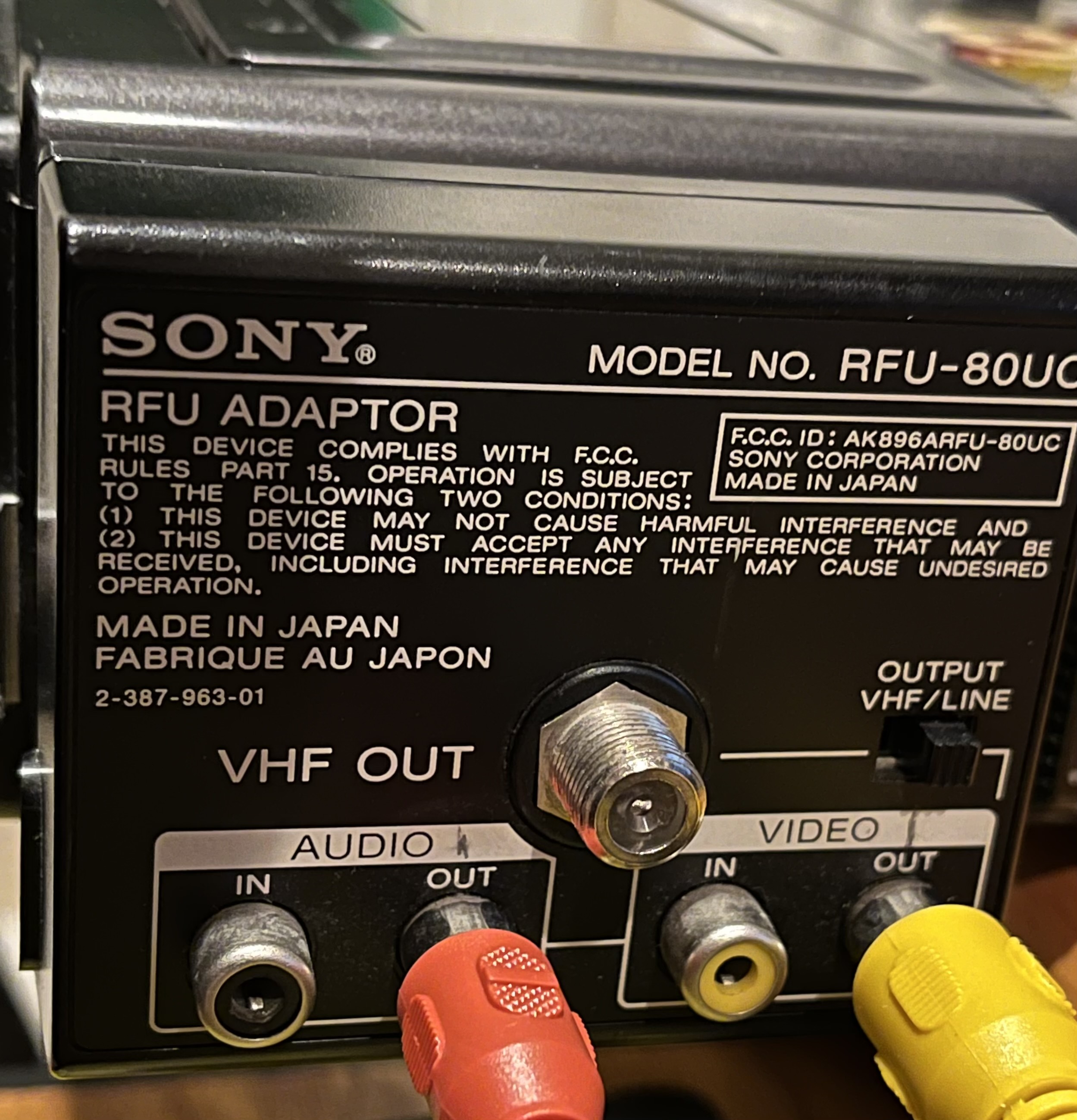

    RFU adapter (original from the 80s):

    - no sound emitting from the camcorder (couldn't find anything that looks like a speaker)
    - no sound from the earphone jack via verified working headphones
    - tried all 4 combinations of VHF/Line switch on the RFU adaptor + upper right switch on back buttons - left green arrow side, and right edit side

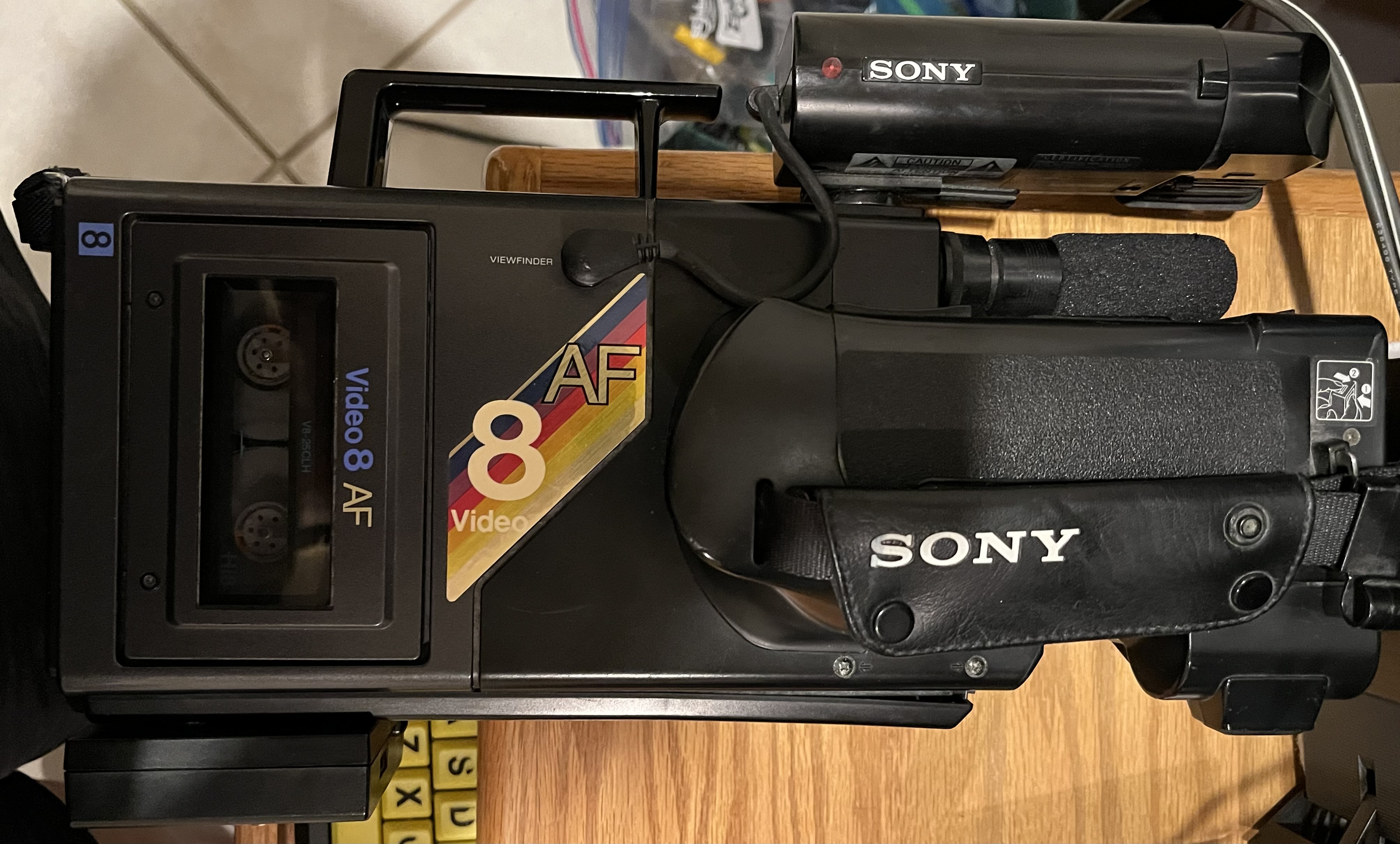

    - original microphone still attached Image
    [Attachment 77603 - Click to enlarge]
