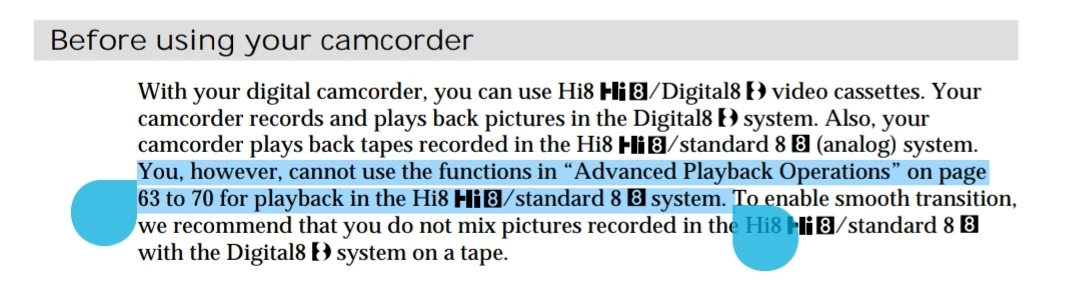

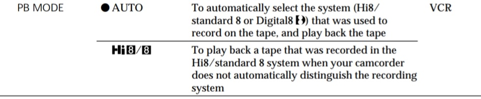

	Digital8 cams like DCR-TRV340 have an option to "force" analog playback mode, but I've never tested it with a Digital8 tape to see if you can really make it output garbage.
 If your cam has "advanced playback options", you can try one of them on a tape. If they work, it's digital.

	You wouldn't know if the tapes are V8/Hi8 or D8 unless you have a D8 camcorder capable of playing back analog tapes, The camcorder should display Hi8 or D8 on the screen, V8 played back without indication, The difference between analog and digital is the bottom section of the frame, analog has head switch noise, digital has a clean frame.

 Or put it into a Digital8 cam and it'll tell you whether it's D8, HI8, or Video8 (Just shows an 8).
 It does. I always enable this mode if I know the tape is analog.
 It's a copy/paste of post #11 in case you missed it.
	IF a specific D8 camcorder can play analog tapes, it will output the signal via Firewire and svideo.
 When you put the tape in, it will show on the screen the tape format, with a D8, HI8, or 8 indicator. That's how you'll know. But if you're transferring via FireWire it won't really matter what the format is.
 I've seen some D8 and miniDV tapes that did not have datecodes embedded, so not a 100% sure indicator there. The camcorder screen will indicate the format for you.

 Originally, I looked for this on the camera, and thought that I didn't see it. Nothing seemed to say Digital8 or otherwise. But what I wasn't looking for, was the Digital 8 logo, which looks like a D with an 8 inside it. As I'd never seen this before, I didn't know what it was. But, the fact that my camera is displaying that symbol during playback is a surefire indicator that my tapes are in fact digital!
