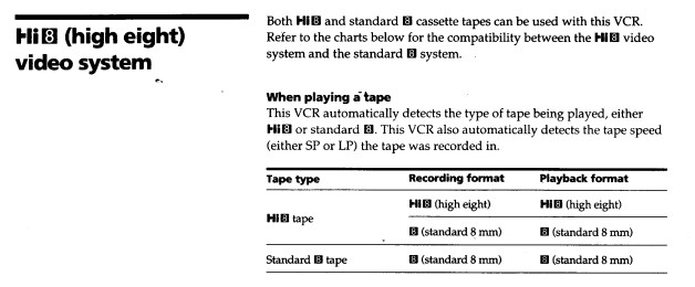

    I think this shows conclusively that the V200 doesn't do D8 (this is an excerpt from the manual); no D8 symbol is shown. Another clue is that I think that if it played D8, it would have a Firewire Out port.
    [Attachment 79502 - Click to enlarge]
