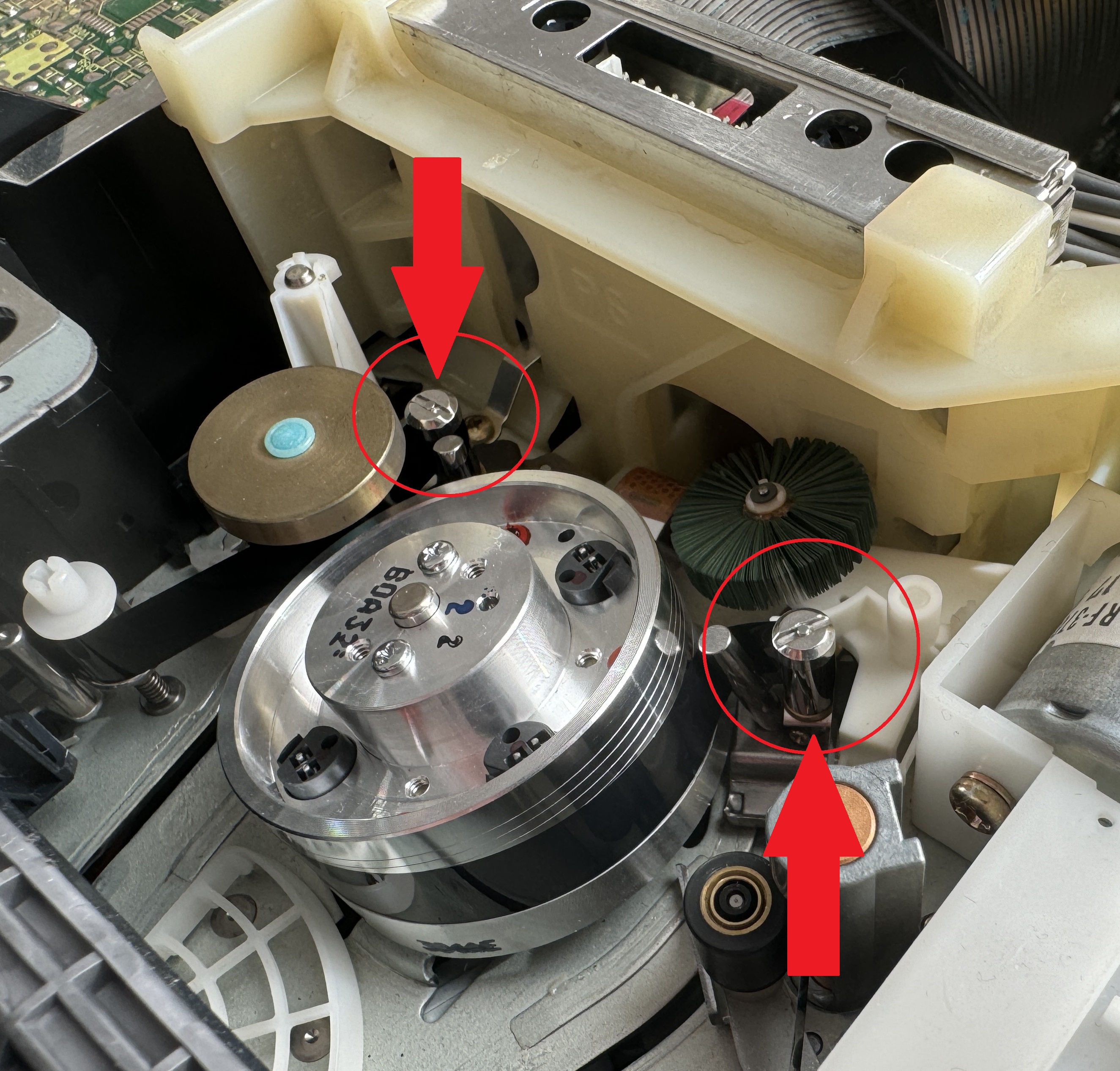

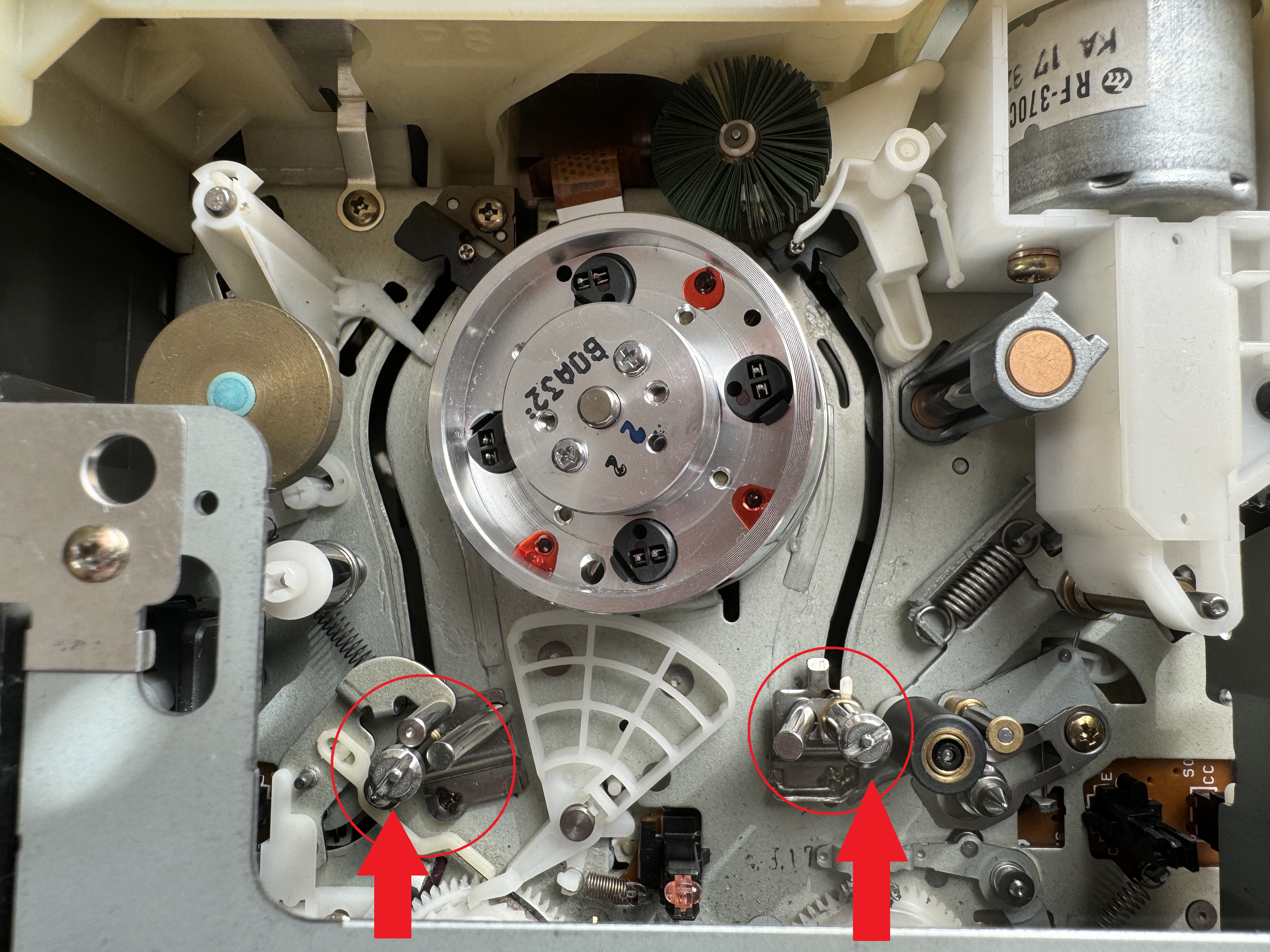

    The path that a video tape takes through a playback device must be very precisely matched to the respective specifications of the corresponding format on the one hand, and to the respective playback device on the other in order to achieve the best possible results. Every tape-guided playback device has so-called tape guides (see Fig. 1), which are height-adjustable by means of a small screw on their upper side and which have the purpose of adjusting the exact angle between the tape and the rotating head drum so that the video heads located on the rotating head drum can read the information on the tape at exactly the right angle.

    Fig. 1: Tape guides inside of a Sony EV-S900E (PAL)

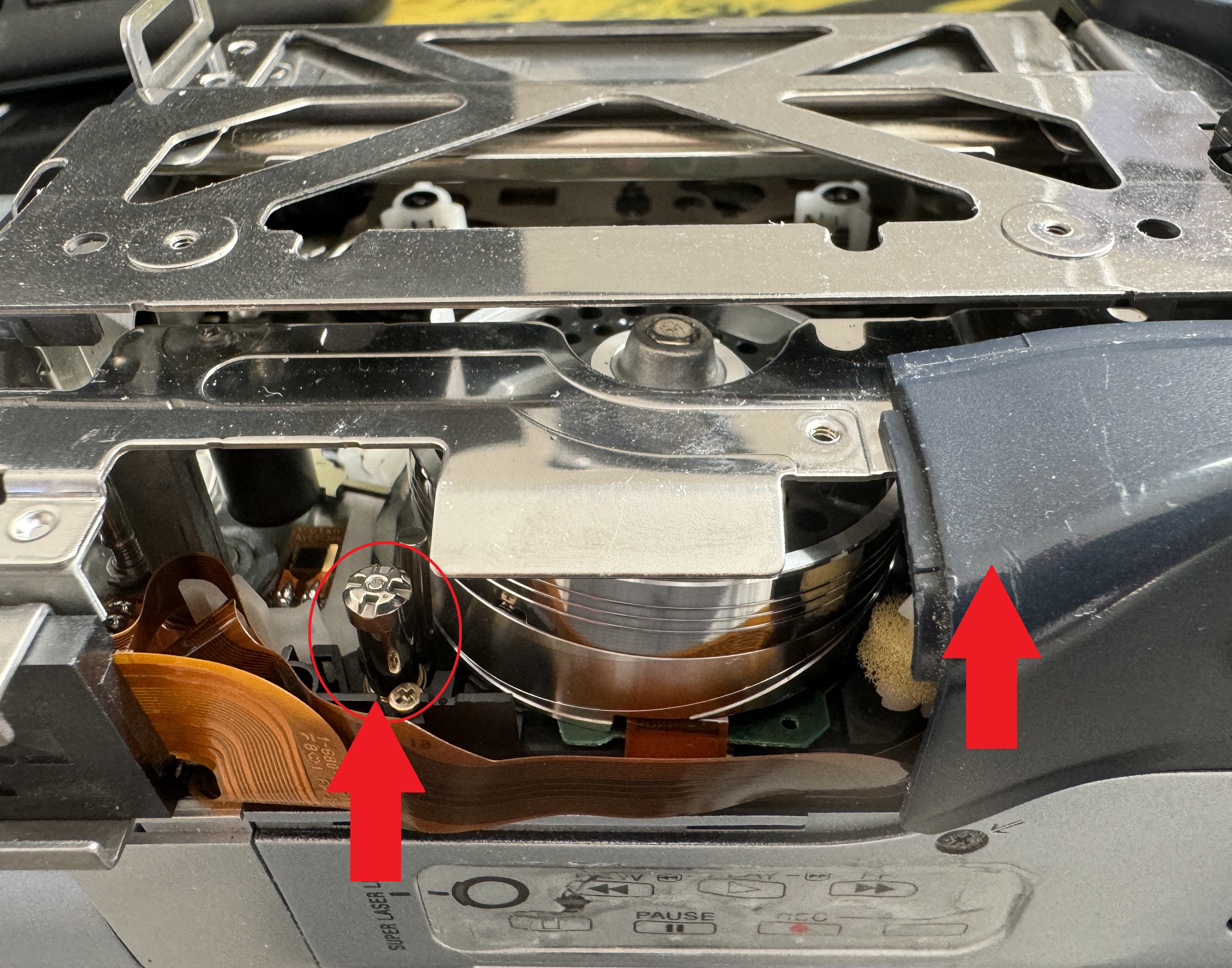

    Fig. 2: When the tape is inserted, the tape guides move upwards together with the tape to place it around the rotating head drum. The correct angle between the tape and the head drum is crucial for obtaining a clear signal.

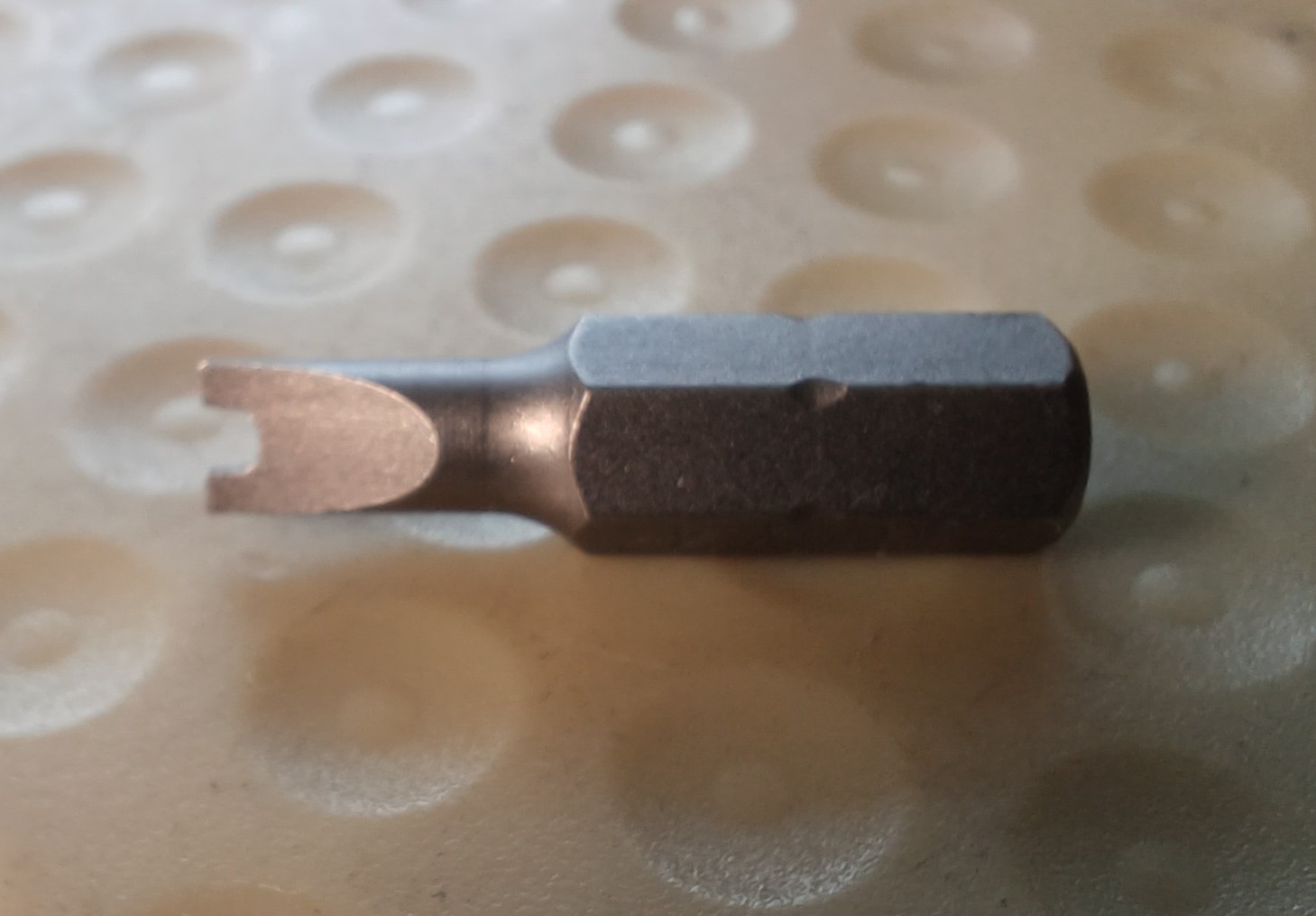

    Fig. 3: Poor access to the tape guides on a Sony Digital8 TRV 730E camcorder

    Step 5: If you notice that going in one direction, the signal is not getting better or even worse, turn it in the other direction, millimeter / inch by millimeter / inch and observe the picture and sound. If picture interference tends to be at the upper part of the picture, the input tape guide (the left one) should be turned. If the interference is at the bottom of the picture, turn the right guide. In any case, both guides must be rotated in order to find out at which pivot point the best signal (picture and sound) is present. This involves a lot of trial and error, and in my case the range between the two end points where the signal becomes unusable is remarkably wide in both directions of rotation. In some cases, several 360° rotations are possible until I get from one end point to the other. The ideal does not necessarily have to be in the middle between the two end points.

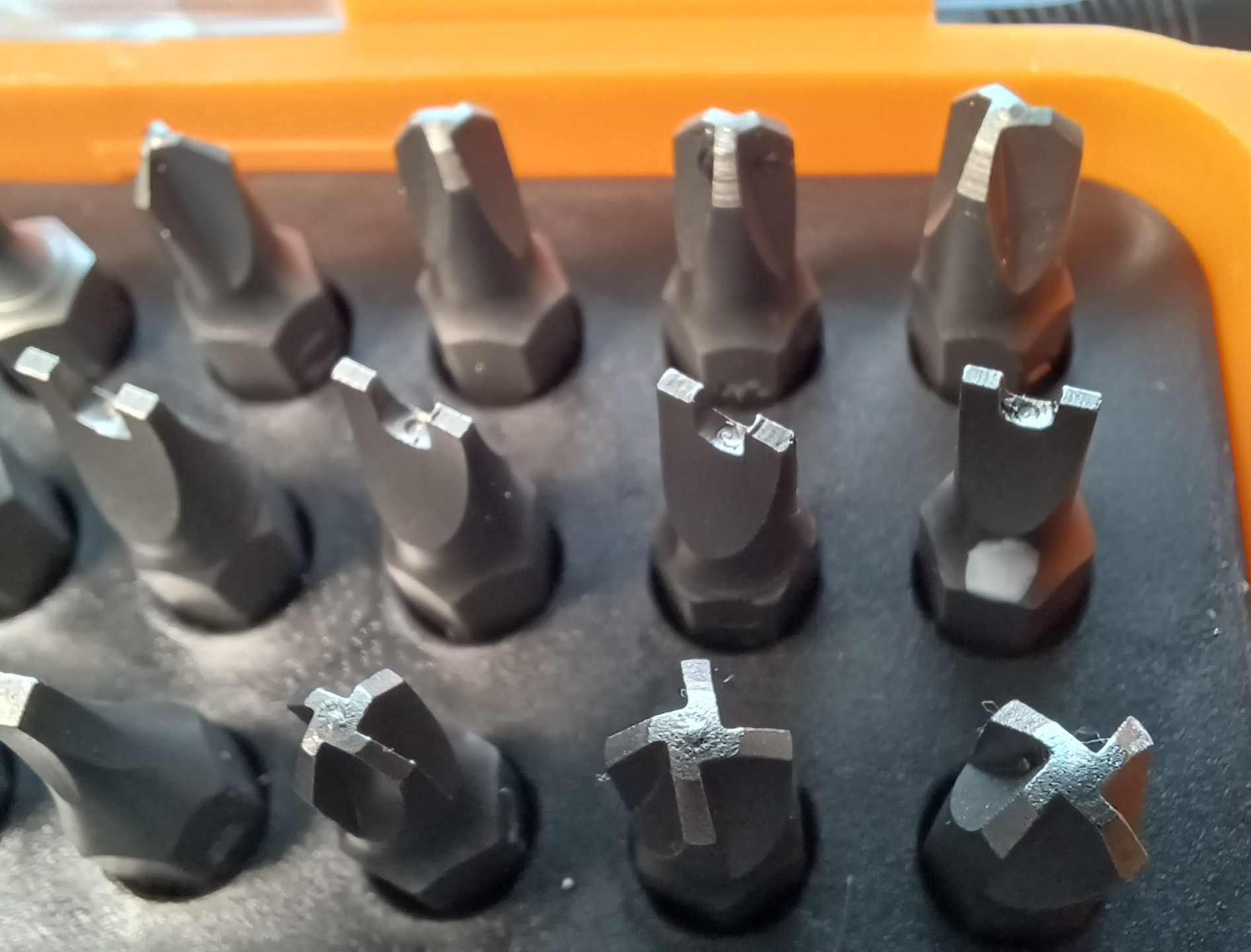

    I have a Daichi H89 guide adjuster tool. Maybe it's the same as the AT389. It does work on the guides of some Sony Video 8 camcorders I have but as the guides are so perilously close to the spinning head drum (about 2mm clearance) and the H89 tip is actually wider than the guides themselves I chose for safety's sake to use a narrower tip.
    In a set of screwdriver tips from a local hardware store I found these tips. The narrowest one at 4.5mm wide (marked with a white dot on its shank) works well and is a little narrower than the guide's head itself.
    As per the instruction and photos above, be very careful when using such a tool. It's so easy to accidentally catch the fast spinning head drum and do instant damage to it.
    Using a fine tipped felt marker pen I place a mark on the adjuster heads, referenced to another stationary mark made nearby it, or at least I take photos of the original positions. I adjust only a small amount at a time, perhaps 1/8th of a turn. If there is no change at all in picture or sound, I dont go further. It's probably the other guide. Be slow, patient and methodical. If in doubt, seek help.
