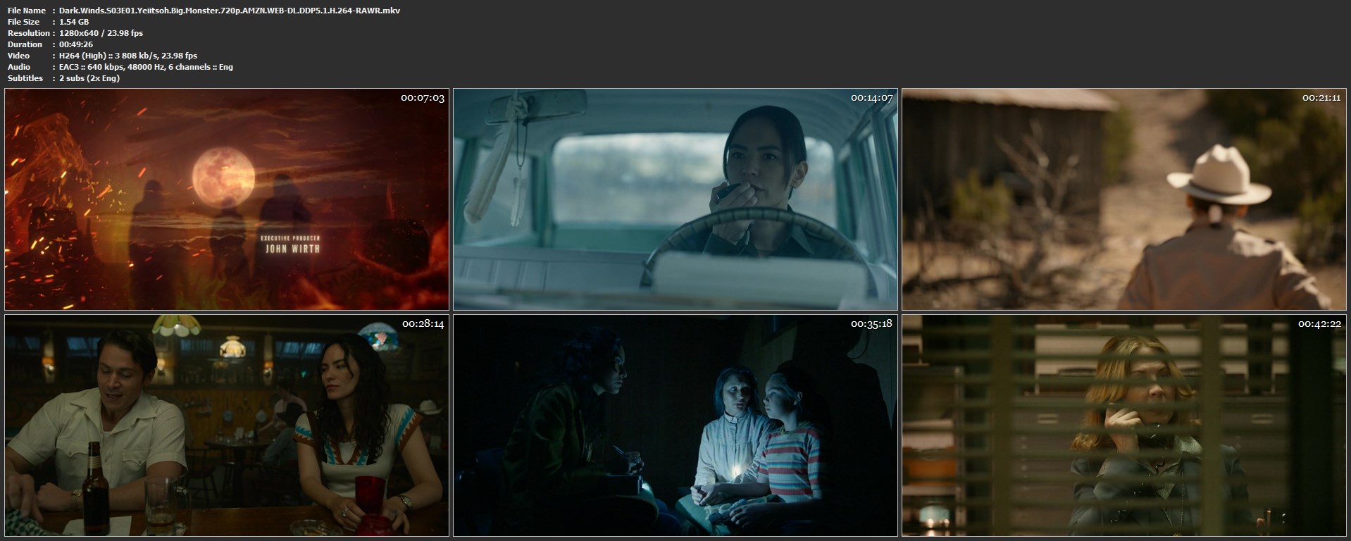

  1. hi is it possible to create a thumbnail from video files like the sample below with batch file either with mtn or ffmpeg including the mediainfo as the sample image ?
    im currently using video thumbnail maker but was wondering if this can be done with bat file
    [Attachment 87353 - Click to enlarge]

    but also need to be saved as the sample as 1 image. not take 7+ images depending on the duration. create a single image with 2 rows 3 columns if possible

    thank you but i couldnt make it work to my needs but i managed to make it work with mtn with this
    @echo off
    for %%i in (%*) do call :doit "%%~i"
    goto :eof
    :doit
    "mtn location\mtn.exe" "-r 2" "-w 1920" "-g 10" "-j 85" "-b 0.80" -k 000000 -F FFFFFF:11 -P -o .jpg "%~nx1"
    goto :eof
