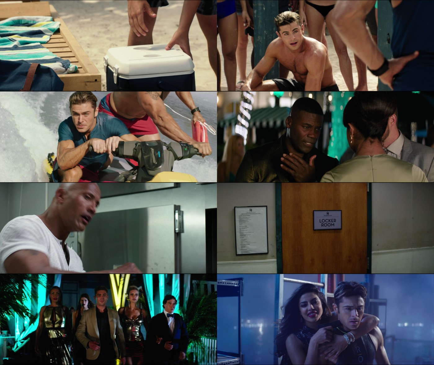

How can i get screenshot like this using ffmpeg command line? i found to extract only one frame but i could not find any command line to create screenshot like this using ffmpeg.
https://forum.videohelp.com/images/imgfiles/xGcbp4F.jpg
currently i using mtn file. i got an output like this https://forum.videohelp.com/images/imgfiles/Z9fxzWV.jpg
it's like mtn movie thumbnailer could not read the middle of the video file time line. it happened for couple of video file. i tried few other command line for mtn movie thumbnailer but result is same. so i want to test with FFMPEG.

Something like:
Code:ffmpeg -i %1 -vf "select='eq(pict_type,I)',scale=192:-2,tile=2x4" -vsync 0 "%1_preview_I_frame_%%06d.png"
thank you, it's working fine.

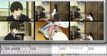

Use the seconds formula:
Select one frame every 120 secondsCode:ffmpeg -i input -filter_complex "select='not(mod(n,120))',scale=120:-1,tile=layout=3x2:padding=4" -vframes 1 -q:v 2 output.jpg
Scale each frame to a smaller size (alternatively you can scale after tile)
Tile each frame into one image. Default grid size is 3x2, Padding between images is 4 pixels
You may have to adjust that with layout depending on how many images you want to display.
[Attachment 60080 - Click to enlarge]Last edited by Budman1; 27th Jul 2021 at 23:01.
i am not sure but is't `scale=xx` using for the the image wide?
may be use this?
-vf fps=1/100
Code:https://trac.ffmpeg.org/wiki/Create%20a%20thumbnail%20image%20every%20X%20seconds%20of%20the%20video
Not sure... I prefer not to affect fps size or time for adjustments. It can cause too many computations for me. I prefer to work with actual pixels for width,height,resize, etc.may be use this?
-vf fps=1/100
The scale=120:-1 says scale the width to 120 pixels and the height proportional to the oruiginal aspect (-1)
select='not(mod(n,120)) means select 1 frame every 120 seconds (2 minutes)
padding=4 means separate each image by 4 pixels. So:
3x120 =360 plus 2 gaps of 4=8 total is 368 pxels, as shown by the screen ruler -
thank you so much, i mixed up with scale and "select='not(mod(n,120))". my bad.
i added -ss 00:10:00 and then i added select='not(mod(n,200)). i got the desire output screenshot.
