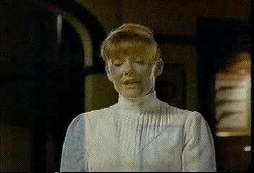

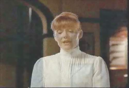

Here are a few frames from the original dv.
sample.avi
They are a bit gray but that's another issue. I was going to start another thread later after my research is done. -

I got a chance to send your sample to my camcorder. Right away it pops up a "copyrighted material" message and stops. After reencoding I no longer got the message and the video recorded normally.

At least I know that your camera reacted just like mine to that dv clip.
I suspect that your own short clip from the commercial vhs got written to tape without that signal that is why your camera didn't react when you sent it back. I can probably get a few frames like that too but not 10 seconds worth. I did manage to transfer a few frames to my camera tape from the pc dv avi before the camera could stop it just by pressing record multiple times on my cam record lcd touch button. I could try that again and resend it to the pc then back to the camera but I have a feeling that it would work and wouldn't prove much.
