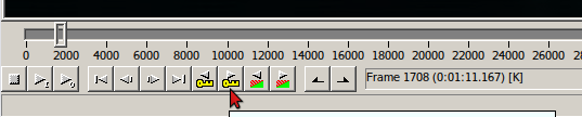

    I've never used VideoStudio, so ignore this post if it doesn't help, but you can find keyframes with a media player such as MPC-HC, or using the keyframe buttons on VirtualDub2's navigation bar. That'll also tell you their frame numbers. I don't know if that'll help you....
    [Attachment 91757 - Click to enlarge]
