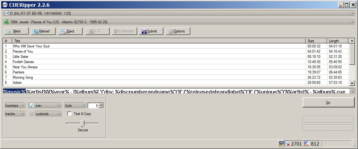

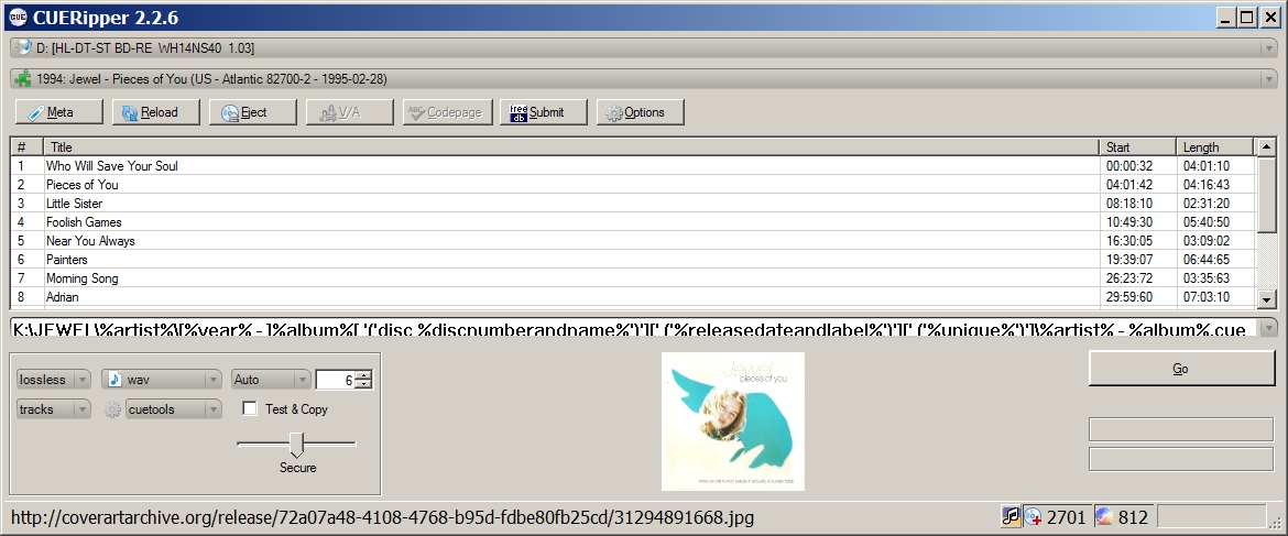

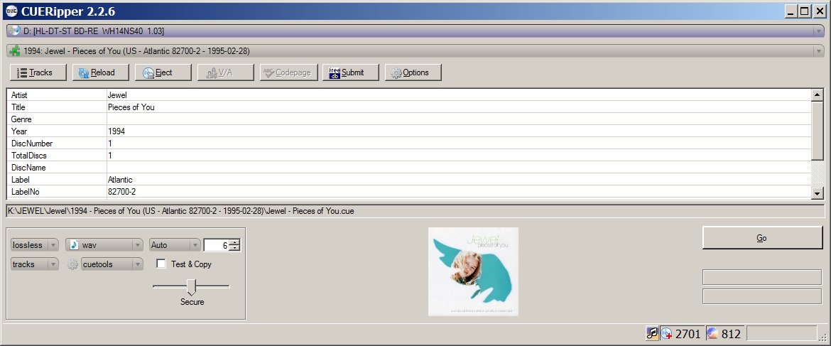

Using CUERipper:
Click on the default destination line.
Replace %music% with "location of your destination folder"(without quotes).
[Attachment 91605 - Click to enlarge]
[Attachment 91606 - Click to enlarge]
I put it on Tracks & selected Reload.
[Attachment 91607 - Click to enlarge] -
