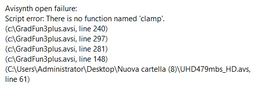

[Attachment 91229 - Click to enlarge]
grad3funplus: there is no function named "clamp"
what can it be?
Make sure you also have the GradFun3Plus dependencies for whichever version you're using (it's probably one of more of his other functions). They're listed near the top of each script.
https://github.com/Dogway/Avisynth-Scripts/blob/master/EX%20mods/GradFun3plus.avsi
or
https://github.com/Dogway/Avisynth-Scripts/blob/master/MIX%20mods/GradFun3plus.avsi
Edit: It looks like you need his ExTools function.
https://github.com/Dogway/Avisynth-Scripts/blob/master/ExTools.avsiLast edited by hello_hello; 16th Feb 2026 at 20:33.

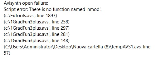

but now I getCode:
Import("v:\automazioneclip\AviSynth\FFMS2_26022024\FFMS2.avsi") LoadPlugin("V:\automazioneclip\AviSynth\FFMS2_R1363_AGO2023\X64\ffms2.dll") LoadPlugin("v:\automazioneclip\AviSynth\LSMASH2026\x64\LSMASHSource.dll") LoadCPlugin("v:\automazioneclip\avisynth\plugins64\yadif.dll") LoadPlugin("v:\automazioneclip\AviSynth\YADIFMOD2_2023\x64\yadifmod2.dll") LoadPlugin("V:\automazioneclip\AviSynth\MaskTool2\X64\masktools2.dll") LoadPlugin("V:\automazioneclip\AviSynth\Santiag\ResampleMT.dll") LoadPlugin("V:\automazioneclip\AviSynth\Santiag\nnedi3.dll") LoadPlugin("V:\automazioneclip\AviSynth\Santiag\aWarpsharpMT.dll") LoadPlugin("V:\automazioneclip\AviSynth\Santiag\eedi3.dll") LoadPlugin("V:\automazioneclip\AviSynth\Santiag\EEDI2.dll") LoadPlugin("V:\automazioneclip\AviSynth\Santiag\GScript_26_64.dll") LoadPlugin("V:\automazioneclip\AviSynth\Santiag\SangNom2.dll") Import("V:\automazioneclip\AviSynth\Santiag\santiag.avsi") Import("V:\automazioneclip\AviSynth\QTGMC2025\QTGMC.avsi") Import("V:\automazioneclip\AviSynth\QTGMC2025\Zs_RF_Shared.avsi") LoadPlugin("V:\automazioneclip\AviSynth\QTGMC2025\mvtools2.dll") LoadPlugin("V:\automazioneclip\AviSynth\QTGMC2025\RgTools.dll") LoadPlugin("v:\automazioneclip\AviSynth\BestSource\BestSource.dll") LoadPlugin("V:\automazioneclip\AviSynth\RIFE\RIFE.dll") LoadPlugin("V:\automazioneclip\AviSynth\RIFE\avsresize.dll") LoadPlugin("V:\automazioneclip\AviSynth\RIFE\PlanarTools.dll") LoadPlugin("V:\automazioneclip\AviSynth\HDRTools\x64\Release_W7_AVX2\HDRTools.dll") Import("v:\automazioneclip\AviSynth\CropResize\CropResize 2025-06-16.avsi") Import("v:\automazioneclip\AviSynth\CropResize\CropResize Resizer Functions 2025-06-16.avsi") Import("v:\automazioneclip\AviSynth\CropResize\CropResize Wrapper Functions 2025-06-16.avsi") LoadPlugin("v:\automazioneclip\AviSynth\neo_f3kdb\x64\neo-f3kdb.dll") LoadPlugin("v:\automazioneclip\AviSynth\neo_f3kdb\x64\dither.dll") LoadPlugin("v:\automazioneclip\AviSynth\neo_f3kdb\x64\avstp.dll") Import("v:\automazioneclip\AviSynth\neo_f3kdb\x64\dither.avsi") Import("v:\automazioneclip\AviSynth\neo_f3kdb\x64\mt_xxpand_multi.avsi") Import("c:\ExTools.avsi") Import("c:\1GradFun3plus.avsi") #Import("c:\2GradFun3plus.avsi") Import("v:\automazioneclip\AviSynth\FrostyBorders 2025-04-14\FrostyBorders Avisynth\FrostyBorders 2025-04-14.avsi") LoadPlugin("V:\automazioneclip\AviSynth\FFT3Dfilter\x64\fft3dfilter.dll") LWLibavVideoSource("temp.mkv") CropResize(1920) #GradFun3DBmod() #gradfun2db() ConvertBits(8, Dither=0) GradFun3Plus() #Prefetch(12)
[Attachment 91239 - Click to enlarge]
ps: I have installed AviSynthPlus_3.7.5_20250420_vcredist.exeLast edited by marcorocchini; 17th Feb 2026 at 03:57.
Did you check the list of dependencies at the top of the Gradfun3Plus scripts as I suggested?
For the ExMod version:
### ExTools
### ResizersPack (for smode=0 or smode=3)
### MasksPack (for smode>0)
### DFTTest (for smode=1)
For the MixMod version:
### ExTools
### RgTools
### MaskTools2
nmod is a function contained in Dogway's ResizersPack script. The MasksPack is also one of his scripts.Avisynth functions Resize8 Mod - Audio Speed/Meter/Wave - FixBlend.zip - Position.zip

but I'm a cat, not a programmer. However if if use the MixMod version, for example, where I can download the
### ExTools
### RgTools
### MaskTools2
By the way, when you installed Avisynth+ it should have created four plugin folders if you installed both the 32 bit and 64 bit versions, or two plugin folders if you only installed one of them. By default they're probably in the C:\Program Files (x86)\Avisynth+ folder. For 64 bit Avisynth, I put all the avsi functions I use in the plugins64 folder, and 64 bit dlls/plugins in the plugins64+ folder. Avisynth+ will automatically import scripts and load plugins from those folders when it runs, so you can do away with all those Import and LoadPlugin lines in your scripts.
Just make sure for something like GradFun3Plus, where there's two version of the function, you only put one of them in the plugins folder so you can be certain which one has been loaded.Avisynth functions Resize8 Mod - Audio Speed/Meter/Wave - FixBlend.zip - Position.zip
Avisynth/VapourSynth functions CropResize - FrostyBorders - CPreview (Cropping Preview) -
ExTools, ResizersPack and MasksPack are Dogway functions.
RgTools, MaskTools2 and DFTTest are plugins you'll easily find with google.
Or just search for them here: http://avisynth.nl/index.php/Main_PageAvisynth functions Resize8 Mod - Audio Speed/Meter/Wave - FixBlend.zip - Position.zip
