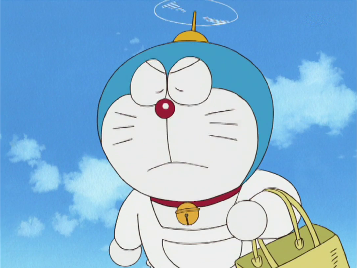

    I was deinterlacing an episode of a anime series until i came across this issue.
    [Attachment 90010 - Click to enlarge]
    Now seen from the image above, there seem to jumpy lines around the deinterlacing (I think the "Jumpy Lines" has a name, i just don't remember it from the top of my head)
    When I tried fixing this problem, all the deinterlacers has this same issues with the jumpy lines, and it has nothing to do with the interlacing itself since its a 1080i JPTVclub/TVRip, so the interlacing is perfectly fine.

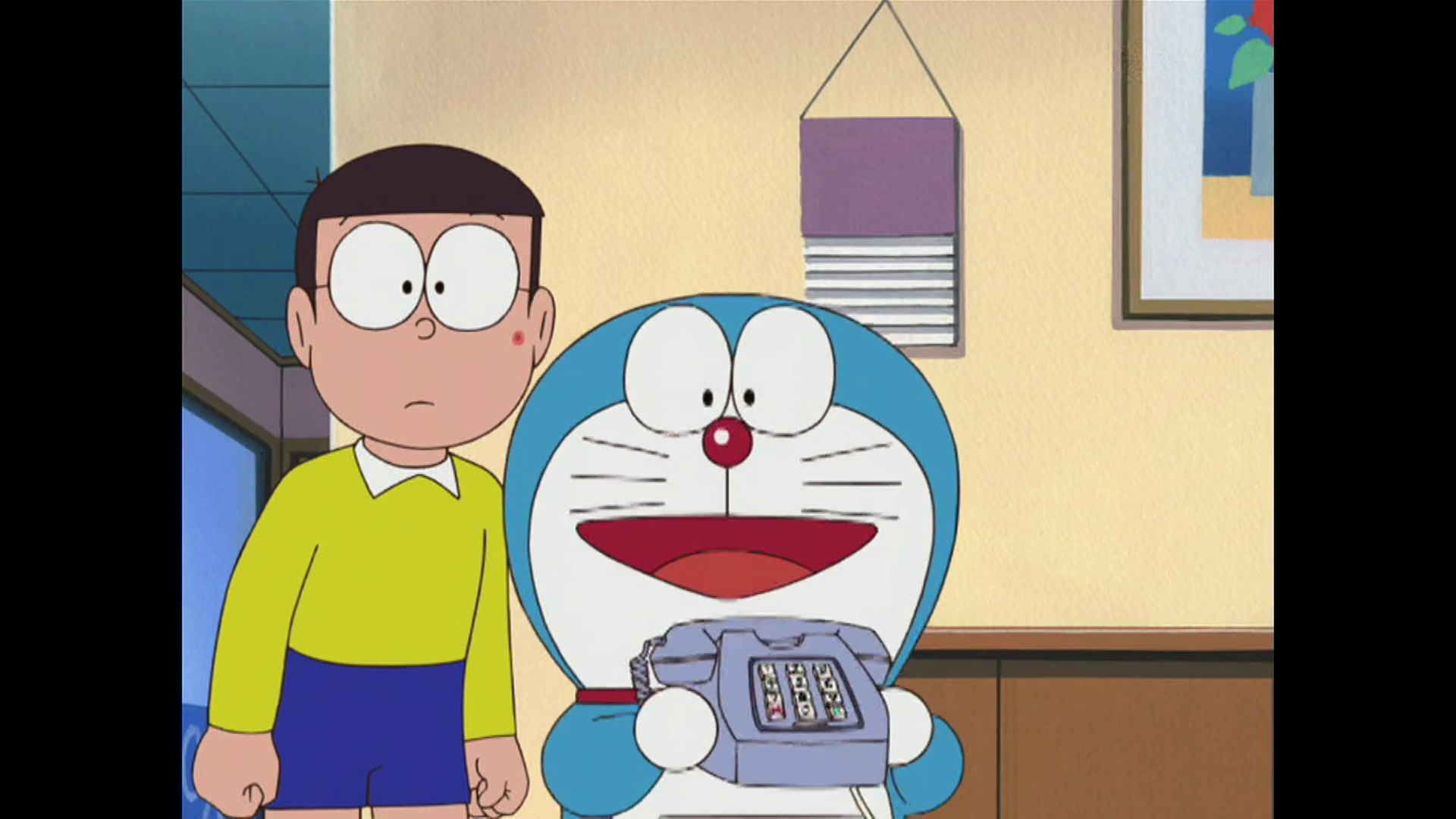

    The deinterlacer that worked best is TDeint Smart Field Match Bobbing but even so it makes the video more blury and slight line jumping.
    [Attachment 90011 - Click to enlarge]
    The only deinterlacer I haven't tried yet, is QTGMC and that is because I'm not experienced with the plugin (yet), and I haven't really gotten to learn about the plugin with all the huge batch of filters. So QTGMC should fix the issue (right?) but with or without QTGMC, i'd just want to fix this really annoying problem.

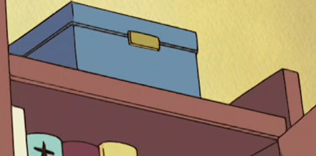

    From Sample 1, There some weird lining on some scenes, and the artifacts are still shown (all though this kind of lining can be removed, the quality will look all sloppy)
    [Attachment 90071 - Click to enlarge]
    And on Sample 2, it's not the best... they're some blurring, and yet again the artifacts are still there.

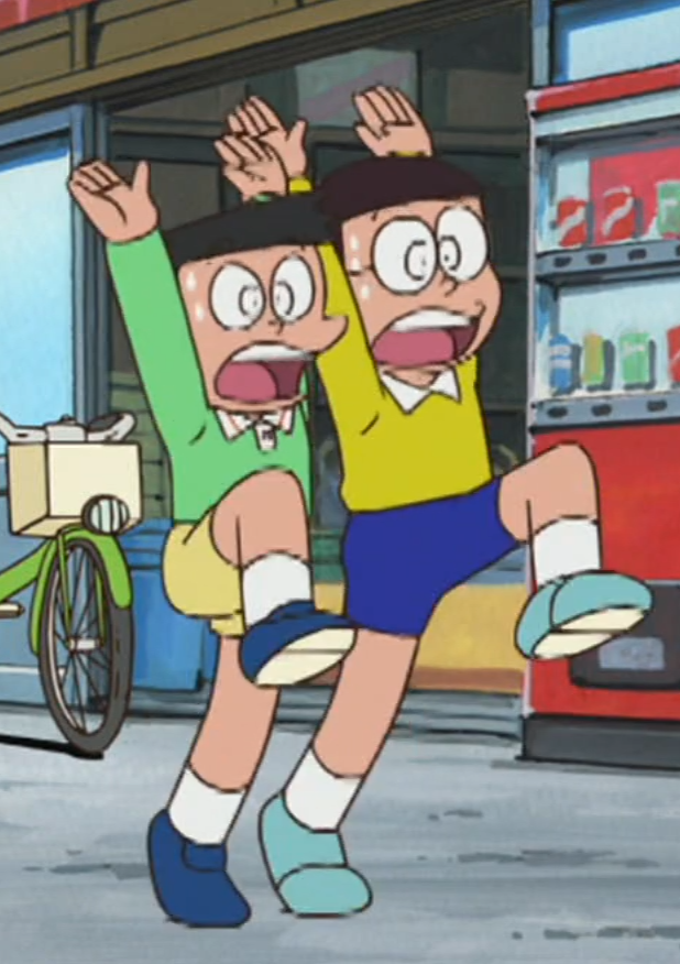

    You can use QTGMC to fix up a lot of the aliasing:
    LWLibavVideoSource("SampleFile2.ts")
    TFM()
    TDecimate()
    QTGMC(InputType=2, Sharpness=0)
    This doesn't do a good job since the line jumping is the most noticeable from all the other tests
    [Attachment 90072 - Click to enlarge]
  11. Yeah, as I said earlier, it's baked into the individual fields. If it's detected as combing de-interlacing is likely to make it look worse. Blend de-interlacing may be the least offensive method, but comparing frames 1438 and 1439 from your sample.... (I'm not expert enough to know for sure why it ended up this way).

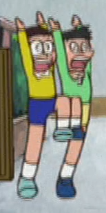

    This hard to explain but bare with me, it does that because between the progressive frames (3:2 pulldown, 3 proggresive frames, 2 interlaced frames) the lines still appear, but the lines appear as progressive so you don't really see any interlacing so the deinterlacers detect those lines as interlace and "deinterlaces" them. Which is why that issue is appearing from the place, and i need that issue to be fixed.
    [Attachment 90179 - Click to enlarge]
    Look closely to the image

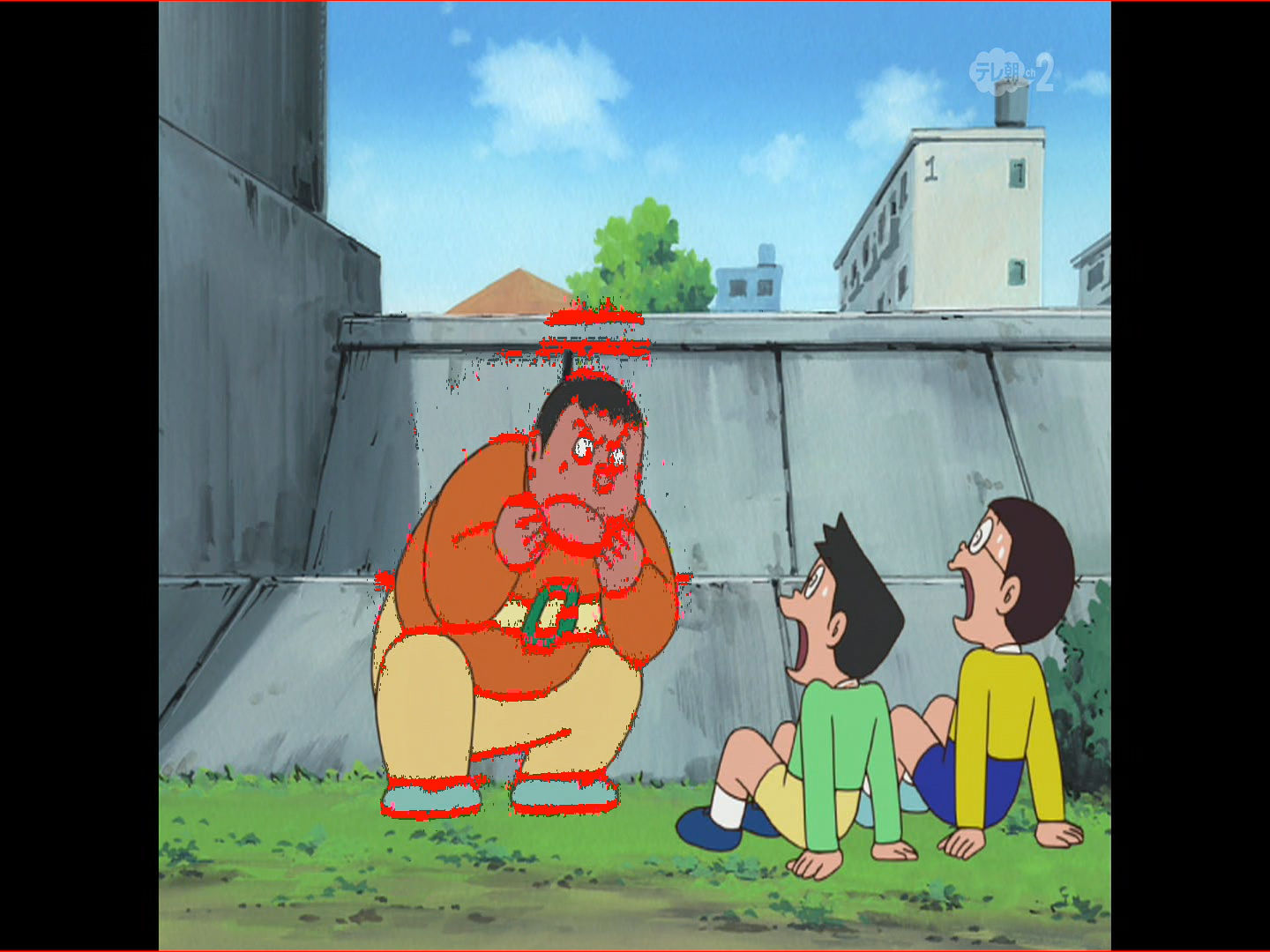

    I'm not sure I follow that, but most of the artifacts are due to problems with the video itself, and TFM isn't necessarily trying to de-interlace them. At least that's how it seems to me. You can check which pixels TFM thinks are combed this way. Where there's red, TFM has detected combing. As you can see, frame 1435 has issues, but its not due to de-interlacing.
    mpeg2source("O:\SampleFile2.d2v")
    L = Last
    X = BlankClip(L, color=color_red)
    TFM(clip2=X)
    [Attachment 90288 - Click to enlarge]
    This is frame 1439.
