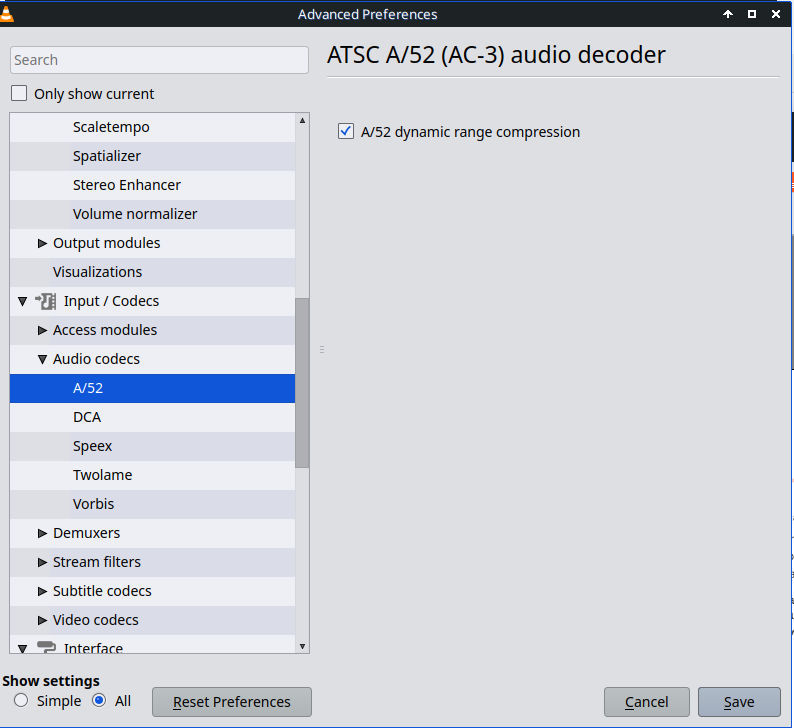

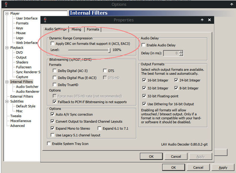

  5. I haven't had a chance to play with your samples yet, but here's the default AC3 DRC settings for MPC-HC, VLC (Linux version) and foobar2000 (I don't recall disabling it myself in any of the players). It wouldn't surprise me if Windows Media Player doesn't have a similar option, but I haven't used that nightmare of a player since the Windows 98 era.
    I don't re-encode audio directly with ffmpeg itself all that much, but I was still disappointed to discover you're correct and it has AC3's DRC enabled by default. https://ffmpeg.org/ffmpeg-all.html#ac3
    If I had to choose between re-encoding to remove the DRC and making sure I used a player that'd ignore it though, I'd go for the latter myself, if possible.
    [Attachment 88578 - Click to enlarge]
    [Attachment 88579 - Click to enlarge]
    [Attachment 88580 - Click to enlarge]

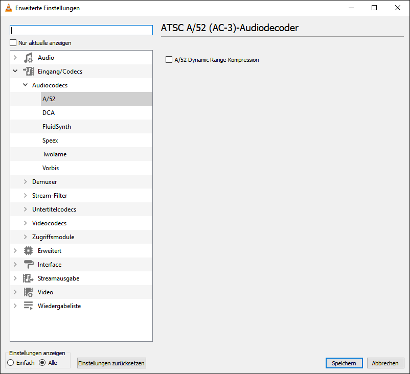

  6. Mhhh, DRC should be already turned off in VLC but I can hear, that it is on anyway.
    [Attachment 88588 - Click to enlarge]

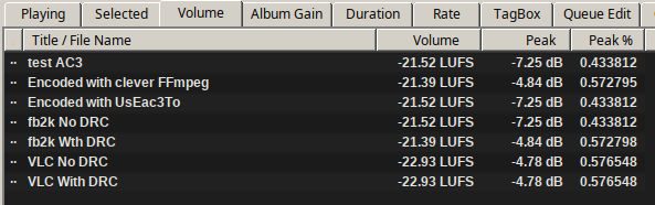

  7. For some reason foobar2000's internal AC3 decoder was unable to decode your AC3 sample, but I managed to use ffmpeg to decode it for foobar2000 instead.
    The results of a scan of the original AC3 (DRC disabled) and the various output files are in the screenshot below. I found it somewhat odd at first, as when DRC was applied the average volume increased a fraction and the peaks were about 2.5dB higher.
    I couldn't disable DRC while converting with VLC, and I couldn't work out why because I couldn't get it to write any sort of log file either. I've rarely used VLC so I'm not that familiar with it.
    [Attachment 88605 - Click to enlarge]

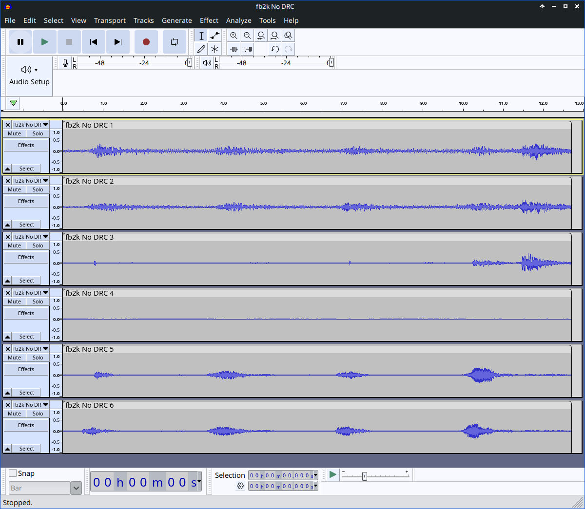

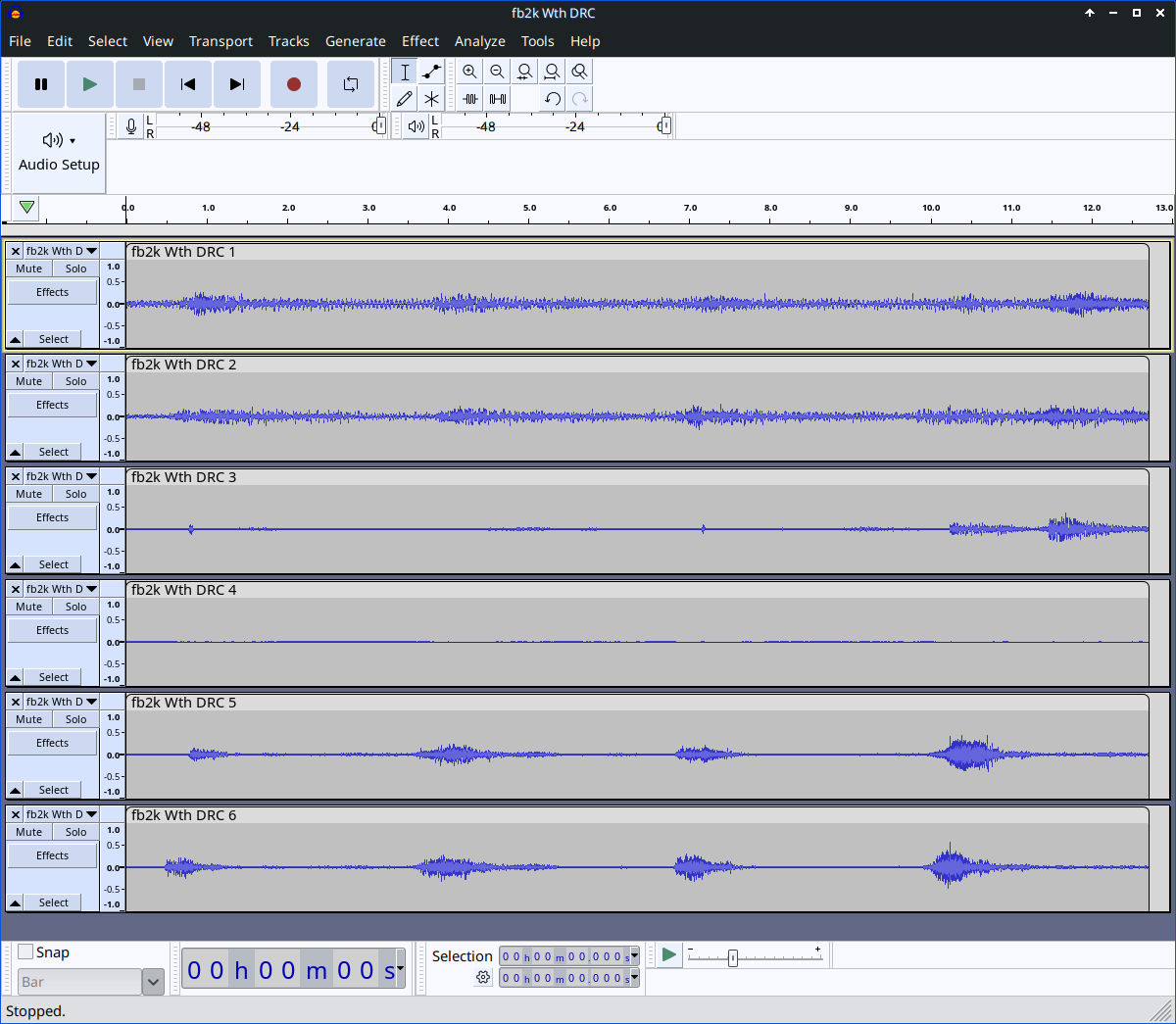

    I loaded the two foobar2000 conversions into Audacity for a look.
    AC3's DRC appears to increase the volume of the quiet parts as well as reduce the volume of the louder bits.
    The surround channels looked surprising though as visually they appear to be louder when DRC is enabled. It explains why the output with DRC applied has louder peaks than it does when DRC is disabled.
    No DRC

    With DRC
    [Attachment 88604 - Click to enlarge]
