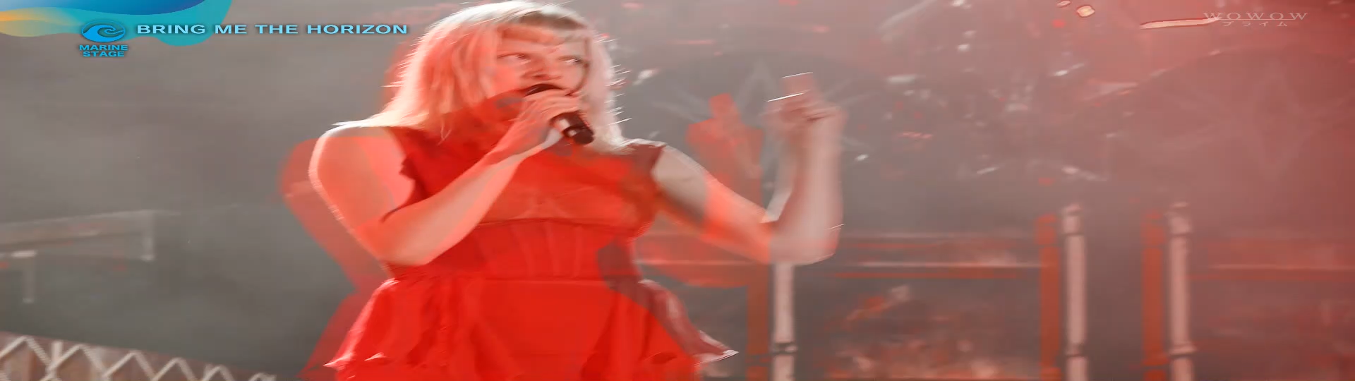

    There are additional errors with "VRD QSF Recode", such as chroma ghosting in the fields . Almost as if an incorrect progressive chroma resampling was applied- perhaps an RGB conversion - while still in interleaved fields . OP's version processed with VRD did not have those errors. You can use AssumeTFF().SeparateFields() and take a look - many of the fields are botched - especially in the 2nd half where there is more motion
    [Attachment 88379 - Click to enlarge]
