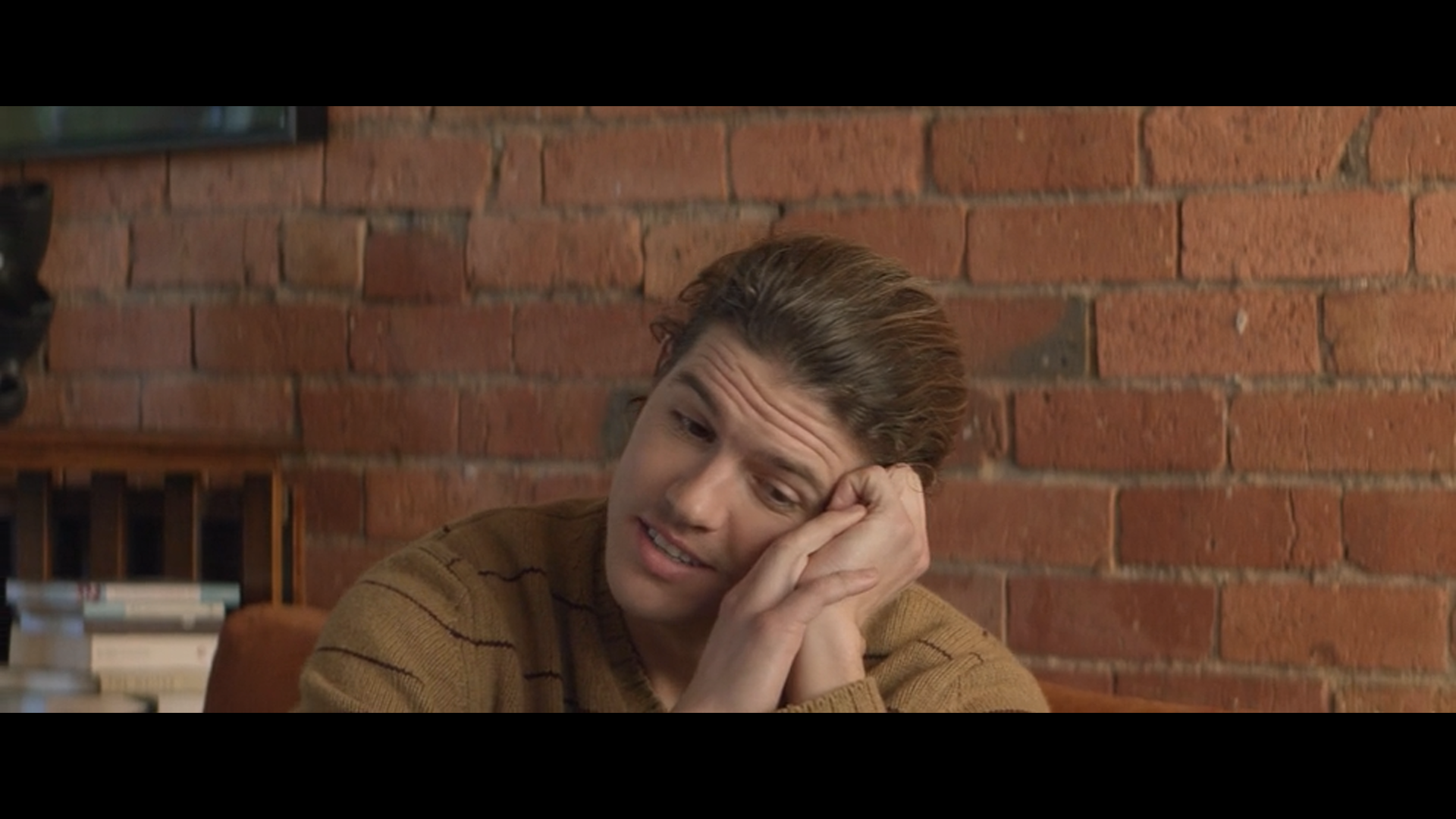

  6. One of the reasons you can get away with encoding HD or UHD video at a lower quality than SD, is the more the video is upscaled for viewing on a UHD TV, the more any encoding artefacts are upscaled too. Here's some screenshots from an old thread when I was involved in a similar discussion. The source was a UHD video encoded using CRF 24. I downscaled it to 900x400 and encoded it twice, once at CRF 24 and again at CRF 18. In this case the x264 encoder was used but I cant imagine why the same wouldn't apply when using x265. Maybe even more so, especially at 4k. All the screenshots are taken with the video running full screen on a 1080p display.
    4k source displaying on a 1080p monitor
    https://forum.videohelp.com/attachments/54812-1599500597/UHD%20at%201080p%20and%20CRF24.png
    Downscaled and encoded at CRF 18
    https://forum.videohelp.com/attachments/54814-1599500765/SD%20at%201080p%20and%20CRF18.png
    Downscaled and encoded at CRF 24
    https://forum.videohelp.com/attachments/54813-1599500597/SD%20at%201080p%20and%20CRF24.png
    I generally encode SD at CRF 18, HD at CRF 19 and 1080p or higher at CRF 20, and that's whether I'm using x264 or x265, but if space is an issue, you can get away with a lower quality at higher resolutions. I don't do much encoding of video over 1080p myself though.
