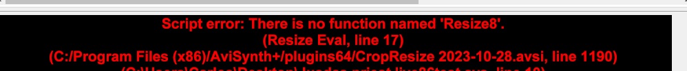

    Thanks a lot for the help, but I have this error, do you have any idea how to fix it, thanks.
    [Attachment 85698 - Click to enlarge]

  27. If you're using Avisynth Plus you might need to show or specify where the error message is coming from.
    The first error you posted showed it was being produced by CropResize. Does the second error message show anything similar?
    I don't think it's DitherTools, but have you used it before? If I remember correctly DitherTools had a problem with more recent versions of Avisynth+. Someone compiled an updated 64 bit dll at some stage, so just in case, it's attached. DitherTools also has other dependencies, but I can't think of where an argument or variable called "dm" would be used.
    Does the error only occur when you add Prefetch to the script?
    Maybe try commenting out everything but the source filter and uncommenting each function individually. It might help to find the culprit.

  29. Originally Posted by hello_hello View Post
    PS Prefetch(32) is a lot of threads. What CPU are you using?
