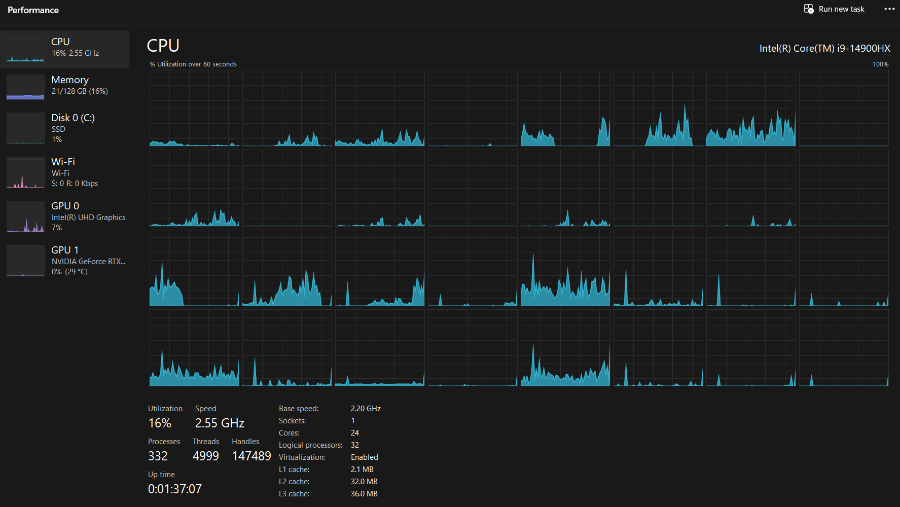

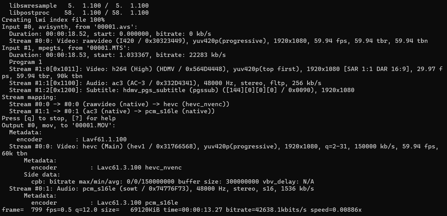

    I have to be missing something.
    Yes, I am well aware the preset is called "slower", but on every other video in the directory (they're all videos off my old AVCHD camcorder from high school like 12 years ago), the encode will generally run at between 75-85 fps. This one video in particular though, well, you can see the screenshots, it's pulling half a frame per second and falling. It starts off zip quick, but then it just, I dunno, poops its pants or something.
    The script is the same for every video in the folder and the ffmpeg input is the same for every video in the folder, with differences for the specified inputs and (in ffmpeg) output file names.

  2. The second video stream #1 input should not exist.

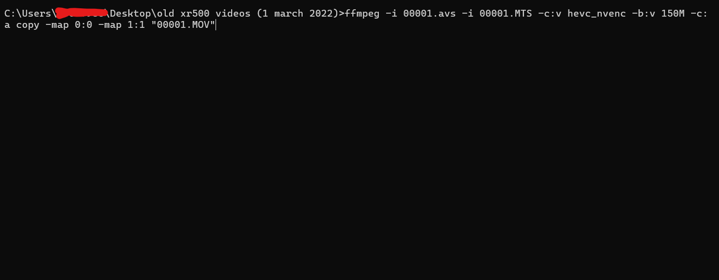

  3. post the command line used

    As stated earlier, the previous video (00000.avs/00000.MTS) went along fine at between 75-85fps with everything else remaining the same other than the input/output file names being different.
    Regarding the bitrate, I have my reasons for needing that, but again, the previous file (and other unrelated files) did not see this amount of slowdown (maybe I could make LSMASH decode with the GPU as well since apparently it will do that, I dunno, dumping encode duties on the GPU and having a ridiculous amount of threads for the rest of the script to prefetch with seems to have a significant speedup with everything else).
    Of note as well, I did work around this (today, like 30 minutes ago, 21 November 2024) by converting the MTS files to HEVC, which should be more difficult for my CPU (LSMASH) to work with regarding decoding duties, but now everything runs along at ~100fps? Same avs script. I'm confused, but I'll take that result even if it does require extra steps. Same ffmpeg input as well, except the second input is "00001.MP4" since I'm using my reencoded go-between HEVC file to "yoink" the audio from when I spit out deinterlaced video.

  5. You have second ffmpeg input set even in your first example though, as was pointed out. But no command line available, as was pointed out as well. So why are you expecting any answer?
