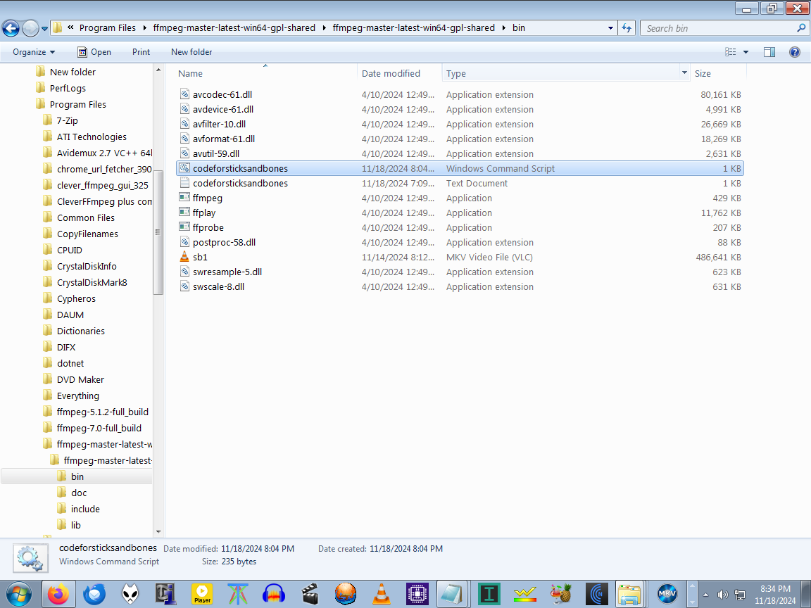

  3. one last screen shot... this is all the organization I can see in the ffmpeg bin folder.
    Mar 2008
    You could turn on file extensions so you can see the file types.
    Control panel/view tab/file (or Explorer) options/deselect "hide extensions for known file types"
  5. A good reminder. Thanks. I hardly know how everything got set to not show everything.

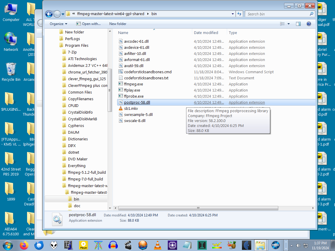

  8. Today I'm just adding a refreshed screen shot from davenext prompt on seeing file extentions below.
    If everything is in the right folder to run the cmd I've done all I can on it.
    If the ^ markings in the cmd mean that all blank spaces and such are ignored as pcspeak said, then the

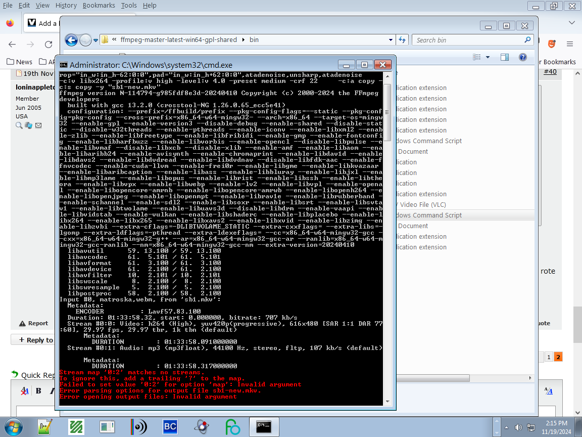

    Today I couldn't resist at least trying the new CMD. It executed a bit and then showed (in a blink) some red error text at the
    end. I'll add a screen shot of that. At least some of it appears to be working. The only thing I can do is follow instructions by rote on this.
    On the ffmpeg copy to syst32, I don't know if that is allowed without special permisssions.
  11. Progress
    Here is the screen shot of the new cmd2 which I ran from the ffpeg folder.
    You can see that the system 32 folder is where the cmd took place. I did not add or do anything in the syst32 folder.

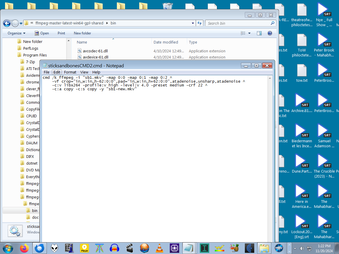

  12. The command in post 36 works ok for me. I think you have a copy paste error, since apparently map 0:2 matches no streams
    You can delete all the caret symbols and do 1 big line if you want
  13. At some point I will try it once more and maybe make a screen shot of the actual cmd text. Aside from that I can't do much if it is running for anyone else using what I have posted in the folder.
    I don't see why the cmd goes to sys32 or root in the execution shot. Anyway, other things to do today away from the PC.
  14. A screenshot of the actual text of the cmd:
Name:	sticksandbonescmd2 as text.png
