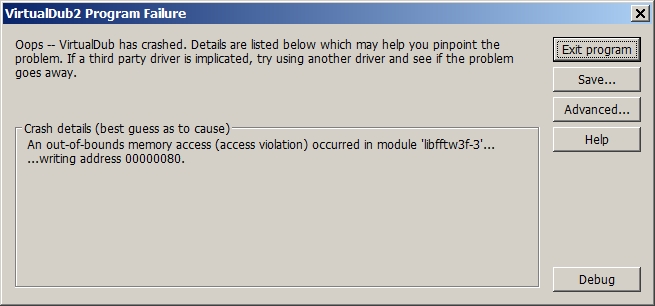

    Only 0,1&3 are setting for this. My 32-bit will only work with 0 & 1.
    #3 always gets an error about neo-dfttest.
    I have the .dll it just doesn't work with my OS.
    grainLevel is either 0 or 1 for my OS.
    2 freezes VDub2 & 3 gets an "Out of Memory" error.

    VDub2 now gets this error when I open the .avs file:
Name:	VDUB2 error.jpg
  28. Member
    Mar 2008
    Comment out the qtgmc and see if the script will at least run.
    Are you using 32 bit vdub2?
    Doesn't Tempraldegrain2 by itself remove the grain?
