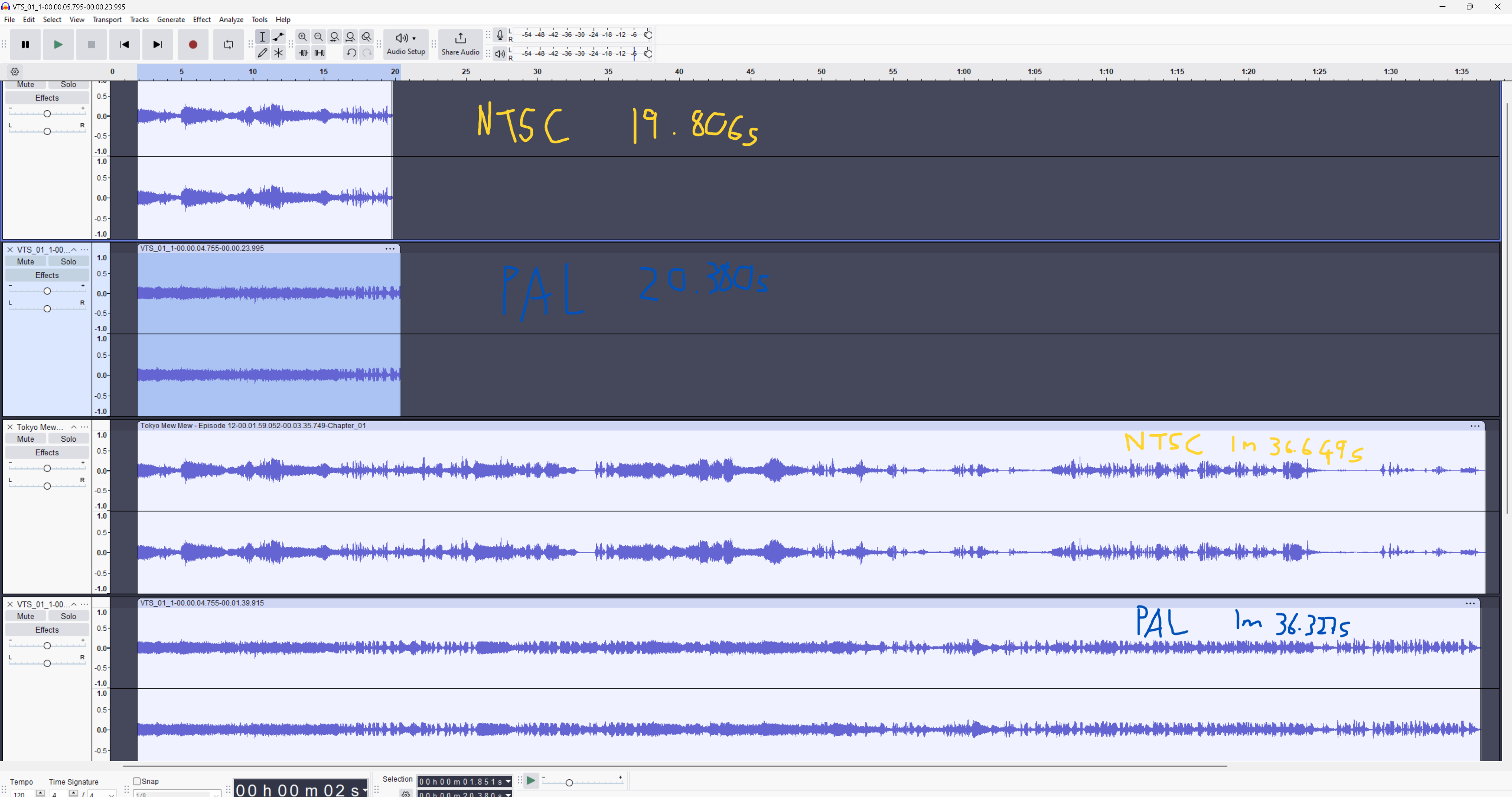

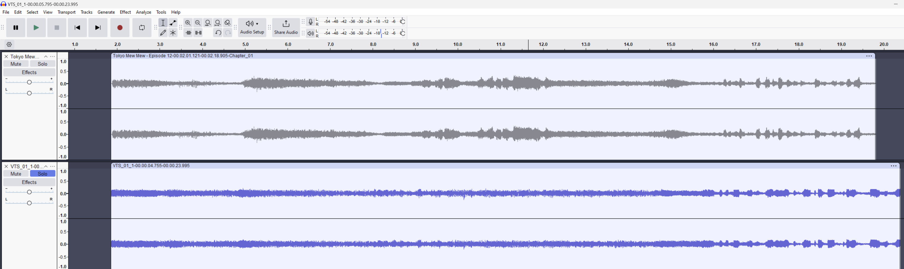

    So I just extracted the audio for both the PAL DVD and NTSC Blu-ray, synced them to start at the exact same moment and you'll notice the PAL DVD audio (Bottom Track) is slightly longer for the same scene.
    [Attachment 81112 - Click to enlarge]
    How can a 25 fps video have a longer runtime than the 23.97 fps NTSC?
    NTSC audio runs for 19.806s for selection
    PAL audio runs for 20.380s for the same section
    So the PAL audio is around 2.89% faster for this selection

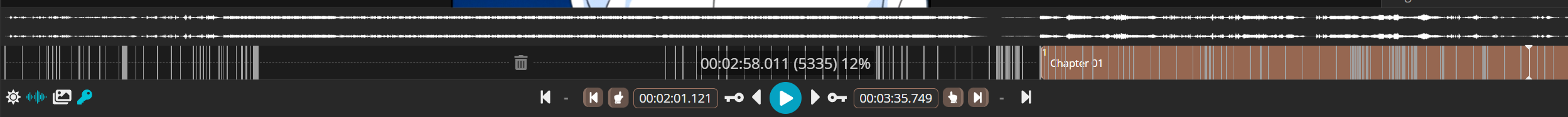

    The above clip is extracted from a longer uninterrupted scene. Both the PAL and NTSC have this scene unmodified in respect to each other.
    However, while in the above clip the PAL version is longer by 2.89%, the uninterrupted 1m 36s scene shares the exact same runtime between the PAL and NTSC versions.
    [Attachment 81113 - Click to enlarge]
    My only guess is that in the PAL version, extra frames have been added or dropped to sync the audio per key frame? Or is there another simple explanation? Could also be that in addition to the PAL conversion parts of the PAL audio were sped up or slowed to match the PAL frames.
    - NTSC has 2836 Frames for this section. Key frames are very irregular.

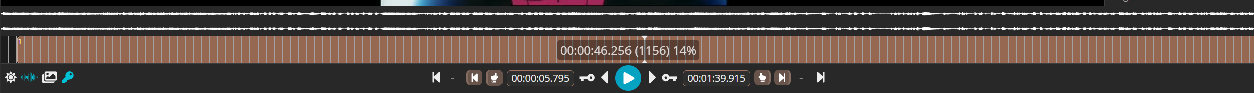

    [Attachment 81115 - Click to enlarge]
    - PAL has 2353 Frames for this section with evenly spaced key frames.
    [Attachment 81116 - Click to enlarge]
    Both are 8x zoom in LosslessCut
