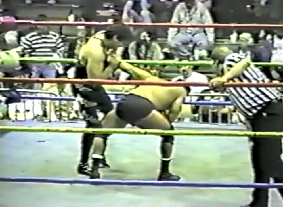

And if in doubt you can always add Info() to the end of the Avisynth script as it includes the frame rate, if that's your input video. If Avisynth reports 30000/1001 the script's frame rate is okay and you shouldn't have to worry about the frame rate MediaInfo reports. By the way, if you are using Avisynth for that video, it's possible to make the chroma slightly less horrible. I only had a quick play with it.
BWDIF(field=-1)
CropResize(0,720, 160,10,-168,-14)
[Attachment 80179 - Click to enlarge]
ShiftUVMod(uy=-4, vy=-4)
BWDIF(field=-1)
MergeChroma(Awarpsharp2(Depth=30))
[Attachment 80180 - Click to enlarge]Avisynth functions Resize8 Mod - Audio Speed/Meter/Wave - FixBlend.zip - Position.zip
