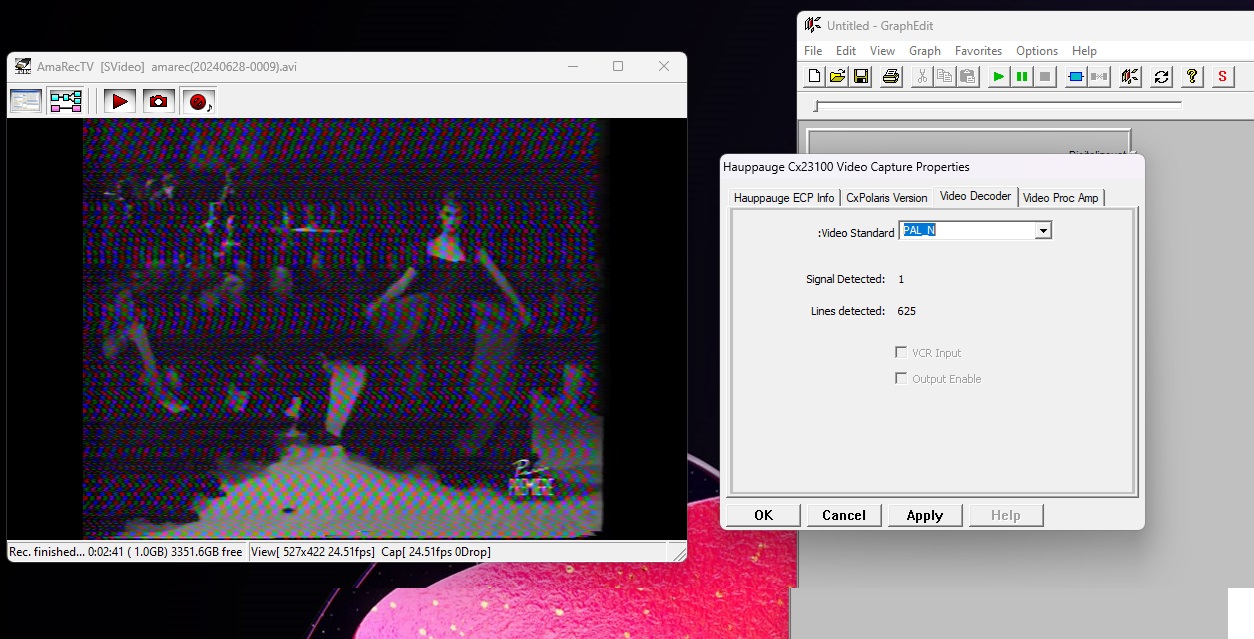

    wait guys, I think I know what you mean by odd colors. When I first connected my VCR to PC, i did get odd colors and that was due to SECAM tapes but streaming as PAL signal. Here is the thread:
    https://forum.videohelp.com/threads/408948-AmarecTV-not-receiving-correct-video-signal#post2686208
    Are those yellow images wrong colors you were talking about? Because if yes, then I do confirm that when I try to stream my SECAM tapes before 1996 as PAL via GraphEdit, I still get wrong colors. For VHS after 1996 the colors are funky, but for VHS before 1996 I get no color, only these rainbows across entire image (attached)... So i think transcoding from SECAM to PAL without passthrough will still not work for those old tapes...

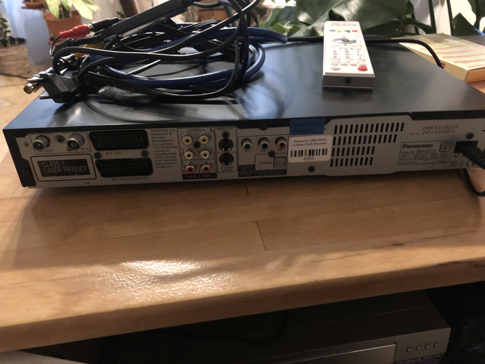

    Oh, Spicy. I asked ChatGPT if my ES-10 has FireWire port and ChatGPT did not disappoint
    I then took photos of the DMR (it looks similar to ES-15 photos on Ebay). Is one of these ports Firewire? I do not see DV-input anywhere...
    Otherwise, ill get the add-on card. thanks for providing me the link to the discussion <3

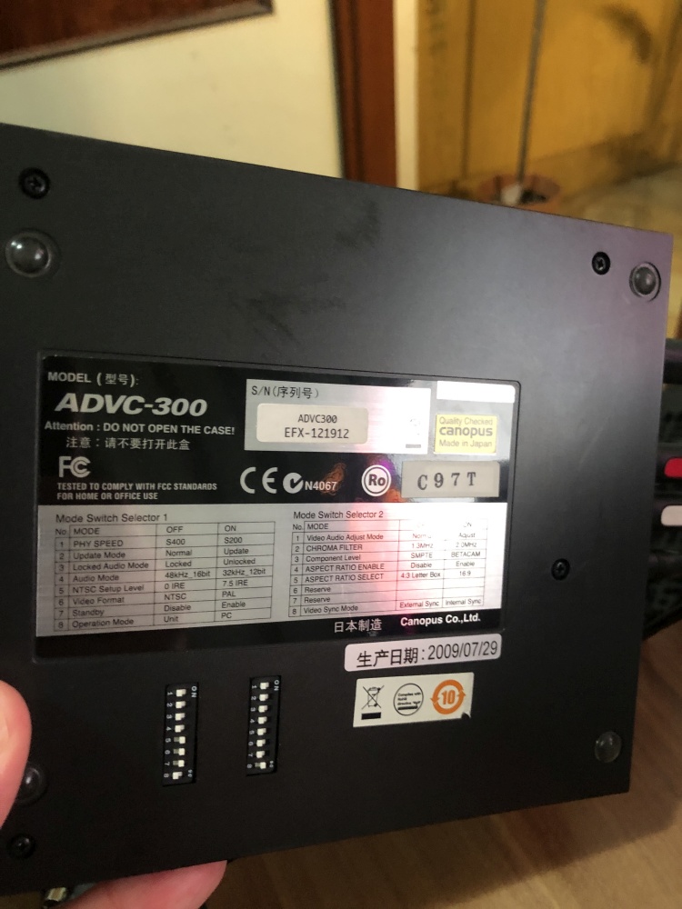

    For now, I can certainly state that the ADVC300 manual does show what hardware changes you must make to achieve this. Allow me a few hours since I have been travelling for much of this day. Some years ago I did post the ADVC300 manual to a topic. But I will find my own copy and show the settings required. Patience will always reward.
  25. Member DB83's Avatar
    Jul 2007
    I wanted to re-upload the manual but for some reason an AI error is generated.
    However, from page 18 the DIP switched SW1 are thus described :-
    No.5 NTSC Setup Level setting
    Allows you to set the black (setup) level. This switch is effective
    only in the NTSC format.
    OFF: 0 IRE ON: 7.5 IRE (North America, South Korea)
    No.6 Video Format setting
    Allows you to select video signal format.
    OFF: NTSC ON: PAL
    When both of No.5 NTSC Setup Level and No.6 Video Format are set
    to ON, the SECAM format is used.
    * At this time, the SECAM format is used for input and PAL format for
    output.
    Make sure your power is off before altering the switches. Hope this helps.
  26. Originally Posted by DB83 View Post
    OFF: NTSC ON: PAL
    output.
    Hey there,
    no worries about the delay. I was also travelling and only today got home again so thanks for taking your time and guiding me through this.
    I was also able to find online Canopus ADVC-300 manual here:
    I tried to set up my canopus today and had a series of small heart-attacks. At first, it did not want to start at all (had to press power 20 times) and when it started, it gave me red Status light for 30 minutes and no matter what i did, it did not go away. When i googled it, it said it found macrovision, but it did not make any sense, because it was giving me red light whether i was playing VHS or not.
    For some reason, it then stopped giving me red light and finally started giving me blue light instead.
    At the moment, I do not have firewire port yet, so i just tried to do s-video in and out using hauppague. I think someone here mentioned they got it working with S-video in and out, but amarectv received no signal even when red light was not on... Will canopus work without firewire as passthrough or do i need to get firewire afterall/use Canopus softwares, please?

  27. Member DB83's Avatar
    Jul 2007
    It should. My vcr does not support s-video but I have regularily used the ADVC for composite in and out. Of course, you can not get a s-video output if your vcr does not support s-video
    You have to be sure that you set the top button for analogue input - toggles between analogue and DV. Also depends if you use the ADVC stand-alone or with the canopus software.
    Do you have the manual ? If you do not I'll find another way to let you have a copy.
  28. Originally Posted by DB83 View Post
    Thanks a lot.
    So the setup VCR -> S-Video -> Canopus -> S-Video -> PC via hauppauge should work? Or should I also add DVR into the stream?
    On my canopus both DV/Analog are lit on and whether i press the top button, both lights are on and they do not switch between DV/Analog, so maybe that is the issue. Even when i press for 3 seconds, nothing happens.
    I was able to find manual online so I am using this
  29. Member DB83's Avatar
    Jul 2007
    Well you certainly should not have both lights lit. TBH I have never paid attention to this since I have always used the ADVC with the Picture Controller Software.
    Check DIP SW 8 to see if it is set to 'unit' or 'pc'. The analogue/DV toggle only works for 'unit'. In my scenario, invoking the Picture Contoller software sets the ADVC to analogue input.
    Do you have the Picture Controller software ? As with the manual, some years ago I also uploaded this to the forum.

    Thanks. I was testing this couple weeks back and did not get it working. Then i was on vacation and got back couple days ago and started to test again. I installed Picture Controller but it seems that it requires firewire port because it does not recognize Canopus via Hauppauge and wont launch without it. Plus it seems my Canopus is dead too, because i have to press start 20 times for it to start and when it starts, it keeps giving errors (red light). So I think that option is dead
    I talked to a person digitizing content and he mentioned that VHSDecode is a new experimental way to digitize (1 year only) and it allows to do TBC in computer even for Secam. So I am thinking of maybe getting VHSDecode as it seems to get better quality than regular digitizing via VCR/DVR.
