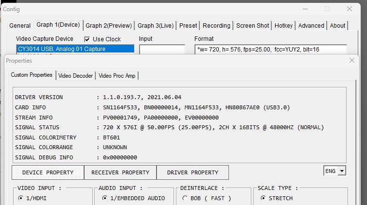

    The Startech USB3HDCAP will capture HDMI at 720x576i 25fps analogue from my Panasonic EZ-48 (VHD/DVD Combo) and my Panny EH-57 (DVD/HDD recorder).
    [Attachment 71823 - Click to enlarge]
    Both the Pannys require one of these splitters to defeat incorrect HDCP signalling to the HDMI output:
    https://www.amazon.com.au/dp/B091GG183D?ref_=pe_2361882_297267902_302_E_DDE_dt_1
    For what it's worth, given the alleged "straight through" nature of the digital signal, I can't see any significant difference between the HDMI capture and a normal analogue capture with any of the GV-USB2, USBLive2, USB-710 or USB3HDCAP in analogue mode. It feels cool doing an HDMI capture but it also cost $200 (USB3HDCAP) +$25 for a splitter verses $70 for a GV-USB2.
    Your mileage may vary with the flasher Blackmagic or Canopus cards.

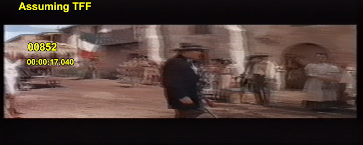

    The lossless Huffyuv looks flawed to me: Blended fields. See for example fields around #850 (attachment). Something went wrong it seems.
    The DV capture looks cleaner (apart from the expected DV compression artefacts). Less field blending. So my vote goes for the DV variant for this case.
    Maybe I am missing something?
    Edit: Just noted that the DV is also blended. Maybe the movie should have been IVTCed at some stage instead of poorly framerate converted?
    So this is just an example that the problems are usually somewhere else than with the subtle differences between DV or analog captures ...
    Anyway, everything about the topic has been said in post#2 already

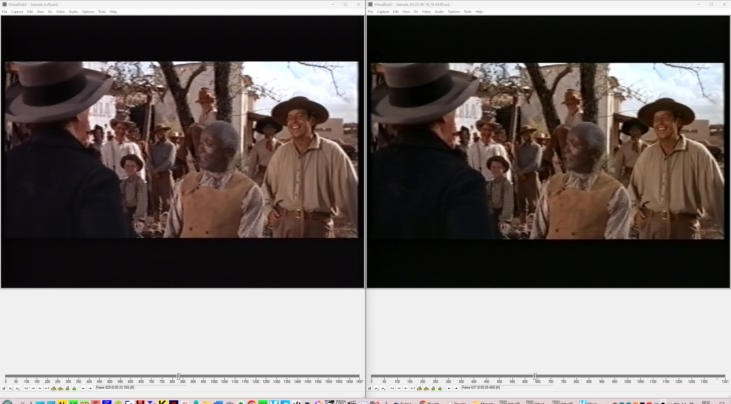

    To be of any value in this scenario, any comparison has to be using a D8 camera, not a VCR and an ADVC.
    Originally Posted by Marvolo
    Unfortunately, if both files are not in one video next to each other, I find it very hard to see differences if I have to watch them seperately in a new window.
    A technique I often use is to use 2 x Virtual Dub (or you could use 2 x VLC player, although frame-stepping with VLC is harder). I open each video in a separate instance, then drag one left to fill the left half of screen and drag the other right to fill the right side (or use Win 11's layout gadget at the top of screen). Use View>Pane layout>Input pane only. Then both videos will be exactly the same size. Then just drag the cursors around to match frames.
    [Attachment 71845 - Click to enlarge]
