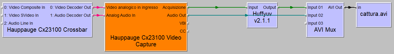

    However, when I press apply/ok, the video turns back to the old setting with yellow/purple tint...
    Open, in parallel with AmarecTV, GraphEdit, select the filter "Hauppauge CX23100 Video Capture" and in this module set SECAM.
    Attached an example; it's for a complete capture, you do not need it if capturing with AmarecTV, just to show you the right filter:

    Hello lollo,
    you are a true superstar and lifesaver... (literally). I tried your solution and it worked like a charm! I also did test recordings and the recordings are in correct color AND in much better quality than my Hauppauge capture. Thanks a lot for your help
    You should get a medal
