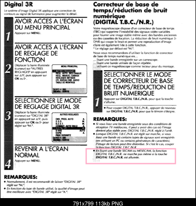

    Hi lollo,
    now that you were talking about TBC, it got me thinking. When i was buying my HR-S9700MS, i thought it had TBC mode that was working for SECAM tapes. When im looking at the manual - its in French (I dont speak French, but use google translate), it says the TBC does not work for MESECAM. (however, it should work for SECAM). I pulled out my VCR, triple checked it and realized that i did not turn on TBC when i was recording... [face palm] I attach re-recorded captures while TBC is on... it seems that the TBC function on HR-S9700MS actually works on SECAM tapes (i paid a lot of money for the VCR, so it better be). Do you think i still need DVR passthrough or do you consider it good as-is? Apologies for messing this up on my end.. im not a technical person, and i am very happy when i manage to plug the cables properly (it you read my other posts on this forum, you will find out that even such straight-forward task as plugging correct cables into correct ports can be very challenging for me)...
    Btw, i have couple more questions:
    1. im trying to set up huffyuv, but AmarecTv does not seem to support it... is there a guide somewhere it how to set up huffyuv in VirtualDub? I tried search option but no manual popped up for me.
    2. Is it better to use Virtual Dub 1.5 or VirtualDub2?
    3. In case i felt courageous & adventurous and actually got DVR, is the set up simple? Do i just plug the cables into input output ports and turn on DVR? or is it more technical than that, please?
    Thanks a lot for your help, and thanks for spotting the issue...
    Good for you. In my HR-S9500MS the TBC in not active with SECAM signals

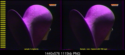

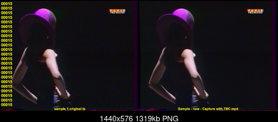

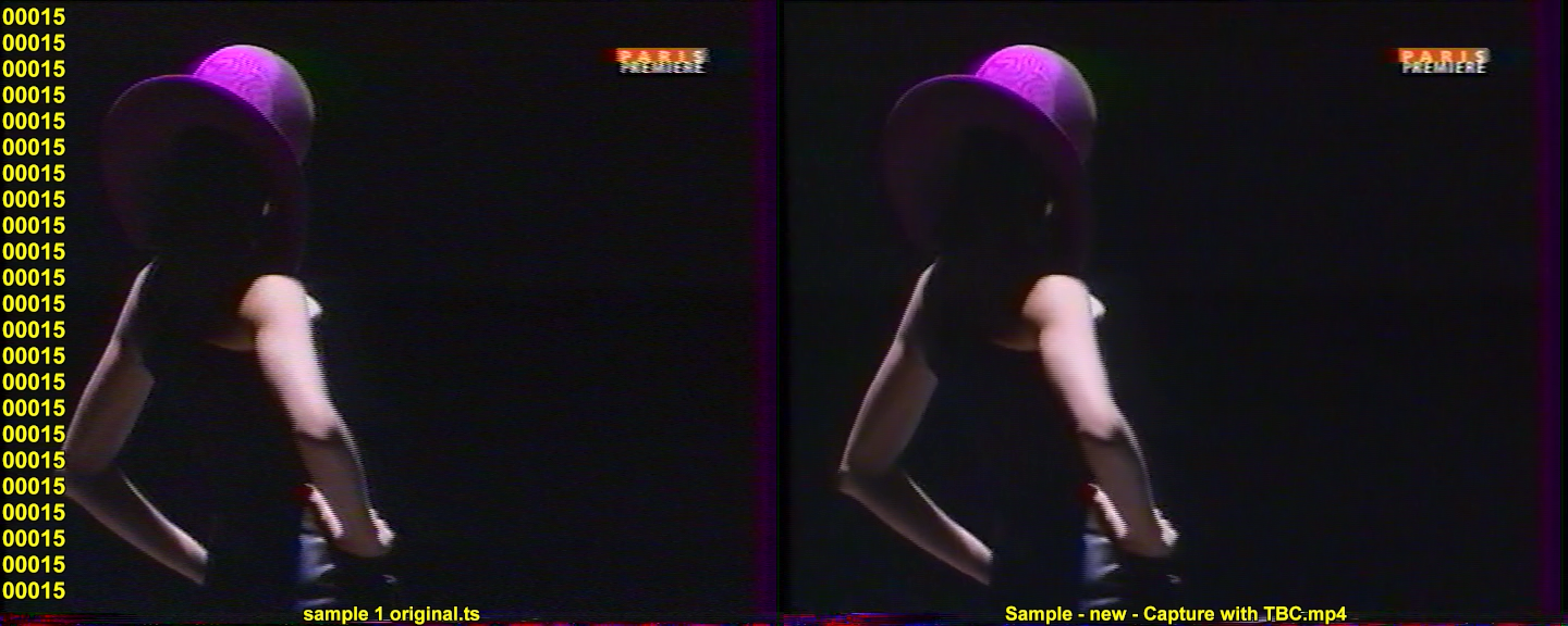

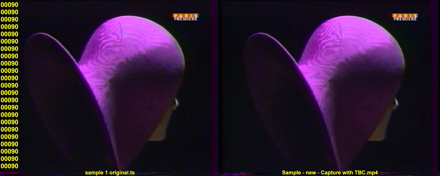

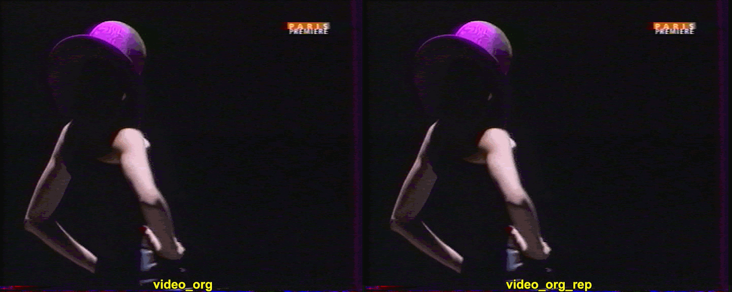

    Your new capture is ok. I learned something today: the lineTBC of the JVC is able to correct the horizontal shift! (which I never met). Thanks for reporting your results! (but your new capture is AVC, I do not know why; i hope you did not miss raw captures and processed captures).
    [Attachment 70265 - Click to enlarge]
    [Attachment 70266 - Click to enlarge]
    thanks, the horizontal shift is not totally perfect, i would say its 90% of the cases, but its a definite improvement. Definitely happy i do not have to manually fix the frames. And yes, my new capture but Lagarith avi file (which was about 400 MB for those 30 sec), so i downsized it to mp4 file for the size sake... but yeah, i do record in Lossless avi so all good...

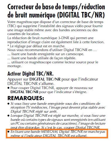

  12. [QUOTE=JadHC;2686466][QUOTE=lollo;2686220]
    Hey good find ! I just read the manual myself, maybe one of the few that support secam, report back asap
    To add more credibility, the manual of my hr-s8600MS specify the tbc will not work for mesecam and secam tapes
    Yes! We have been looking for a JVC S-VHS with TBC enabled for SECAM signal since longtime!!!
