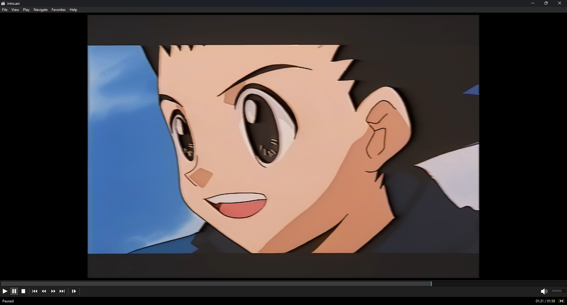

  1. I was doing some restoration on a VHS tape, and the resolution I was originally working with was 720x480. I adjusted this to 704x480 by removing the 8px black borders from both sides, and during the restoration process, ran an AI model that upscaled the resolution to 1408x960 (x2 of 704x480). I plan on burning this to blu-ray and wanted to add some black borders to get the resolution to 1920x1080.

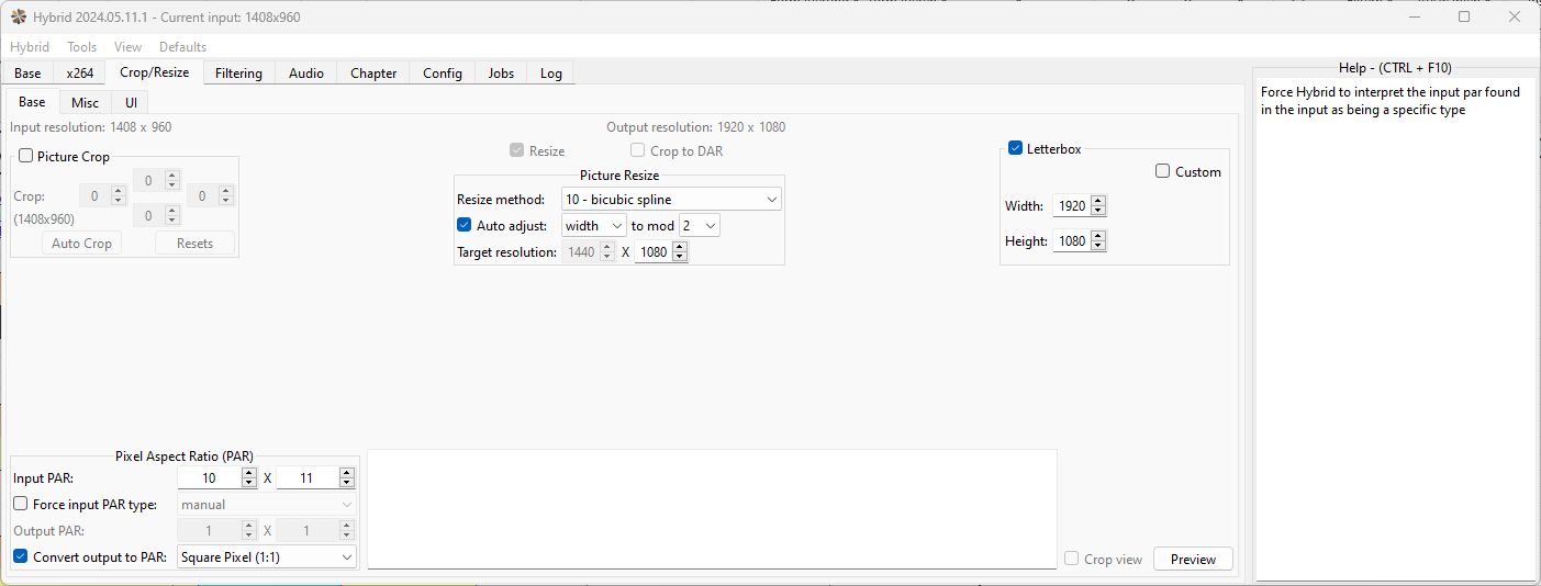

    I was wondering though, I know that 1408x960 (being x2 of 704x480) would have an AR of 4:3 and PAR of 10/11. But with the black borders I plan on adding to achieve 1920x1080, would that still hold true? Or would the AR/PAR be something else now? I'm currently using Hybrid, and these are my settings:
    [Attachment 79354 - Click to enlarge]
    Thanks for any help!

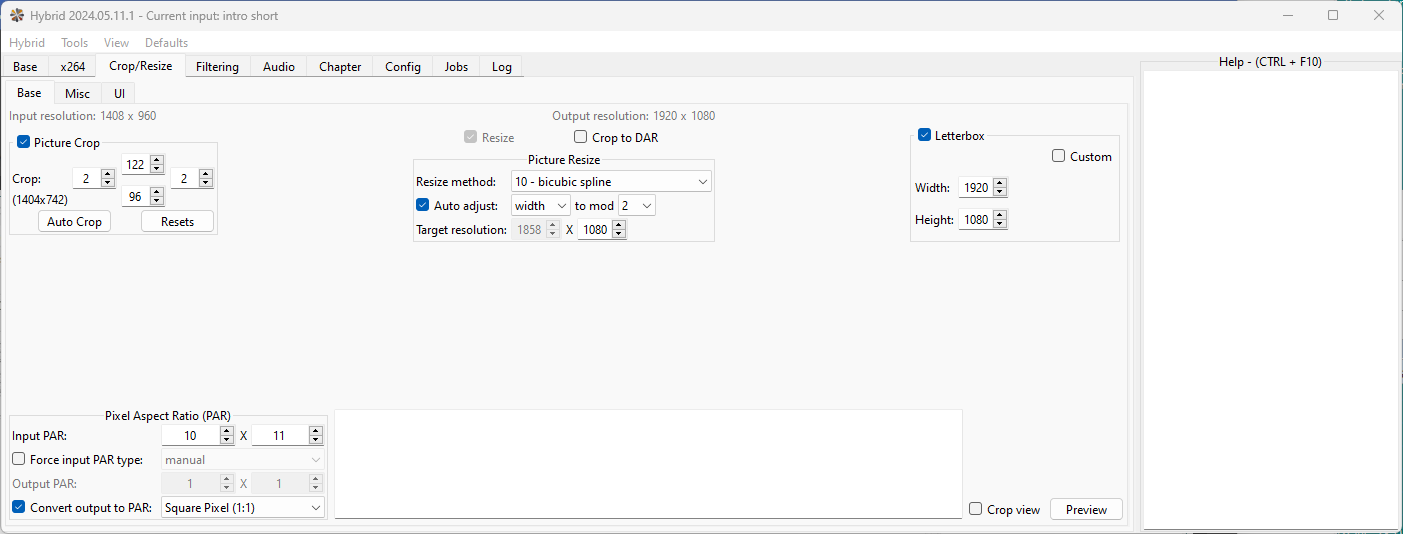

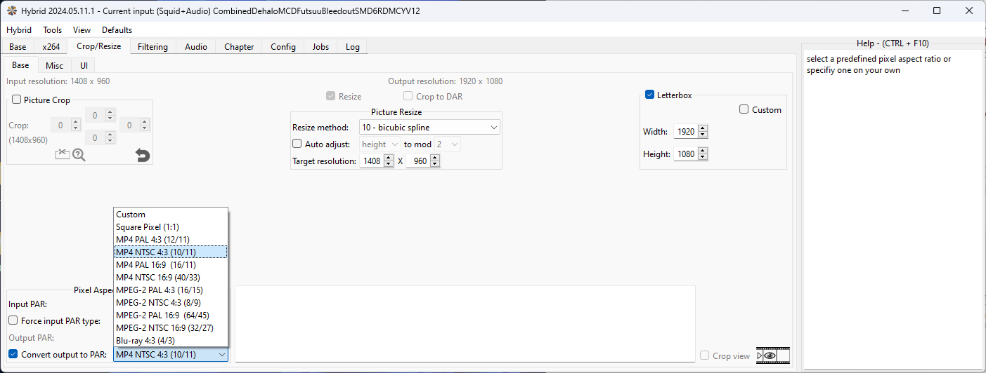

  4. In Hybrid try:
  5. Thanks for the help everyone! I've been spending tonight reading about upscaling 704x480 (and by proxy, my 1408x960 res) to 1440x1080, so that's definitely what I'll try to work for. I've seen this as the recommended approach for YouTube so that it doesn't compress the video as much. Is this also the recommended approach if I want to burn this onto a blu-ray and play it on TV?
    In Hybrid try:
    Appreciate it! I gave these settings a try, although it seems the picture is a bit narrower from my VHS capture, is that an intended effect?

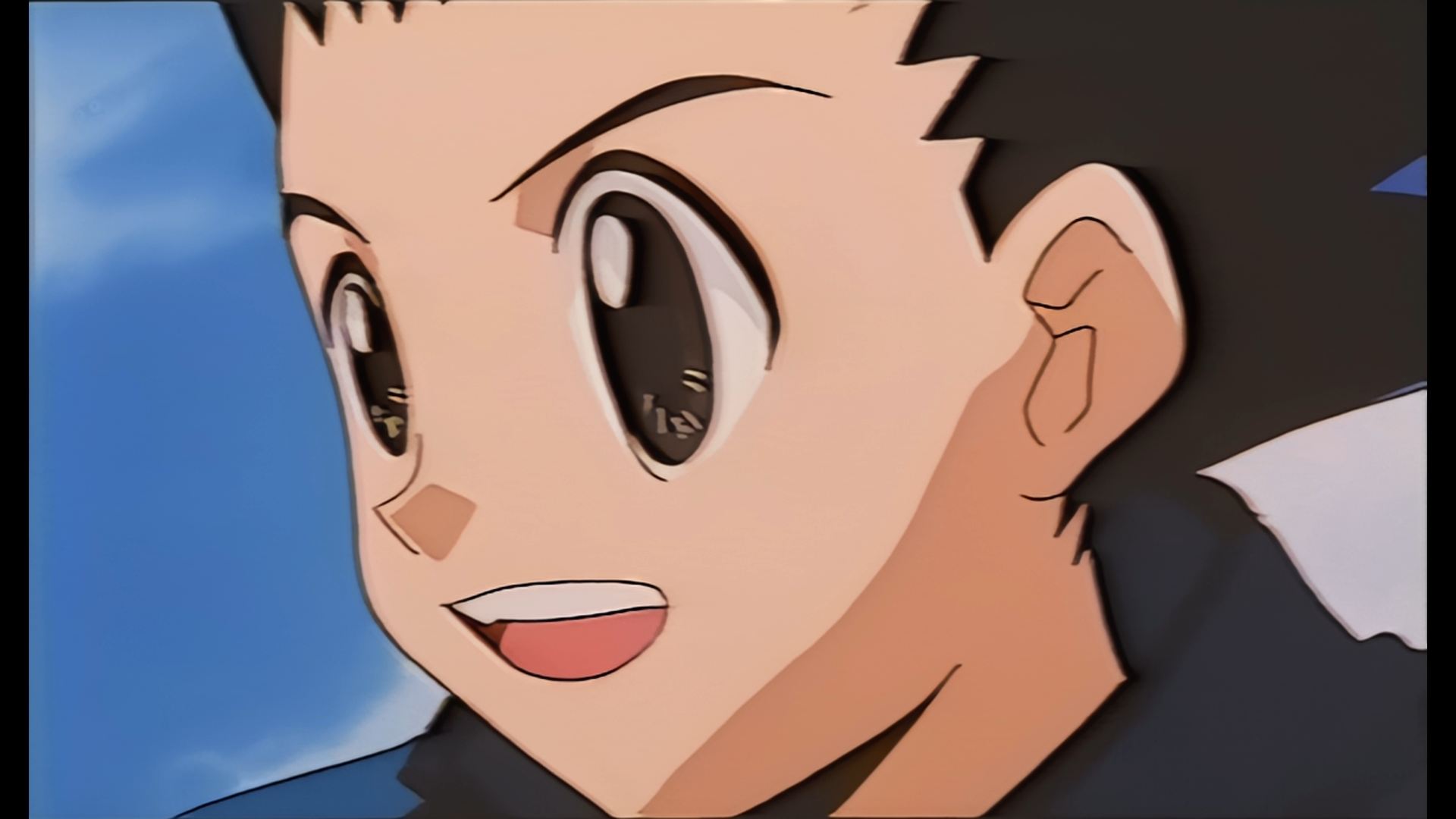

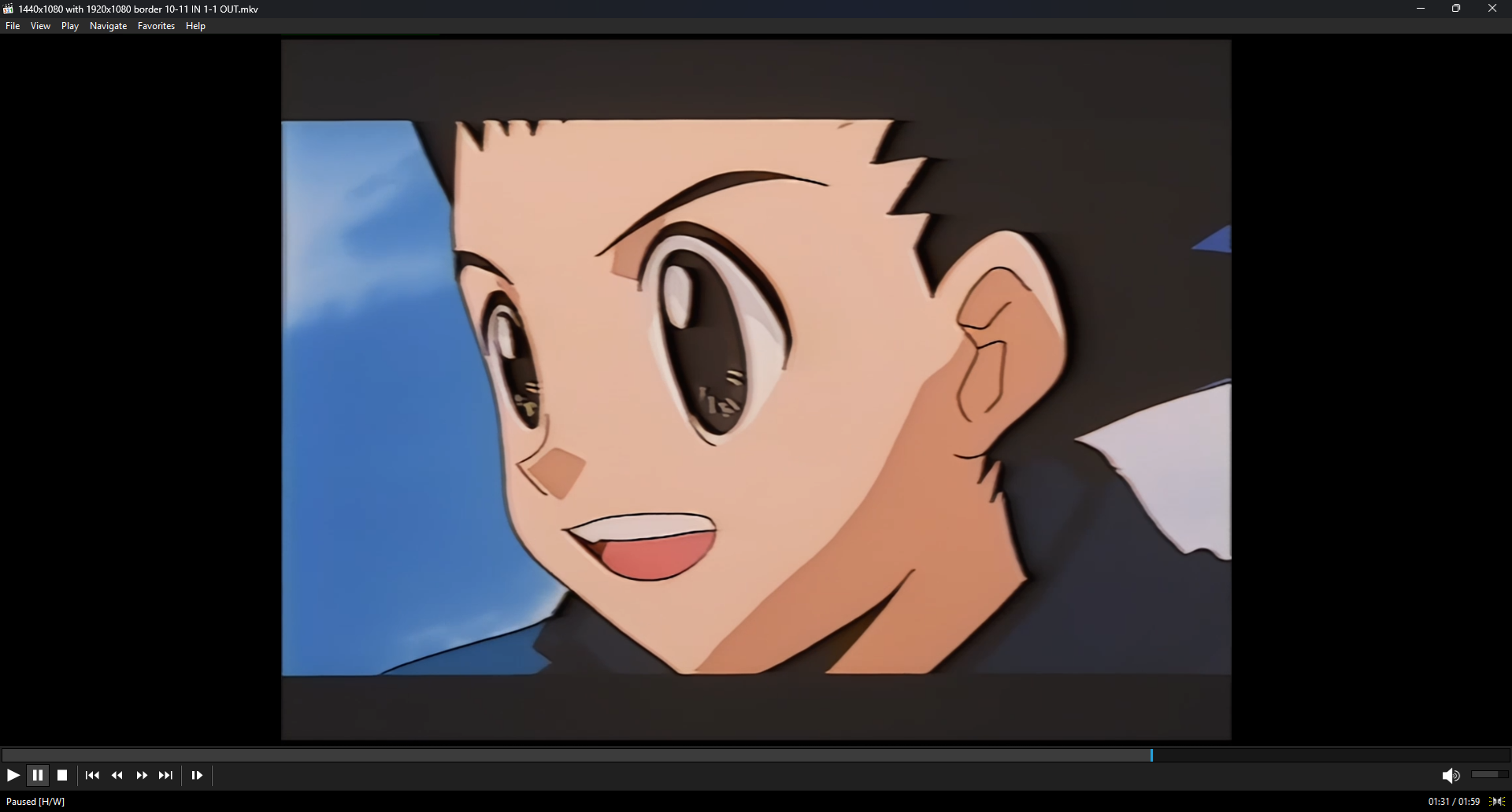

    Here's a screenshot of my VHS capture:
    [Attachment 79360 - Click to enlarge]
    From your recommended settings:
    [Attachment 79361 - Click to enlarge]
    I also went ahead and uploaded a small clip if that helps at all.

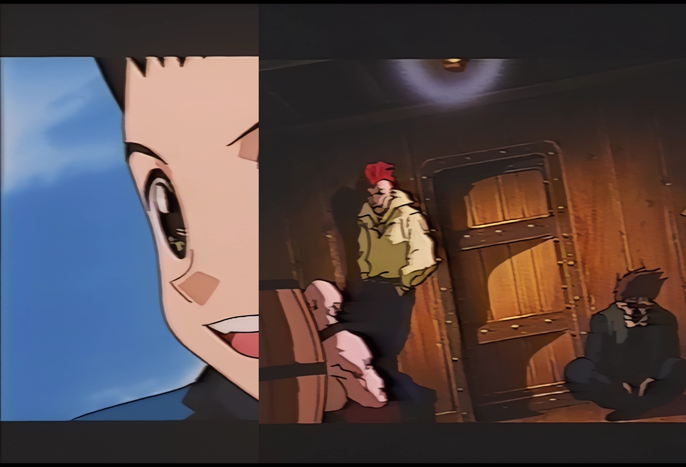

    Unfortunately I have to keep the borders on the top and bottom. They end up shifting up and down throughout the video, so a straight crop at one point could cause part of the screen to get cut off at another part in the video.
    If I were to keep the top and bottom borders, would you recommend a different approach at all? Thank you for your help!
    EDIT: Went ahead and included a picture showcasing the shifting top/bottom borders from two different scenes. Can kind of see how it's shifted downwards some:
    [Attachment 79364 - Click to enlarge]

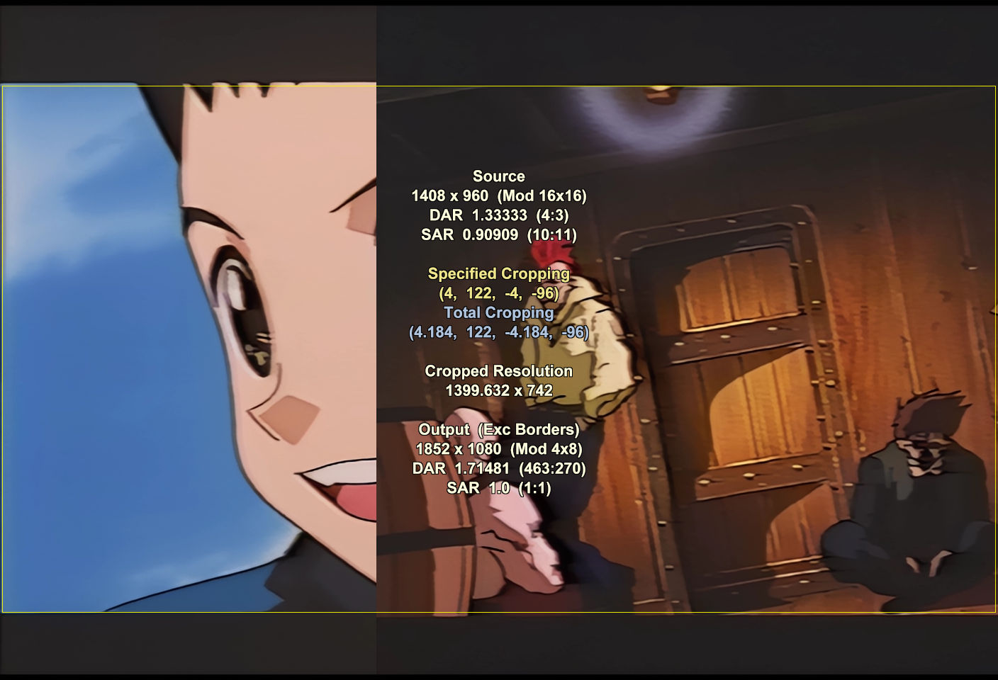

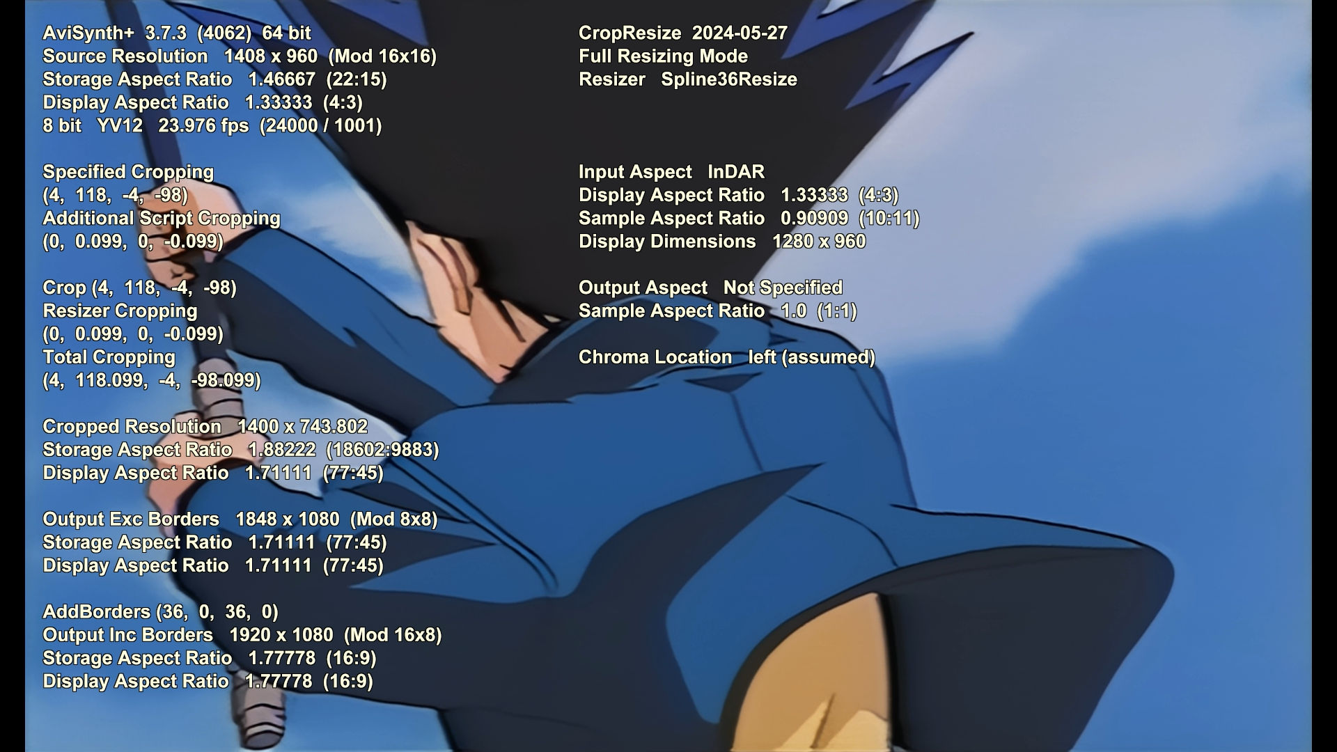

  10. I'd be cropping the top and bottom borders if your screenshot is anything to go by, as they're not always the same color. The borders on the left are dark grey, but why not have borders of the smallest possible size anyway? If you crop enough to remove the borders completely you'll lose a little bit of picture, but it wouldn't be enough for me to worry about. I'd also crop a few pixels each side to make the edges sharper, but that's just me. From your AVI sample:
    CropResize(1920,1080, 4,118,-4,-98, InDAR=4.0/3.0, Borders=true, Info=true)
    [Attachment 79370 - Click to enlarge]
    I don't know how much editing you can do using Hybrid, but if you were really keen and wanted to keep the maximum amount of picture, then based on your screenshot (and just making up frame ranges) you could go through the video manually and do something like this:
    A = CropResize(1920,1080, 4,118,-4,-96, InDAR=4.0/3.0, Borders=true)
    B = CropResize(1920,1080, 4,122,-4,-90, InDAR=4.0/3.0, Borders=true)
    A.Trim(0, 3562) + \
    B.Trim(3563, 7451) + \
    A.Trim(7452, 9554) and so on....
    Personally though, I'd just use a one size fits all amount of cropping. You don't lose all that much.
    A preview of how much picture you'd lose doing it that way, according to your screenshot:
    CropResize(1920,1080, 4,122,-4,-96, InDAR=4.0/3.0, Borders=true, CPreview=1)
    [Attachment 79374 - Click to enlarge]

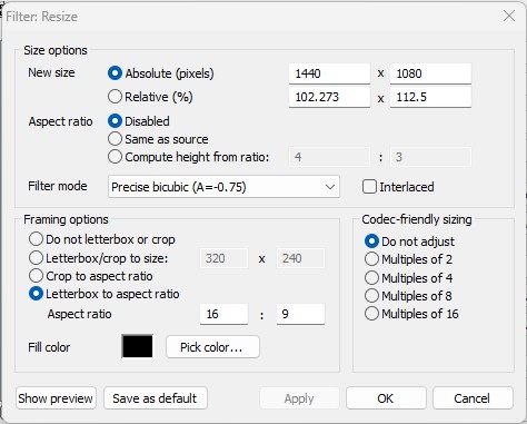

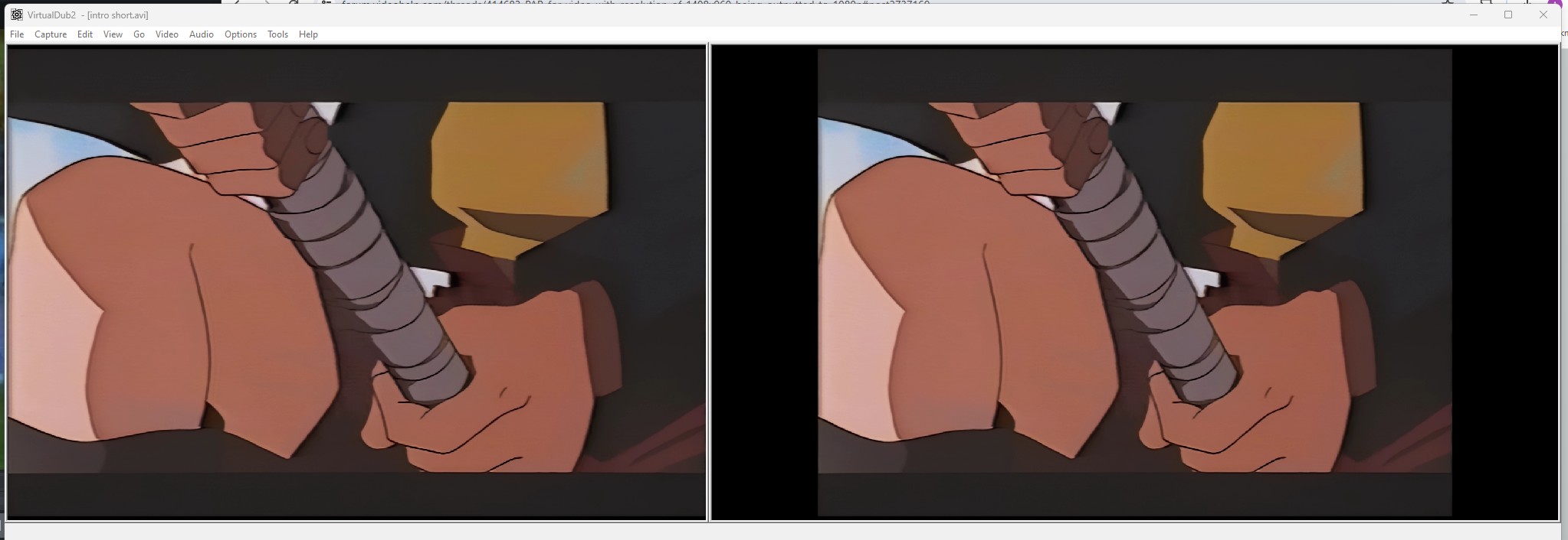

    I don't use Hybrid. VDub setup:
    [Attachment 79402 - Click to enlarge]
    Result on right (original and resized not to scale, obviously):
    [Attachment 79403 - Click to enlarge]

  26. Originally Posted by hello_hello View Post
    Originally Posted by wubikens View Post
    OK! So if all THAT sounds correct, I just have one more lingering question. 4:3 = 1.333...., 1440x1080 with a square PAR = 1.333.... but 16:9 = 1.777...8. The spec on the Wikipedia article specifies that 1440x1080 is supported at a DAR of 16:9. Could somebody help me understand how a SAR of 1440x1080 with square PAR comes out to 16:9? Unless of course, it changes the PAR from square to something else to get the 16:9 DAR. Is that the case?
    Anamorphic 1440x1080 displaying as 16:9 as per the Bluray spec, has a pixel/sample aspect ratio of 4:3.
    1440 * 4 / 3 = 1920
    1920 / 1080 = 16:9
    If you take any 16:9 video (1920x1080 or 1280x720 etc) and resize it to 1440x1080 it'll obviously look squished, but if you set 4:3 as the pixel aspect ratio it'll display correctly.
    Appreciate it! Thank you for explanation. This thread has been incredibly informative and I appreciate everyone's patience and time in explaining everything.
