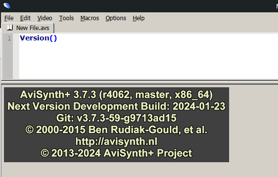

I'd suggest downloading 64 bit AvsPmod for creating and previewing Avisynth scripts. Open AvsPmod and type "Version()", without the quotes, into a new script. Enable the preview and if you see the Avisynth version information displayed, it means the installed AviSynth+ is working.
[Attachment 78965 - Click to enlarge]
