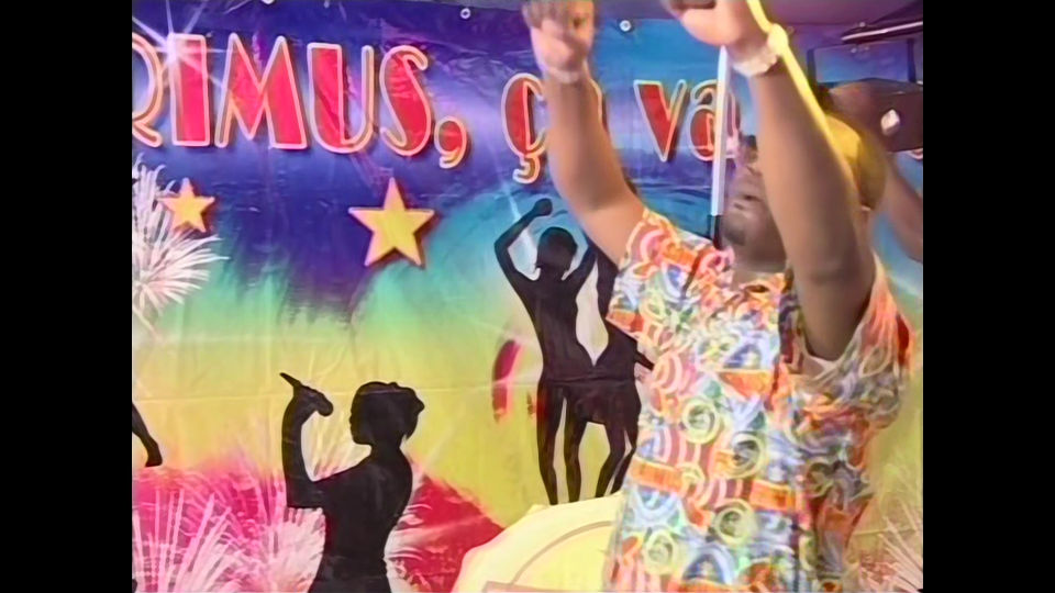

    Now I am working on a new video from the same DVD series (attached below), but on the recent volume the videos are different. No need to stretch the image as I can determine. But what are the correct values then for the upscaling? I assume it should be targeted to 1350x1080 to avoid stretching. But maybe I am wrong.
    I also tried adding a letterbox to the 1350x1080 image with the following code: AddBorders(285, 0, 285, 0). But when I add it there is an error reported: AddBorders:YUV image can only add by Mod 2 (left side)
    This was the code previously for this project, this one should be modified to match the image size of the attached video better:
    LWLibavVideoSource("Primus.mpg", cache=false, prefer_hw=2)
    ColorMatrix(mode="rec.601->rec.709")
    QTGMC()
    Dehalo_alpha(rx=2.0, ry=1.0, darkstr=2.0, brightstr=2.0)
    SMDegrain(thsad=1000, tr=3, prefilter=4)
    nnedi3_rpow2(2, cshift="Spline36Resize", fwidth=1280, fheight=720)
    aWarpSharp2(depth=5)
    CAS(0.5)
    nnedi3_rpow2(2, cshift="Spline36Resize", fwidth=1920, fheight=1080)
    CAS(0.5)
    prefetch(4)
  12. You should crop the source to 704x576, then upscale to 1440x1080. Add 240 column black borders at the left and right if you need a 1920x1080 frame size. Otherwise leave it at 1440x1080.
    Crop(12,0,-4,-0)
    QTGMC()
    nnedi3_rpow2(2, cshift="Spline36Resize", fwidth=960, fheight=720)
    CAS(0.5)
    nnedi3_rpow2(2, cshift="Spline36Resize", fwidth=1440, fheight=1080)
    CAS(0.5)
    AddBorders(240,0,240,0)
    prefetch(4)

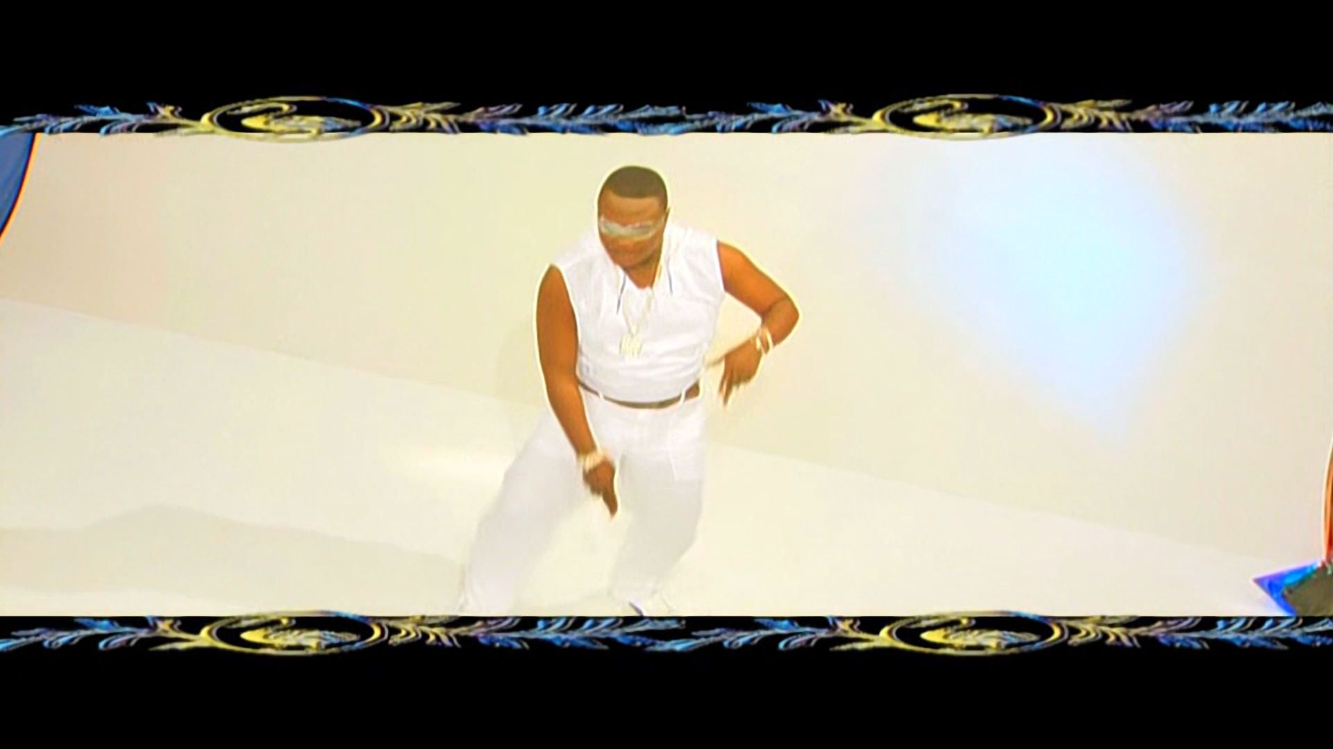

  13. It looks like the "Gambala cut2" video is flagged as 4:3, but it's wrong.
    If it has a 16:11 pixel aspect ratio, by the time you crop the crud it's virtually 16:9, so I wouldn't bother with borders and just crop it to 16:9. There's a sample encode attached.
    Crop(10,0,-6,-0)
    QTGMC()
    ColorMatrix(mode="rec.601->rec.709", clamp=0)
    CAS(0.5)
    nnedi3_rpow2(2, cshift="Spline36Resize")
    CropResize(1920,1080, 12,8,-10,-4, Resizer="Resize8")
    CAS(0.5)
    Edit: I didn't initially realize jagabo was replying to your question regarding the "primus part" sample in his post above. I missed that you'd asked about a second video. The "primus part" sample is definitely 4:3.
    If it was me, I'd still crop a bit more to clean the picture edges and remove the crud top and bottom though.
    Crop(10,0,-6,-0)
    QTGMC()
    CAS(0.5)
    CropResize(1920,1080, 20,8,-10,-6, CropDAR=4.0/3.0, Resizer="Resize8", Borders=true)
    CAS(0.5)

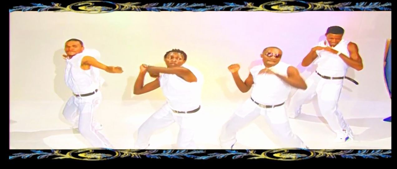

  19. They definitely look too thin at 4:3. But they look too fat at 16:9. Half way in between looks about right.
    Mar 2008
    Yes, it's a matter of judgement, this looks closer to me
    nnedi3_rpow2(2, cshift="Spline36Resize", fwidth=1040, fheight=720)  # this one not so important but trty to match ratio
    CAS(0.5)
    nnedi3_rpow2(2, cshift="Spline36Resize", fwidth=1560, fheight=1080)  # increase the width
    CAS(0.5)
    AddBorders(180,0,180,0)  # reduce the L/R borders to account for increased width above to still give 1920/1080

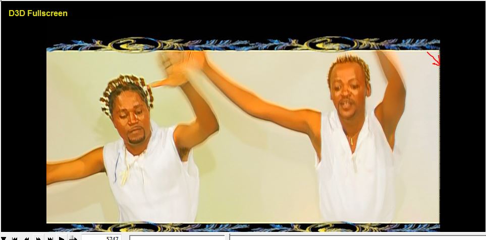

    Thanks! The other problem I noticed with this is that there is some artifact on the right side of the image. It is a few pixels in width. What is the proper method to crop that? I tried using crop plugin before, but it behaved so chaotic that I do not understand at all how it works. Not as I expect. But maybe this is what should be added?:
    Crop(0,0,-4,-0)
    [Attachment 80124 - Click to enlarge]
    The artifact disappears when adding this but I am not sure whether I should also apply cropping the same amount from the left side as well?
  22. I didn't see that noise in the sample video. But yes, Crop(0,0,-4,-0) removes 4 columns from the right side of the frame.

  24. You guys must be on much better drugs than I can get at the moment. I'm sure it's 16:9.
    Bencuri,
    You might want to try this function while playing with Avisynth's cropping.
    https://forum.videohelp.com/threads/395870-Avisynth-and-VapourSynth-cropping-preview-functions
    I cropped a bit more from the sides as the amount of crud increases and decreases, especially on the left side.
    "Obligatoire_part.mkv"
    QTGMC()
    CropResize(1920,1080, 20,0,-10,0, InDAR=16.0/9.0, Resizer="Resize8", ColorMode="601-709")
    I tried to resist but Avisynth has a crop function, there's stuff that shouldn't be in the frame and culling most of it reduces the size of the letterbox borders. Everybody wins.
    "Obligatoire_again.mkv"
    CropResize(1920,1080, 100,0,-50,0, InDAR=16.0/9.0, Resizer="Resize8", ColorMode="601-709")
  25. Member
    Apr 2012
    Hungary
    Bencuri,
    QTGMC()
    It is interesting because I did have some feelings that the frame could be wider sometimes, but other times it seemed to be proper. I looks however as if the frame size would have differed originally between certain scenes. I know these guys on the video and sometimes their face has the proper shape, sometimes not. Maybe there was some chaos during the editing. Yo don't have the full video, of course, but I have and the frame size does seem to be chaotic. The version that jagabo shared seems to be a good compromise, but I need to do a full reconverting tonight, so I will test yours as well. Because for fist sight it seems to be fine. Thanks!
  26. Member
    Apr 2012
    Hungary
    Bencuri,
    QTGMC()
    I tried it, and your sizing seems to be correct, except for the parts are mentioned. But that is not your fault, as I said the sizing seems to vary at certain scenes. In case of the sample it is at 0:10. For that scene your sizing results in overstretched faces. However the problem was that I cut a part where this is not very obvious. That scene repeates a few times in the complete video, and at other points it is much more visible, in the example not that much. But the whole clip has varying sizing, and I see now that was that confused me as well. Here is an example:
    [Attachment 80227 - Click to enlarge]
    However I do not see the difference in your samples. How do the two differ, I don't get it?

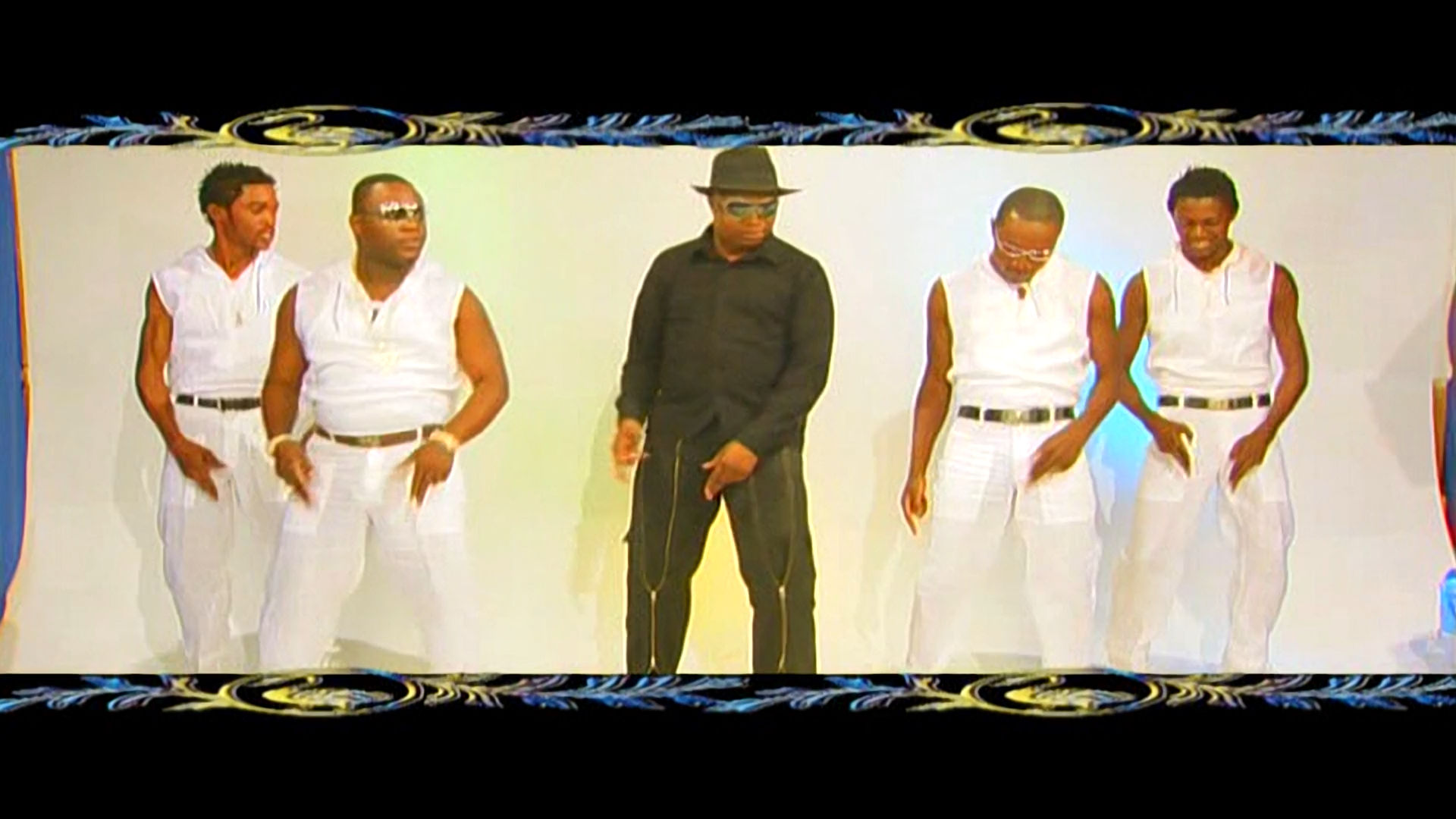

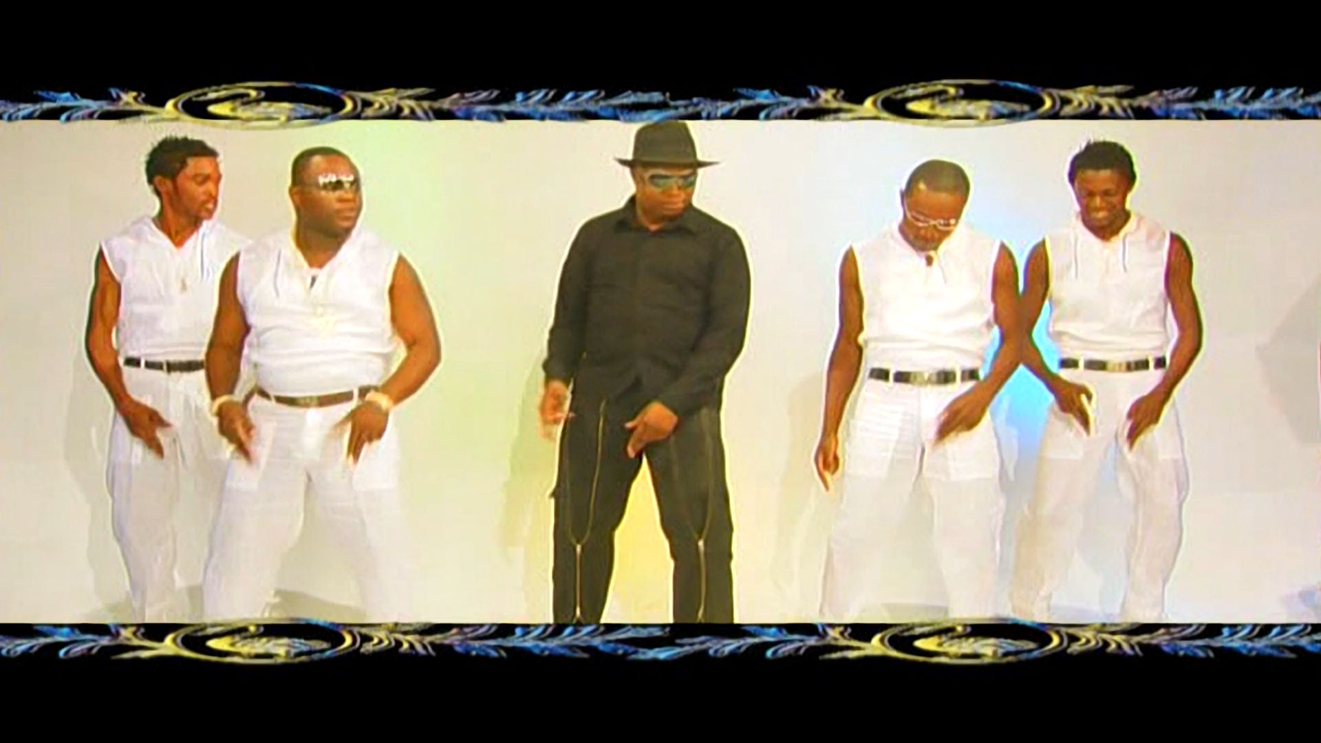

  29. Originally Posted by Bencuri View Post
    I cropped more from the sides of the second one which means the function cropped a bit more from the top and bottom to compensate, zooming in a little. You can see past the edges of the white backdrop on both sides in the very first frame. I seem to have deleted the original so this is the first frame of first sample.
    [Attachment 80228 - Click to enlarge]
    Same frame, second sample.
    [Attachment 80229 - Click to enlarge]
    I doubt the sandbags holding the backdrop in place were included in this shot for artistic reasons (bottom right corner), although you never know....
    I think it's the only shot with anything like that remaining in the second sample but it'd probably crop away too much picture in other shots to get rid of it.
    [Attachment 80230 - Click to enlarge]
    None of that would've been seen back in the says of CRT TVs due to over-scanning.
    https://en.wikipedia.org/wiki/Overscan
    Even modern TVs probably still over-scan more often than not unless you disable it. Mine's a plasma so it's fairly old but I'm pretty sure it over-scans by 5% unless you tell it not to, aside from viewing free to air TV when you can't disable it. I don't think it's called over-scanning in it's settings, but I can't remember exactly.
    I know what you mean about stretched looking faces in the screenshot you posted but I think it's just a perspective thing due to the angle. It's hard to tell but at least at 16:9 it doesn't look like they all have eating disorders.
