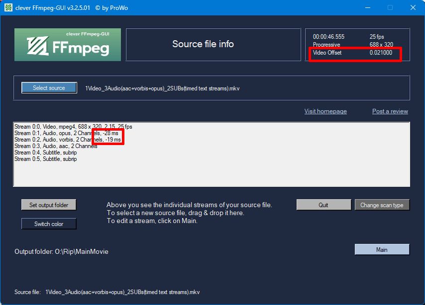

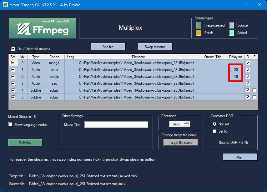

  2. Try clever FFmpeg-GUI, then you will have more information about the individual stream durations and any delays.
    You can also use it to extract, re-encode and mux all or individual streams.
    [Attachment 77914 - Click to enlarge]
    [Attachment 77915 - Click to enlarge]

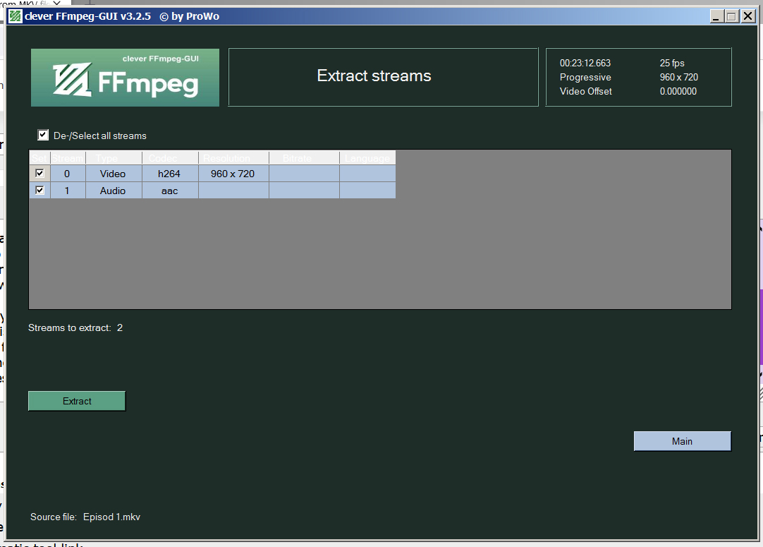

    Thanks for replying. I tried it, but it ends up the same way in that software too.
    For example this one file I have, it's 23 minutes and 12 seconds long. After I extract the streams in clever FFmpeg-GUI, I end up with an *.aac audio file that is only 23 minutes and 9 seconds long.
    When I open the file in clever FFmpeg-GUI, it doesn't display any delays or as much information as the file in your example (see my attached image).
    [Attachment 77927 - Click to enlarge]
    What I'm trying to do is use the extracted audio when editing a different video in another video editing software, but the audio needs to be the exact same length as the original.

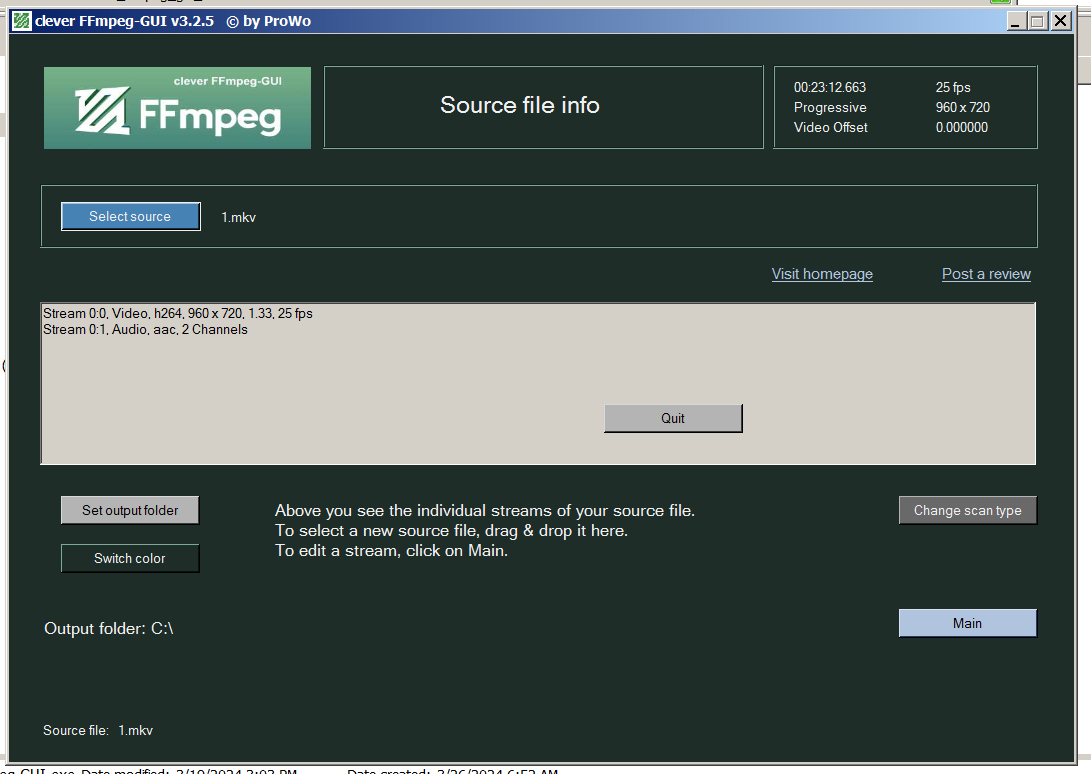

    Well, the video is 23 mins and 12 secs so the audio should be the same. Also, the extracted 23 mins and 9 secs file cuts off at the end before the song that is playing has a chance to stop so it's definitely not complete.
    I can't see anything about an audio delay within FFmpeg. Is this the correct screen (the start windows)?
    [Attachment 77931 - Click to enlarge]

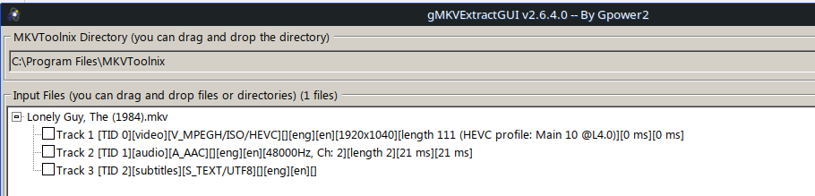

    It's possible for the video stream in an MKV to have a delay. You can check it with gMKVExtractGUI.
    gMKVExtractGUI writes the audio delay to the file name of the extracted audio, but it's always the delay relative to the video, not necessarily the absolute delay. The idea being that often the video is re-encoded so any video delay would be lost. If there is a video delay and you're keeping the video, the delay written to the extracted audio will be incorrect, unless.....
    I generally check MKVs for a video delay and if there is one, I remux the MKV while applying the necessary delay so the video no longer has one, and I also apply the same delay to the audio and subtitles etc so the A/V sync doesn't change. For example, if the video stream has a 46ms delay, I'd apply a -46ms delay to every stream and remux.

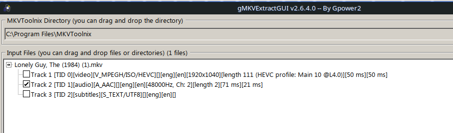

    Here's an example of a MKV with a video delay of 50ms. The audio has a delay of 71ms so the audio delay relative to the video is 21ms (that's what gMKVExtract would write to the extracted audio's name).
    [Attachment 78168 - Click to enlarge]
    After applying a -50ms delay to each stream and remuxing.
