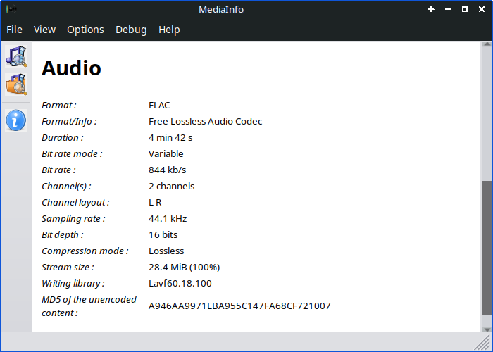

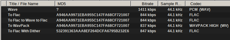

  8. foobar2000 calculates an MD5 when converting to a lossless format. Either that or the codecs do it themselves. The MD5 isn't saved for a wave file, but you can convert from wave to flac to wave to flac and the MD5 shouldn't change. The MD5 is calculated on the uncompressed audio, so you'd need to convert to flac, back to wave and then back to flac to know the audio hasn't changed due to the flac compression.
    [Attachment 75826 - Click to enlarge]
    [Attachment 75827 - Click to enlarge]
