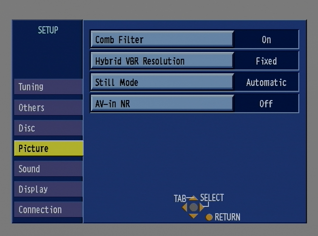

    All of my videos suffer from pixelation which is probably due to my Panasonic DMR-EH55,
    Correct.
    that price scalpers are now selling for $300 (I got mine for $30 and was incredibly lucky).
    Such a ridiculous statement. MSRP on those was $300+, and it takes effort and money to make them still work properly 15 years later. Your random thrift store find is not a barometer for costs.
    If that looks like crap then there's little that I can do about it.
    You can do plenty, with effort, with some budget. Thus far, you choose not to. That's fine, your choice. But don't get pissy when it gets pointed out to you.

  29. Originally Posted by Ferrari420 View Post
    Samsung DVD-V70 6 Head DVD/VHS Player - via RCA -> Panasonic DMR-EH55 DVD Recorder - via SCART to S-Video adapter -> Diamond VC500 -> PC
    As you have to use the 'Composite OUT' (RCA) of the V70 VHS player make sure to enable the Comb Filter in the EH55.
Name:	Screenshot 2023-12-28 131137.png
  30. The comb filter is on on my EH55
