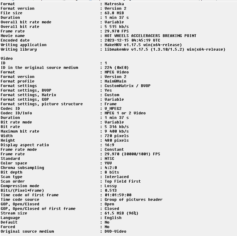

    when viewing the preview I see repeating frames that jump back and forth throughout the video. I'm not sure what could be causing this, for reference, here is the mediainfo on the MKV file I am working with.
    [Attachment 75560 - Click to enlarge]

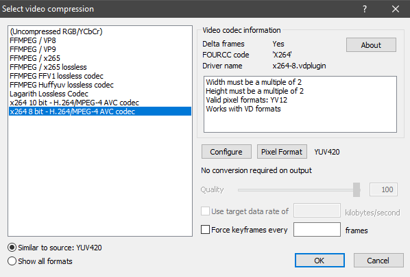

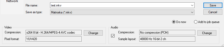

    EDIT: These are my export settings within virtualdub2
    [Attachment 75573 - Click to enlarge]
    [Attachment 75574 - Click to enlarge]

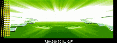

    By opening this script in VirtualDub and moving frame-by-frame you see that the even and odd fields of the frame you mentioned refer to different moment in time, like in interlaced fields, leading to a "combing" in that frame; but there is no overall "interlacing" across the whole structure.

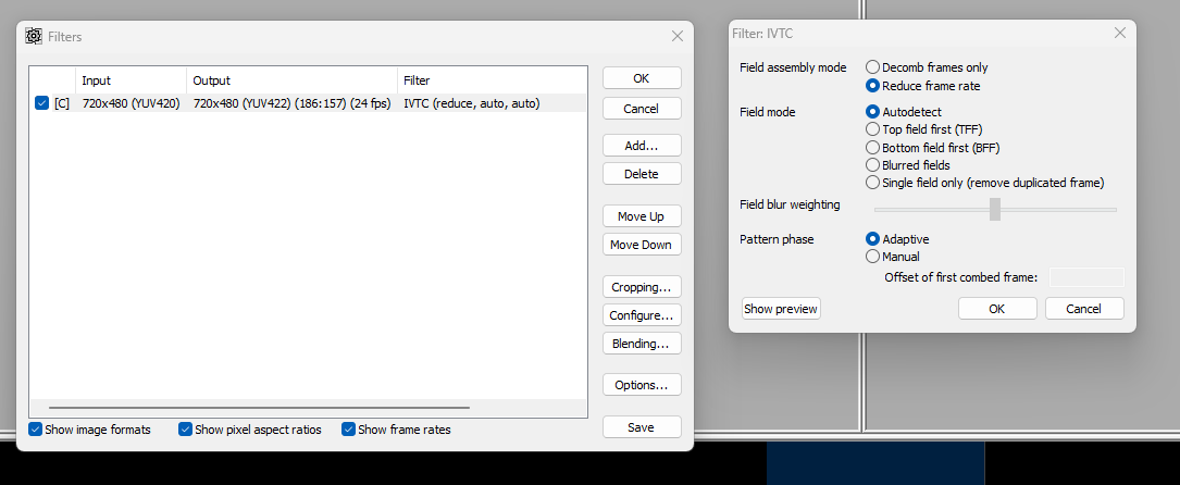

    Btw. you can Inverse Telecine in Vdub2 using its IVTC filter:
Name:	Screenshot 2023-12-18 091052.png

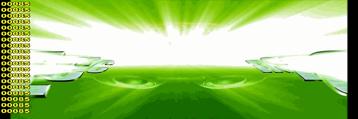

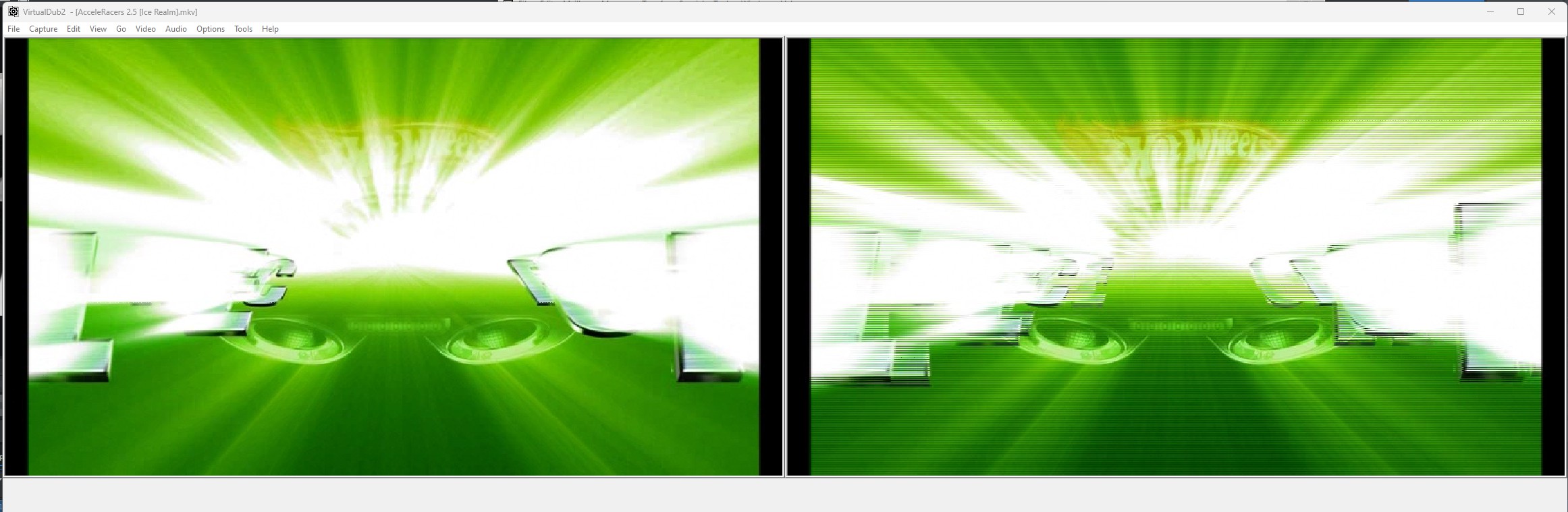

    I did try that (using different settings to you) but even with your settings, the AVISynth result is miles better.

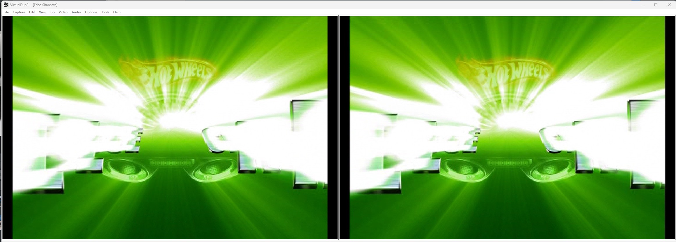

    My VDub attempt:
    [Attachment 75593 - Click to enlarge]
    Your AVISynth (ignoring aspect ratio):
    [Attachment 75594 - Click to enlarge]
