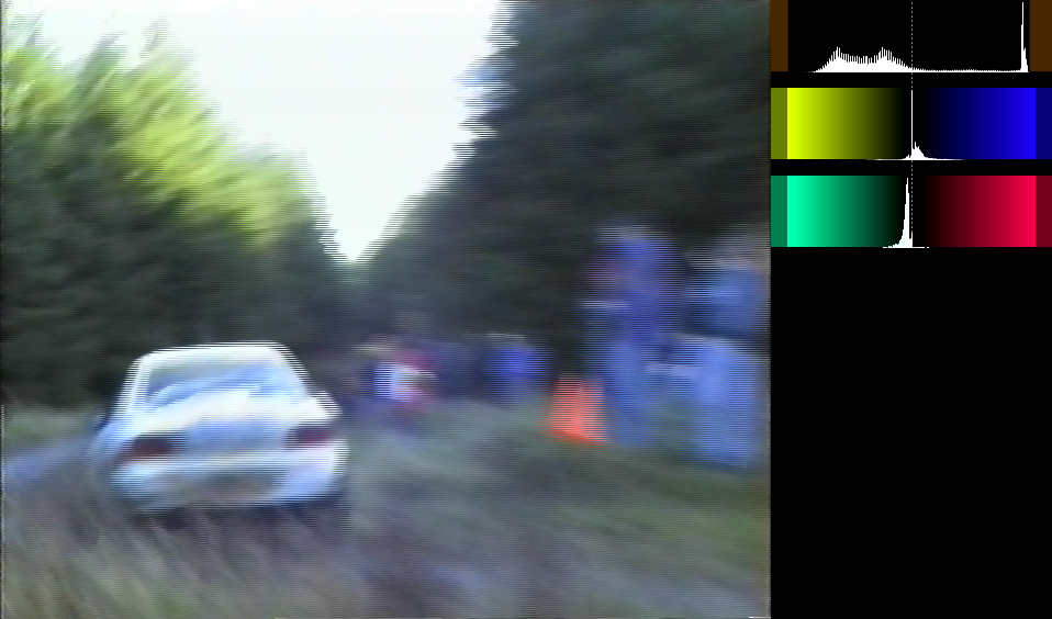

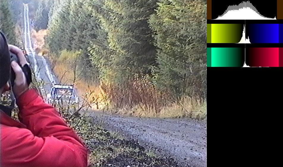

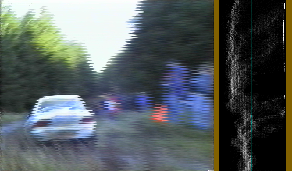

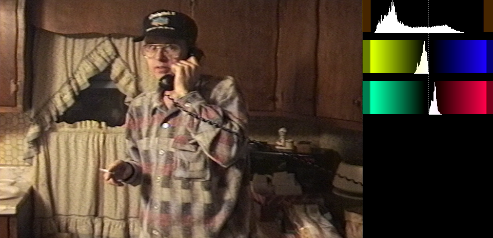

    You capture is excellent. I recognize the usage of a Hauppauge USB-Live 2 here (its histogram is unique).
    The video is 720x576, 4:2:2 YUV, interlaced, TFF.
    The levels are fine and well distributed across the whole duration:
    [Attachment 75029 - Click to enlarge]
    There is no need for a deep restoration, and a basic processing with deinterlacing/denoising/sharpening is adequate, with an intermediate upscale to 1440x1080 for YouTube upload. Intermediate because I prefer to sharpen after upscale in this case, to reduce artifacts.
    Before upscale the frame is rebuilt to 704x576 to be compliant with ITU-R BT.601-4 specification.
    I stayed with lossless HuffYUV, including the output, which can be read by YouTube.

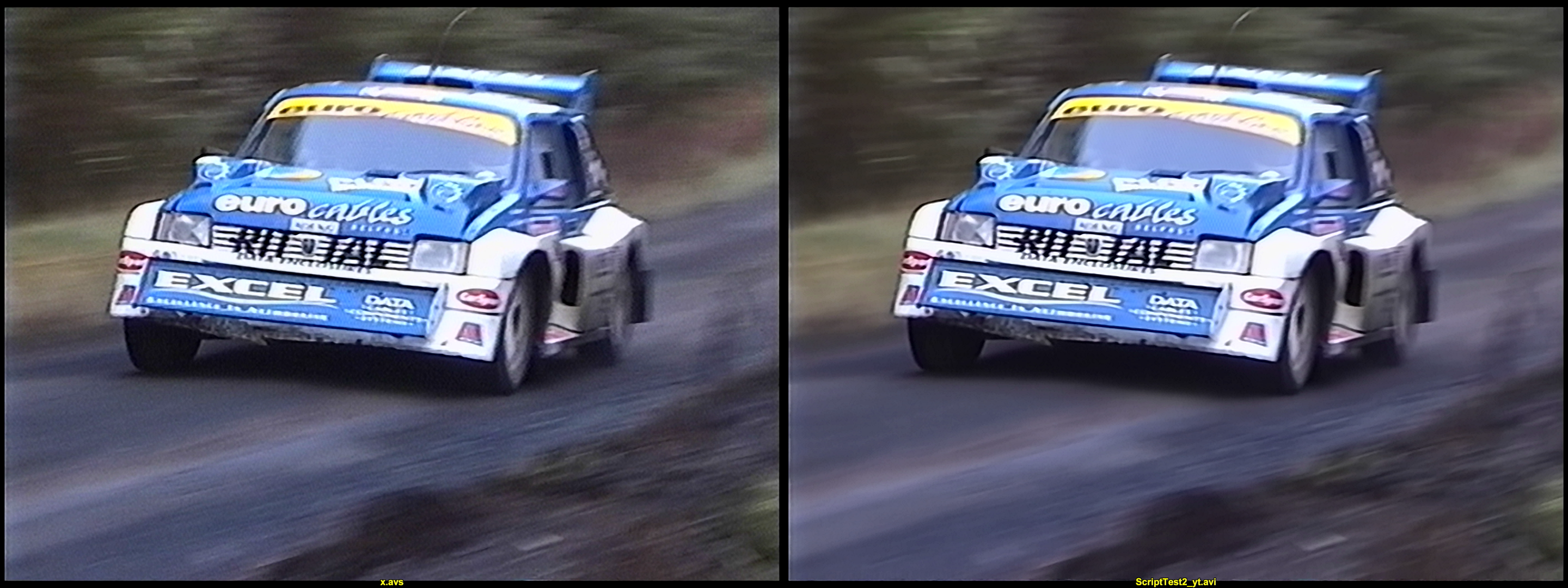

    Comparison between original and restored (not fair because the original is interlaced, but the quality of the outcome is evident):
    [Attachment 75034 - Click to enlarge]
    Youtube upload on my channel: https://youtu.be/PQmB-R_4G0k

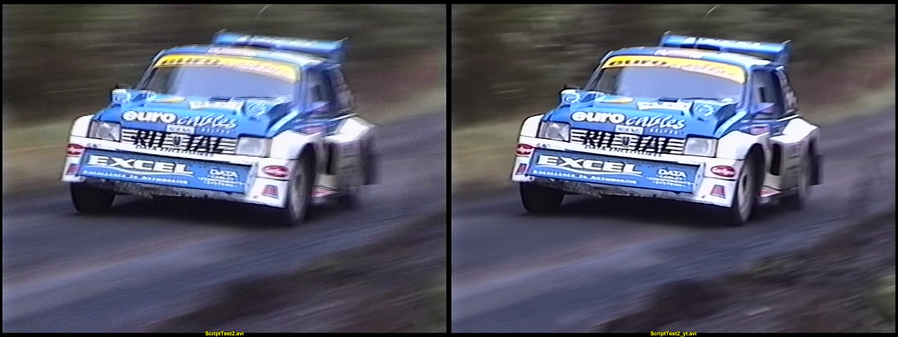

    For completeness, a comparison between your proposed script (which I modified a little bit to introduce proper ColorSpace conversion and different upscale) and the previous script.
    Small but evident differences, essentially because the denoise filtering I added.
    Comparison side by side:
    [Attachment 75035 - Click to enlarge]
    Comparison with slider: https://imgsli.com/MjIyMDAy

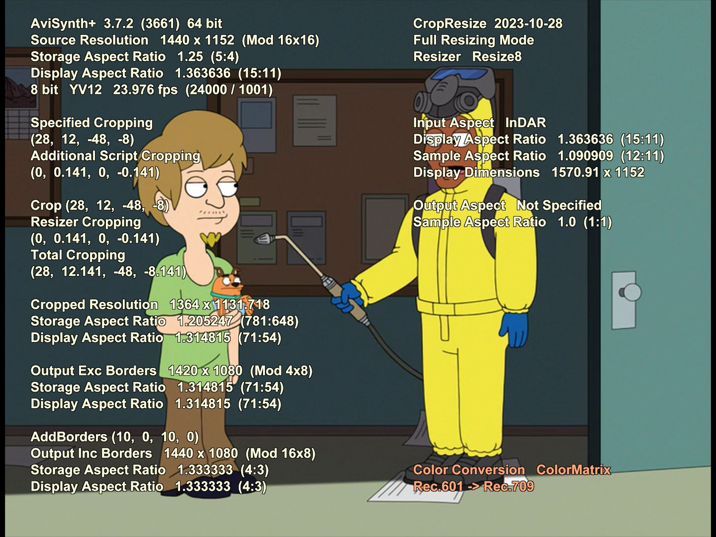

  9. Info=true will always show you exactly what the script is doing, so if you happen to find any inaccuracies please let me know, but given the idea of the function is to resize without any aspect error, I'm hoping that'll never happen.
    By the way, if you want to crop and replace any existing borders before upscaling, without the function resizing, you can use the CleanBorders argument. It'll crop the borders away according to the cropping you specify, then automatically add new borders for the original dimensions while centering the picture. To make it easier you can specify zero for the width and height. If you enable a cropping preview you can adjust the cropping without CropResize actually cropping anything, so you can get the cropping right before removing the CPreview argument.
    CropResize(0,0, 14,6,-24,-4, InDAR=15.0/11.0, CleanBorders=true, CPreview=1)
    CropResize now updates the sample aspect ratio in frame properties for newer versions of Avisynth+ (and will use it as the InSAR by default), although the SAR normally doesn't change when resizing is disabled (CleanBorders disables resizing). When specifying an InDAR/InSAR, CropResize will use it instead of any SAR in frame properties and it'll update frame properties accordingly, so when resizing is disabled, specifying an InDAR or InSAR is also an easy way to change the SAR in frame properties if need be.

  18. A quick comment only: You have some crushed/clipped brights (especially the Blue component). You can't do much in post processing with clipped signals.
    I would suggest to lower the darks a few notches and try to sharpen the chroma.
    You can't sharpen the motion blur though and you will probably have to live with the limited resolution of VHS, I think.

  21. Originally Posted by Traderbam View Post
    Thanks, so the best way is a recapture with adjusted procamp settings on my Hauppauge card?
    Maybe its exposed like this on the tape? Or the signal got clipped before it entered the USB Live-2? (The USB-live2 does not clip at Y=235)
    In these cases fiddling with the digital proc amp of the USB-live2 does not really help. But you can try.
    Anyway, the capture is not awfully bad. No need to 'overprocess' it.
    Maybe someone else has a better proposal ....

    That capture is not that bad, the overall quality depends on the tape content.
    I do not see major whites clipping, worst case is frame around 755 (the sky in the background), but because the levels are inside the card capturable range, I suspect it is like that on tape.
    [Attachment 76265 - Click to enlarge]
    [Attachment 76266 - Click to enlarge]
    Apart color and chroma correction, a basic processing like in post #8 should produce a pretty output. Try yourself!

  26. I concentrated mostly on sharpening and smoothing edges. More work is needed but for what it's worth...

    Nov 2025

    Utilizing the first script provided, the source footage is interlaced and TFF field order, and that should be the case for the vast majority of content I transfer going forward, but of course I'll always verify.
    Utilizing the second script provided, the histogram function does look useful, could you help explain what I should be watching for or adjusting? I know about setting the brightness and contrast levels in VirtualDub2 when capturing the footage to fit between the low and high regions, though for this particular sample clip I might have forgotten to do that, I can always get another if needbe.
    [Attachment 90049 - Click to enlarge]
    This particular sample clip is the one I've been experimenting with due to the complexity of the footage and its importance, stripped of audio for sharing here. I figured with all the darkness and noise, this would be a good case to learn from, of course not all the footage I have will be like this, but it would be good to know how to handle it.
