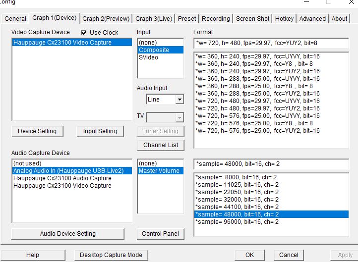

    I am working with NTCS VHS captures from Lagarith in AmarecTV, to a lossless avi 720x480 yuv422p. Running through a TBC or not made no difference.

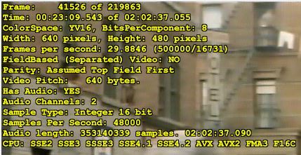

    Thank you for the Info() suggestion.
    If I just read the source in the script, it's interesting. If I read it using FFMPEGSource2, its saying the FPS is 29.8846 , but if i read it using AviSource, it says the FPS is 29.9700
    When using FFMPEGSource2, i can force it to 29.97 with AssumeFPS(29.97). While if i do this, the sync is still off in AvsPmod, I can try running it fully through maybe.
    I wonder if this is a FFMPEG problem as I saw someone else with a similar issue. AviSource runs a lot slower, but maybe this is what I have to do for these particular videos (I have convereted dozens of other videos without this sync problem).
    Yes, super fast system NVM.e drive, new cpu. Regardless, the problem does continue on if I encode it into a mp4.

  9. AVI doesn't support variable frame rate, as far as I know, so it might contain "null frames" due to dropped frames while the video was being captured, which I think would be skipped by default and the output would be the average frame rate, hence it being slightly lower then expected.
    If you decode the video this way, hopefully it will fix the problem. Any null frames will be replaced with a duplicate frame.
    If you use Info() as suggested and compare the output with and without FPSNum/Den and the frame rate and total number of frames changes, then with FPSNum/Den the A/V sync should be fine.
    FFMPEGSource("video.avi", FPSNum=30000, FPSDen=1001)
    If that is the problem AssumeFPS probably won't fix it, as that'll move every frame to a new position relative to the video, whereas frame rate conversion while decoding will leave them where they should be and fill in the gaps.
    I'd also consider remuxing the AVI as an MKV with MKVToolNix and using the MKV as the source file instead.
    AVISource should fill in the missing frames by default, as far as I know, so if it appears to be outputting the correct frame rate I'm not sure why the A/V sync isn't okay, unless it's because you're navigating back and forth in AvsPmod and AVISource isn't being very frame accurate.

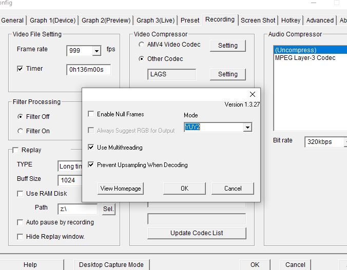

  10. Does your video use lagarith with null frames option enabled ? Not sure of the current situation, but only AVISource with the official lagarith decoder used to work correctly with null frames . Libavcodec (in ffmpeg, libav and their derivatives) did not support lagarith null frames. Lagarith null frames help with compression in that pure duplicates, triplicates etc... are not encoded and stored to save space - they are only displayed at decompression time. Not sure if ffms2 with fpsden,fpsnum or any other CFR framerate fix will insert at the correct times. Lagarith official should
    But earlier you reported AVISource and FFMS2 had the same problem... so there might be something else going on

    Null frames are not enabled.

    Aug 2023
    USA
    [Attachment 74911 - Click to enlarge]
    Here's my other setting in Amarec

    The null frames option when configuring the encoder may only mean they're deliberately used in place of duplicates when the video is compressed. I'm not sure, but if a frame is dropped while the video is being captured I'd assume a null frame must still be used to ensure the A/V sync is maintained, as AVIs don't support variable frame rate (as far as I know).

  28. Member
    Aug 2023
    USA
    I wasn't going to point that out, but yeah, I believe i'm capturing in YUV, and it's RGB after deinterlacing.
