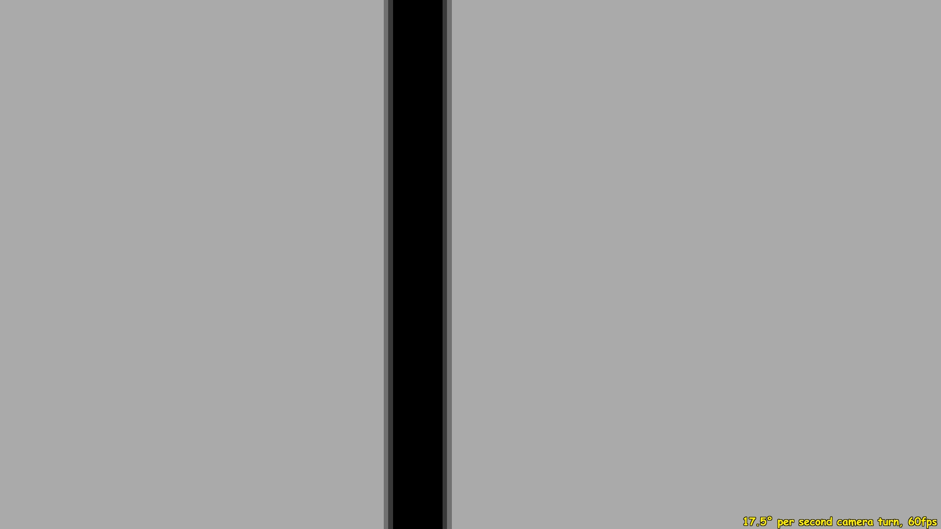

I'm not sure the way you want to do it would produce a natural looking result. Blending each frame evenly with the previous and next one gives you this (created with Avisynth's TemporalSoften). After dropping every second frame they still look the same, only there's half as many.
[Attachment 74618 - Click to enlarge]

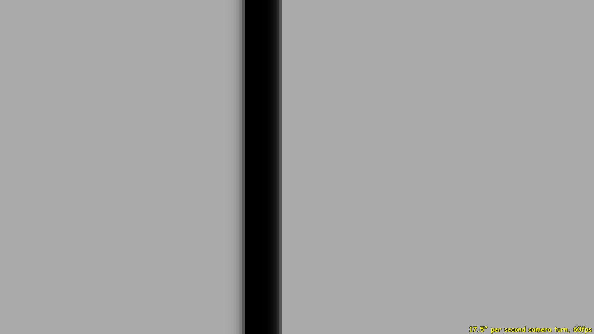

I couldn't get VirtualDub2's smoother or temporal smoother filters to work for your source. I suspect they don't blend when the luma difference between pixels exceeds a certain amount.
There's an interpolate filter though. I assume it only blends each frame with the previous one when halving the frame rate, but you can set a target frame rate with it.
