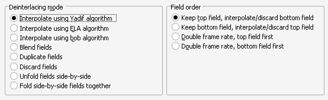

Found a better source. Anyone know what's the best method to utilize for de-interlacing this footage? Could Virtual Dub do the job? I'm using that program, and I see the following options, but not sure which ones to select.
https://drive.google.com/file/d/1ckN36bae3-blOY2m7NPNLmYJ7aCSHcy4/view?usp=share_link.

On the right side of your Virtualdub screenshot, if you only keep one field you'll end up with 29.97fps. If you keep both you'll end up with 59.94fps.

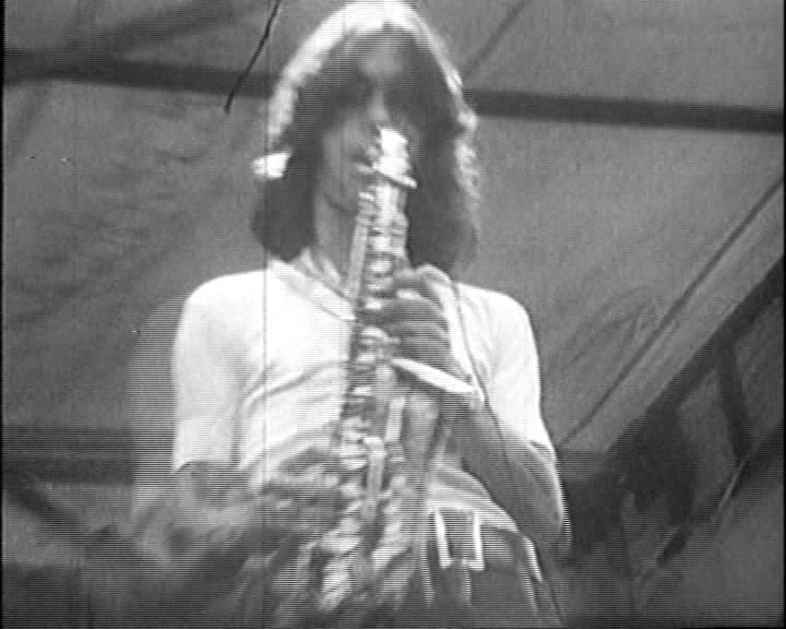

The first pic shows the full frame before de-interlacing.
[Attachment 75498 - Click to enlarge]

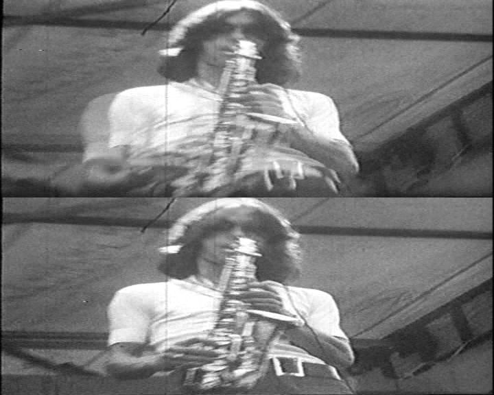

The second pic shows the same frame with the fields separated. After they're both converted to full size frames by deinterlacing to 59.94fps, SRestore should pick out the bottom one to keep.

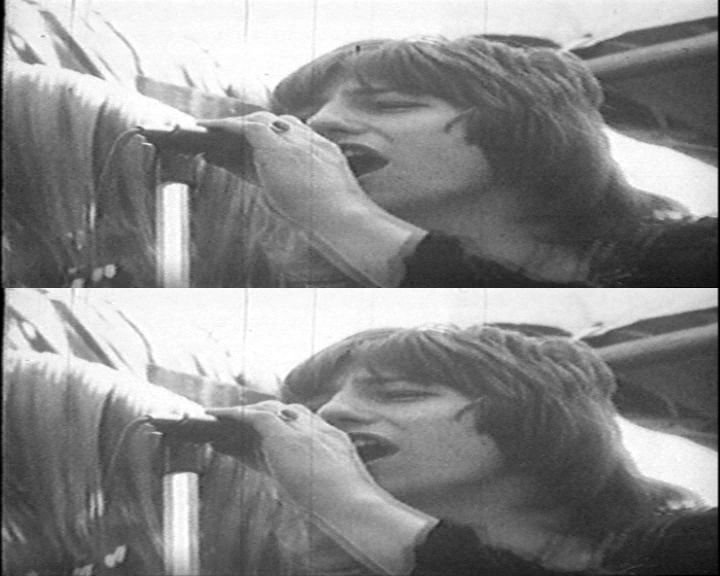

The third pic shows one of the problems with the sample. Near where there's a field repeated for some reason, there's also a few places where both fields have blending, so between that sort of thing and the blending pattern changing, SRestore won't be able to remove all of the blending. Whether it removes enough to make a crash course in learning Avisynth worthwhile, is up to you.
