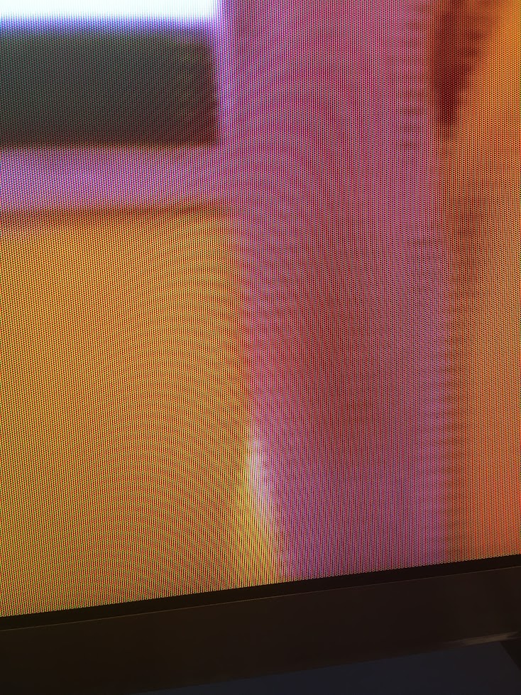

  1. Why NTSC video on PAL TV have interlace artifacts? Even original is already progressieve?
    [Attachment 71718 - Click to enlarge]

    I really do not know what I am seeing. But IMHO these are not interlace artifacts.
    It may help if you stated:
    1. The make/model of tv
    2. The player used and if it has a NTSC on PAL playback setting (which themselves are anolg points and not relevant in the digital world)
    And a photo taken with (assumed) a mobile (which might also introduce its own timing issues) hardly helps.
    An unaltered sample of the video may also assist.

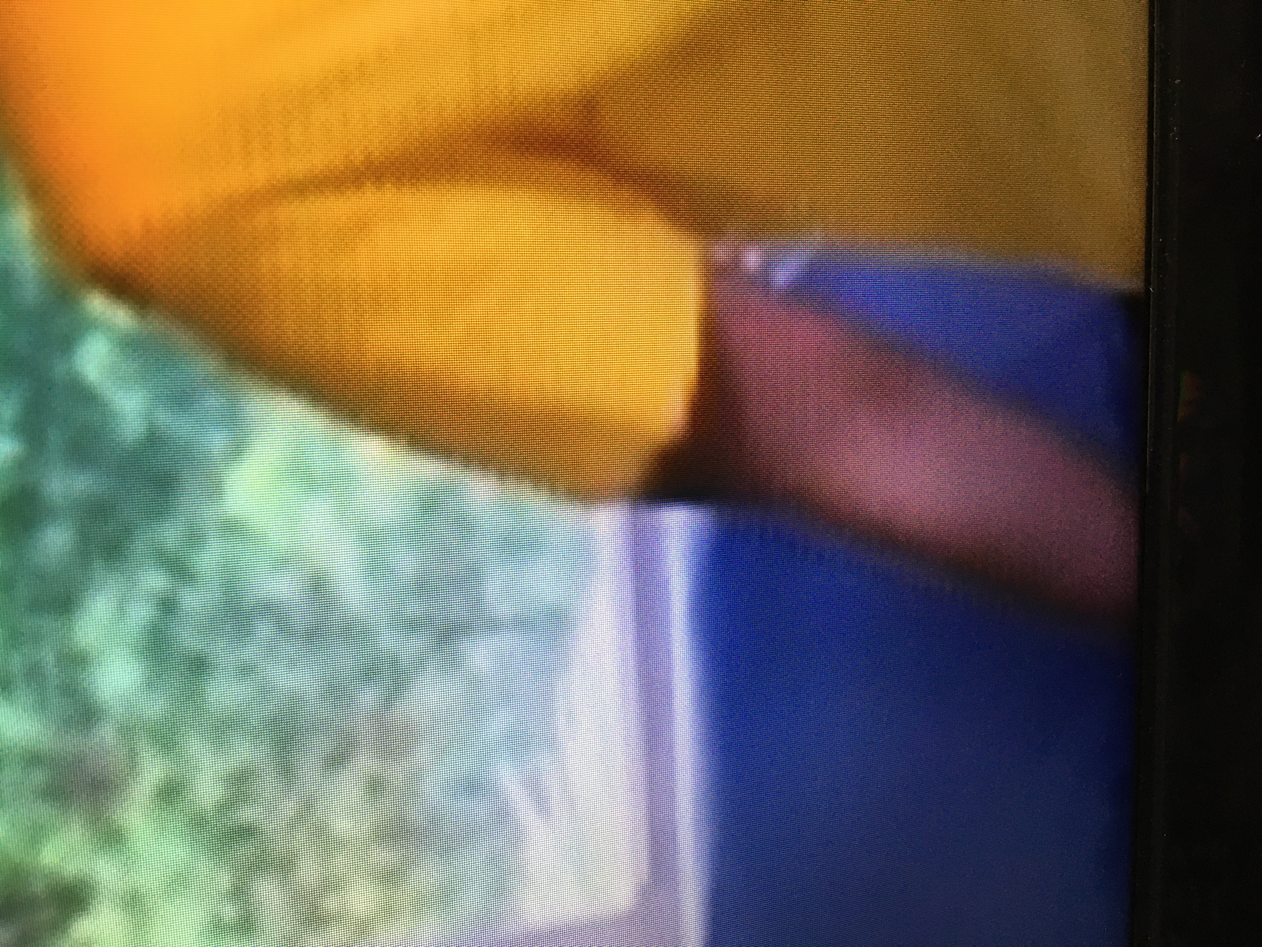

    [Attachment 71720 - Click to enlarge]

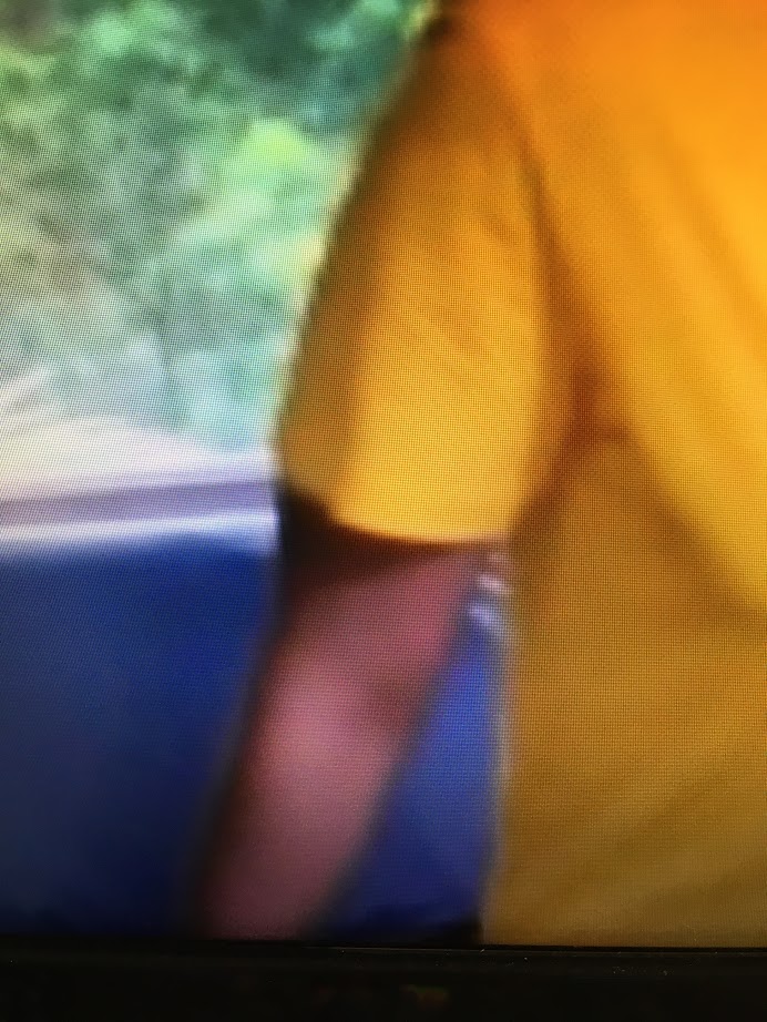

    [Attachment 71721 - Click to enlarge]

    The artifact showed in your pictures (if indeed that's what you are referring to) is called "moiré pattern" originally a French word, It is an artifact that occurs when the source video resolution and the screen resolution are too close but don't match up, It has nothing to do with the color system and it happens at any resolution as long as the condition described above is met, The best way to avoid it is to stay back from the screen and not take closeups like the ones above, When you look for problems you'll find them.
