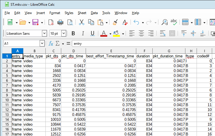

  23. I think you should start by checking exactly why your video is 59.6 fps. You can get the VFR timestamps with ffprobe. Here's an example drag-and-drop batch file:
    echo entry,media_type,pkt_dts,pkt_dts_time,best_effort_Timestamp_time,duration,pkt_duration_time,ftype,coded# > "%~nx1.csv"
    "g:\program files\ffmpeg64\bin\ffprobe.exe" -v 32 -stats -y -hide_banner -i %1 -select_streams v -print_format csv -of csv -show_entries "frame=media_type,coded_picture_number,pkt_dts,pkt_dts_time,pkt_duration,pkt_duration_time,best_effort_timestamp_time,pict_type" >> "%~nx1.csv"
    [Attachment 69847 - Click to enlarge]
    That's from a CFR video (I don't have a VFR video handy). The output CSV file was opened in LibreOffice. Once you have identified the nature of the problem(s) you can deal with them accordingly.
