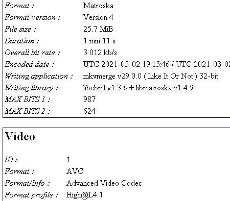

I used foobar2000 to add a tag field named "MAX BITS 1" to an MKV and Mp3tag to add one called "MAX BITS 2". They could each read the tags the other wrote (they could be found under "extended tags" in Mp3tag) and appeared in MediaInfo like so....
[Attachment 69211 - Click to enlarge]
As I don't know much about MKV tagging, I extracted the tags from the MKV with gMKVExtractGUI to see where the two fields ended up.
Code:<?xml version="1.0"?> <!-- <!DOCTYPE Tags SYSTEM "matroskatags.dtd"> --> <Tags> <Tag> <Targets> <TargetTypeValue>30</TargetTypeValue> </Targets> <Simple> <Name>CREATION_TIME</Name> <String>2021-03-02T19:15:46.000000Z</String> <TagLanguage>und</TagLanguage> <DefaultLanguage>1</DefaultLanguage> </Simple> <Simple> <Name>ENCODER</Name> <String>libebml v1.3.6 + libmatroska v1.4.9</String> <TagLanguage>und</TagLanguage> <DefaultLanguage>1</DefaultLanguage> </Simple> <Simple> <Name>MAX BITS 1</Name> <String>987</String> <TagLanguage>und</TagLanguage> <DefaultLanguage>1</DefaultLanguage> </Simple> <Simple> <Name>MAX BITS 2</Name> <String>624</String> <TagLanguage>und</TagLanguage> <DefaultLanguage>1</DefaultLanguage> </Simple> </Tag> </Tags>
