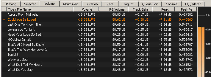

  14. Are you referring to the volume specified in the ReplayGain tags?
    As far as volume goes there isn't one specified directly. There's a track or album gain tag, and both are relative to the ReplayGain target volume of 89dB, which is fixed in stone. You can adjust to a different volume, but the tags are always relative to 89dB.
    89dB isn't a volume in normal human-speak though, it's a sound pressure level based on a SMPTE standard for movie theatres. ReplayGain's target volume of 89dB translates to a volume of -18dB on an output meter where 0dB is maximum.
    The "track gain" or "album gain" tags simply say something like -3.7dB, which would mean the volume of the audio is 3.7dB louder than the target volume, and a player should reduce the volume by 3.7dB. It relies on the player actually supporting the tags though.
    The only other ReplayGain info is the peak volume, which is relative to 0dB. So a peak of -2dB means the absolute loudest part of the audio is 2dB below maximum, but it has nothing to do with how loud the audio will sound. Normalising to 100% in Audacity only means the over-all volume is adjusted so the loudest part is at maximum (0dB on an output meter). Normalising to 89dB (-18dB) in MP3Gain (as opposed to peak normalising, which it can do) means the volume should always sound the same regardless of the peak level.
    Edit: Thinking about it, the ReplayGain track and album gains are specified in dB, but the peak volume is specified as a percentage, where 1.0 = 100% and 0.8764 = 87.64% etc. I'd forgotten about that as even MP3Gain translates it to dB. So the tag itself might show a peak volume of 0.702890, which MP3Gain would display as a "Max Noclip Gain" of 3dB, whereas for foobar2000 in the screenshot below, the same peak volume would be shown as -3.06dB (slightly less rounding).

    It's a fairly old version now, but try the version of foobar2000 below. It'll convert just about any audio format to any format, and you can scan the files for volume using ReplayGain and adjust the volume using that information while you convert. It's also set-up to display the volume in human-speak instead of using the ReplayGain "89dB" way of describing it. For MP3 and AAC it can adjust the volume losslessly as MP3Gain does, but it'll also do it while the audio's inside another container (such as MP4 or MKV) without having to extract it first. I should upload a newer version at some stage, but this one works and it'll get you started.
    https://forum.videohelp.com/threads/396860-foobar2000-portable-(for-audio-encoding)
    The screenshots in the link above don't show the contents of the volume tab, but when you load a bunch of files into a playlist, it displays the ReplayGain track gain info something like this (I've probably fiddled with it a bit since I uploaded that version). LUFS means "loudness units to full scale", which is another story, but LUFS and dB are interchangeable. I've added another column here to show the volume in the silly way ReplayGain defines it, so you can see how it compares to human-speak volume.
    Edit: I've also added a second Peak column displaying the peak as a percentage, as it's stored in the ReplayGain tag.
    [Attachment 69228 - Click to enlarge]
    For TV programs, which are often more dynamic than the average pop-song, ReplayGain's target volume is a bit too loud. It'll likely result in peaks being clipped or above maximum. The official target volume for that sort of thing is -22dB/LUFS or -23dB/LUFS, depending where you live, but if you're converting the audio of TV shows they'd hopefully be at the correct volume to begin with... unless you downmix multichannel audio to stereo. There's presets for downmixing, but you'd need to downmix while converting to a lossless format first, scan and save the ReplayGain volume, then adjust the volume while converting to another format. There's also presets for compressing with the dynamic audio normaliser which work quite well, but once again it'd become a two step process.
