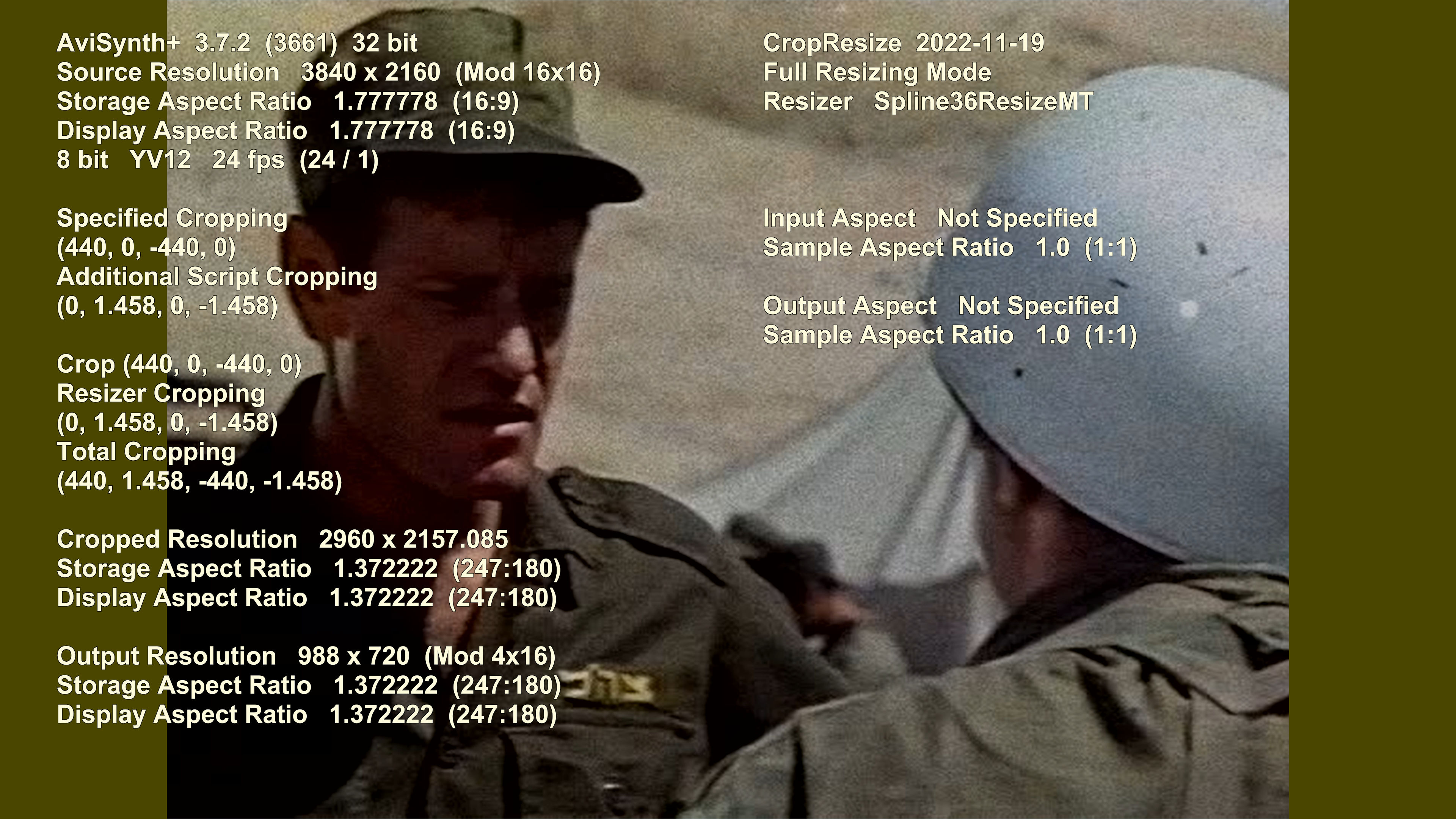

  23. spiritgumm,
    maybe have a play with CropResize (assuming you use Avisynth). By default it outputs a mod4 width and/or height when it's making the decisions, but you can change that. Enabling a cropping preview and Info=true will show you exactly what it's going to do.
    I upscaled an image and added borders to use as the starting point, based on your description. You probably won't be able to resize to exactly 1.37 dimensions, so the script will do a bit of extra cropping if need be to prevent aspect error. You can specify just the width or the height if you prefer and the script will take care the other.
    Source
    [Attachment 68746 - Click to enlarge]
    Cropping and resizing based on an output height of 720, as an example.
    Well, it's not actually cropped or resized in the screenshot because the preview is enabled. The script will crop an extra 1.458 pixels from the top and bottom to output 988x720, which results in an aspect ratio of 1.3722.
    CropResize(0,720, 440,0,-440,0, CPreview=2, Info=true)

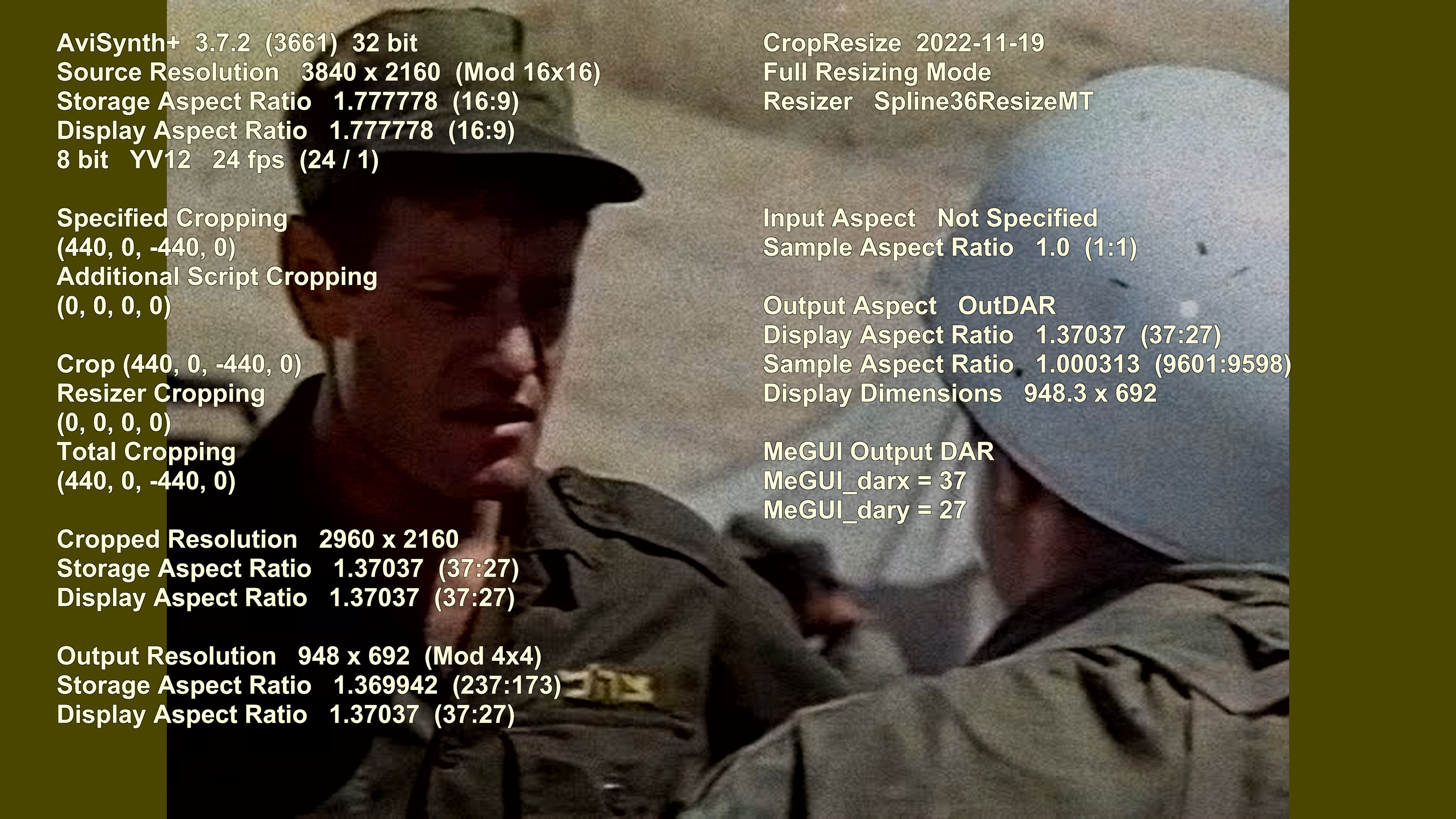

    Or you can try different heights. A height of 692 will get you much closer to the original DAR and the script only has to crop half a pixel more each side to prevent aspect error. The output will be 948x692 with a DAR of 1.3699.
    CropResize(0,692, 440,0,-440,0, CPreview=2, Info=true)
    [Attachment 68748 - Click to enlarge]
    As it's so close you can always specify the original DAR for the output. Info=true will tell you the SAR to use for encoding (9601:9598 in this case). If a player pays attention to that the DAR will be correct, but if it doesn't the aspect error will be too small to matter. The correct display dimensions would be 948.3 x 692, but if a player displays it as 948 x 692 instead, you won't notice.
    CropResize(948,692, 440,0,-440,0, OutDAR=2960.0/2160.0, CPreview=2, Info=true)
    [Attachment 68749 - Click to enlarge]
