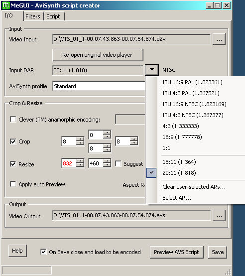

  7. Originally Posted by GreenRobert View Post
    Thank you for that helpful information! And now am aware of another potential landmine: Glitches at the junctions of VOBs
    I've re-encoded truckloads of DVDs and never experienced glitches. Vob files in a sequentially numbered set are supposed to be treated as though they're one large file, which is actually what they are, only split into sections.
    MKVToolNixGUI has a special mode for remuxing sets of vob files as single MKVs. Normally you'd use the "Append files" option to join files, but there's an "Add files as additional parts" option for vobs which treats them as one continuous file.
    Most encoding GUI's or the tools they use treat multi-part vob files as a single file and without requiring an IFO file to tell them anything. One of the most commonly used Avisynth tools for indexing and decoding vob files doesn't even open IFO files.
    You can try changing the DAR while remuxing the vobs as MKVs to see if your player will obey it, assuming it'll play MKVs, or MakeMKV is dedicated to remuxing DVDs and Blurays as MKVs. It might let you change the DAR too. I'm not sure.
    If you intend to do a bit of re-encoding and don't mind a bit of a learning curve though, give MeGUI a try. If the display aspect ratio is wrong it's easy enough to change it. MeGUI uses that DAR as the starting point for calculating resizing etc. Or you can disable resizing and just re-encode using the corrected DAR. I tend to resize so there's no aspect ratio to get wrong. The video dimensions are the DAR.
    [Attachment 67787 - Click to enlarge]
    Cropping away the crud, de-interlacing to 60fps and resizing to non-anamorphic dimensions. With the black cropped, the remaining picture probably has a DAR of 1.8 rather than 1.778. There's also a sample of the vob file remuxed as an MKV (no encoding) with the DAR changed to 16:9 if you want to test it.
