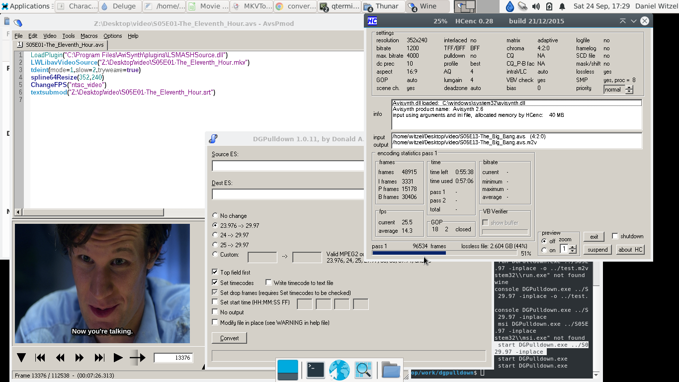

  9. Mr. Computer Geek dannyboy48888's Avatar
    May 2007
    Texas, USA
    Dgpulldown in Linux does work via wine (I use it in debian 11) on elementary streams. I'll post my script and sample desktop icon for drag and drop when I get off work
    if all else fails read the manual
  10. Mr. Computer Geek dannyboy48888's Avatar
    May 2007
    Texas, USA
    For this to work you need:
    a 32 bit wine enviorment
    a elementary (.m2v) stream
    a filename without spaces.
    from a terminal in the DGPulldown directory run:
    wine start DGPulldown.exe
    this will start the GUI and you can click options and save
    to run straight from the command line with options do this, I run inplace as I'm a rebel lol:
    wine start DGPulldown.exe ../S05E05-Flesh_And_Stone.avs.m2v -srcfps 23.976 -destfps 29.97 -inplace
    a window will pop up but *not* show progress, this is fine and it will close as soon as it's done.
    if you need to remove all pulldown (useful if you mess up or have a source you know is 100% pulldown) do:
    wine start DGPulldown.exe ../S05E05-Flesh_And_Stone.avs.m2v -srcfps 23.976 -destfps 23.976 -inplace
    **if you omit start for command line conversions or have spaces the program will error out.
    with ffmpeg it only can do hard coded pulldown as far as I'm aware of in MPEG-2 so I'll use this method if I use ffmpeg as the encoder.
    I use HCenc, AvsPmod, and ffmpeg for audio, and subtitle editor all under linux via wine. for authoring of dvd's I use dvdstyler that I built under debian as a latest package aint avialable. Ubuntu etc do have packages so this shouldnt be a problem.
    [Attachment 66969 - Click to enlarge]
    attached is a photo for proof.
