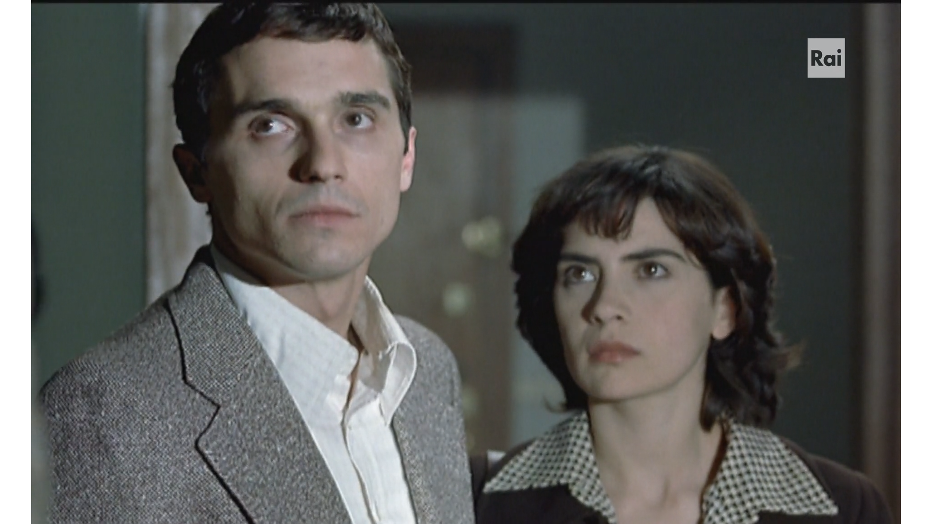

    Continuing on this road, I've taken two screenshots of the same frame. (this is only an example, not the definitive frame.)
    https://www.dropbox.com/sh/qpcoh9bbwtkd69j/AACCFiFZMHDY7Sf3M-4Rqkawa?dl=0
    Basically I've chosen this frame cause I can see light reflection in both characters eyes, that I want to use as reference points,
    but this can do with every else object.
    Subsequently I've made two almost identical selection with an image editor on each ss, the editor gives me the AR of the selections.
    https://www.dropbox.com/sh/pq5l61jpsayyqgd/AAD9zF2HaSaO9aWtW_dM54eQa?dl=0
    At this point I start calculations:
    - 2.096 / 1.892 = 1,1078 (rounded)
    - 1920 / 1,1078 = 1733 (rounded) = 1732 (rounded to the closest mod4 res)
    - that's it: 1732x1080 is the almost correct new resolution for the WEBDL.
    here's the ss resized to 1732x1080:
    https://www.dropbox.com/s/n2wpzck3sdgc103/bn%201080%201732%20x%201080.png?dl=0

    First, despite that there are black borders on the sides the DVD seems to have PAR 64∶45 as you said because there are black bars on top and bottom. So, the whole DVD screenshot seems to be true 16:9 to me. Therefore, I don't care about DVD PAR and can use square pixels from the screenshot.
    A rectangle between man's and woman's eyes:
    DVD: 430x168
    WEBDL: 850x298
    Calculate required horizontal distance between the eyes for WEBDL:
    430*298/168 = 763
    Calculate reduction factor:
    763/850 = 0.8976
    Calculate new width:
    1920*0.8976 = 1723.5
    My calculations gave me slightly narrower frame than yours. But visually comparing the two, it seems narrower than it should be, so I'd say that yours is about right.

    Like you originally stated, you have the dvd so you know the AR. It is not 1.85 as stated by IMDB. It is not 1.6:1 per your calculations. You are, again if the dvd cover is accurate, quite close since that is reported to be 1.66:1
    So I also took the 1080p version in to a photo editor and resized it to 1792*1080 (rounded to the nearest mod4). The logic in doing this was to allow for the extra detail top and bottom in this. I then reframed the resize back to 1920*1080. Now you see the resultant border most of which vanishes when the dvd frame is zoomed in removing that additional detail on the web version.
    So does this look more representative to you now we are using the actual AR.

    Hi, sorry for the delay, all is becoming quite hard for my poor skills.
    I've tried on some different frames and I have calculated two possible choices:
    (1728,1080) or (1732,1080)
    probably 1732 is better but I'm not sure.
    No way to find any spheres, here's some test frames:
    https://www.dropbox.com/sh/nt2qa3ndkz3knj8/AAB1c0ud3jz-SPkhtwtaK3mUa?dl=0

  23. If that thing is supposed to be a circle the frame needs to be resized to approximatily 976x576:
    [Attachment 64912 - Click to enlarge]
  24. Member DB83's Avatar
    Jul 2007
    ^^Hmmn.
    Never considered that one. But...
    That AR is 1.69:1 which is closer to the suggested AR of the film (1.66:1) than the 1.60:1 achieved by the OP

  28. I didn't rely on my eyes. I opened the frame in an image editor and use the tools to count the pixels across the width and height of the circle, resized the full frame accordingly, then checked the circle in the resized image. A 270x270 crop of the downscaled frame:
    [Attachment 64914 - Click to enlarge]
    The OP did a good job of adjusting the webdl to the dvd. But his assumption that the DVD has the exact right aspect ratio is almost certainly wrong. Of course, he's free to do whatever he likes.
