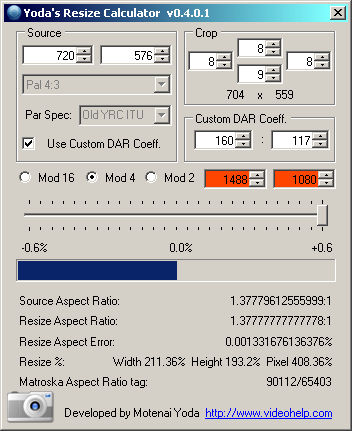

  21. Personally, I never add borders (although when combining video with different DARs sometimes it can't be avoided), but the wider the DAR, the more the video fills a 16:9 display. Adding back top and bottom borders to make it 4:3 again does the opposite of that.
    If there's a total of 14 pixels that need cropping from the height and you increase it by 3.
    Crop(8,8,-8,-8)
    Spline36Resize(1488,1080, 0,0,0,-1)
    It's like being given an extra 24 pixels each side for free, and if it helps you feel any better about it not being exactly 4:3, it's only a couple of pixels off the Academy ratio of 1.375.
    Anyway, as how much you actually need to crop is still a secret, you might want to have a play with Yoda's Resize Calculator.
    In order to use the 702 x 576 = 4:3 DAR, you need to select PAL 4:3 as the input, check the custom DAR option and use 160:117 as the custom DAR.
    160 / 117 = 1.367521. It's an exact representation of the DAR I calculated in my last post. To use 15:11 as the source DAR, you can select mpeg4 from the drop down PAR list.
    The output dimensions turn red when you upscale, but it's just to let you know. Nothing to worry about. And using Mod4 for the resizing dimensions it fine.
    And of course you can crop less from the sides if there's not much to crop there, rather than crop more from the height.
    [Attachment 63166 - Click to enlarge]
